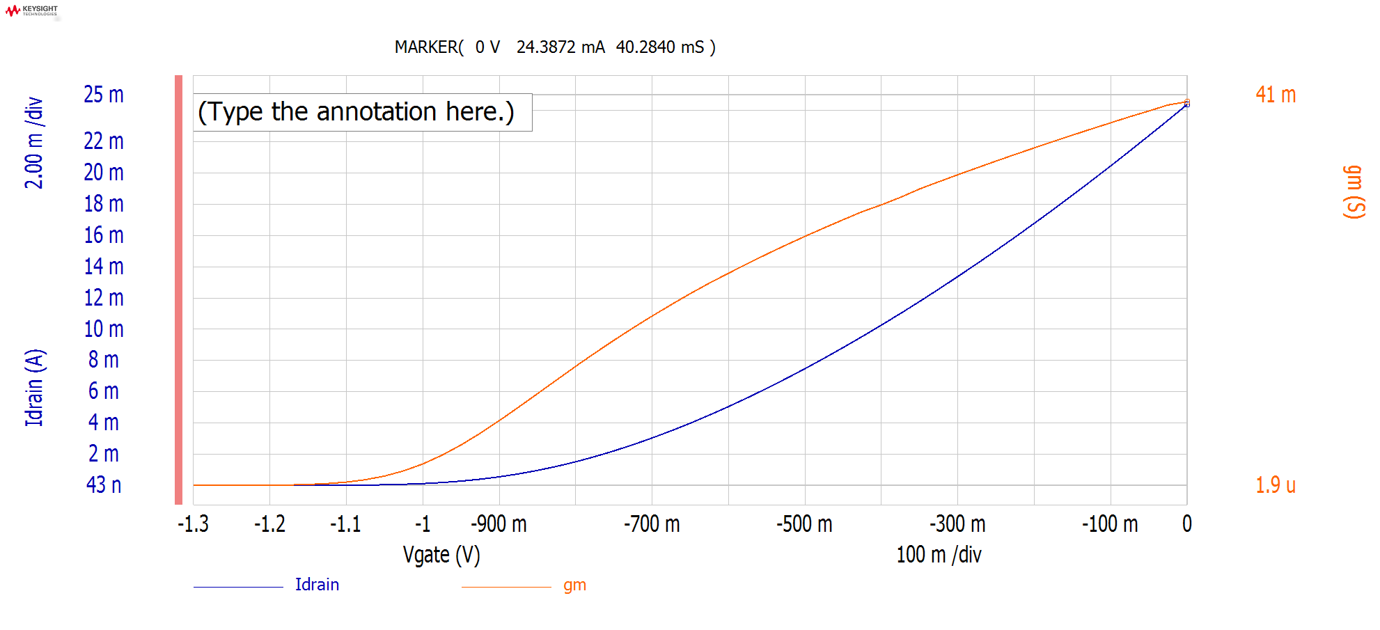

These Ebay 50 PCS 2SK117-BL K117-BL N CHANNEL JUNCTIONS TYPE TO-92 | eBay
2SK117's appear to be rebranded.
They are way out of specification to be real.
IDSS measures 24.3872mA, transcondance measures 40.28mS.
Thanks DT
