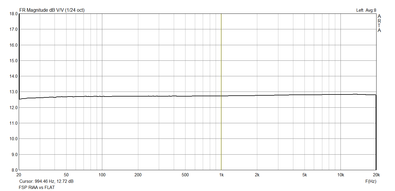

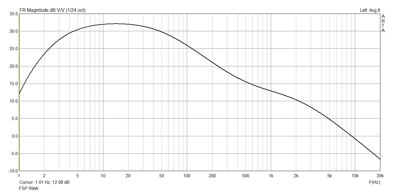

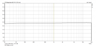

2. In my view solder the 150p for a start. From measurements it takes enough C2Y value to be ruler flat. Up to 15.4nF C2+C2Y. But compatibility with records, cartridge, turntable, and speakers tone is something to be subjectively judged. Enough belt driven TTs run bit slow for instance. Because this circuit is mainly doing second order THD, a slight upwards tilt seems subjectively compatible with vinyl rigs in various installations when listening over two meters away with dome tweeter speakers in non acoustically treated rooms. Talking just small fractions of a dB tailoring.
I attach the RIAA transfer curve and vs flat net outcome response plots of 15.2nF confirmed total. The anti-RiAA filtering curve to produce a net response is ideal math that I put in the software. Introduces no hardware anti-Riaa errors. Vinyl record cuts are not to be expected with an ideal pre-emphasis curve of course. They vary. Phono output load was the audio card's instruments input, so it was high. Circa 1 Mega Ohm. C4's listed value is chosen to create more subsonic attenuation on usual line preamp up to 50k loading.

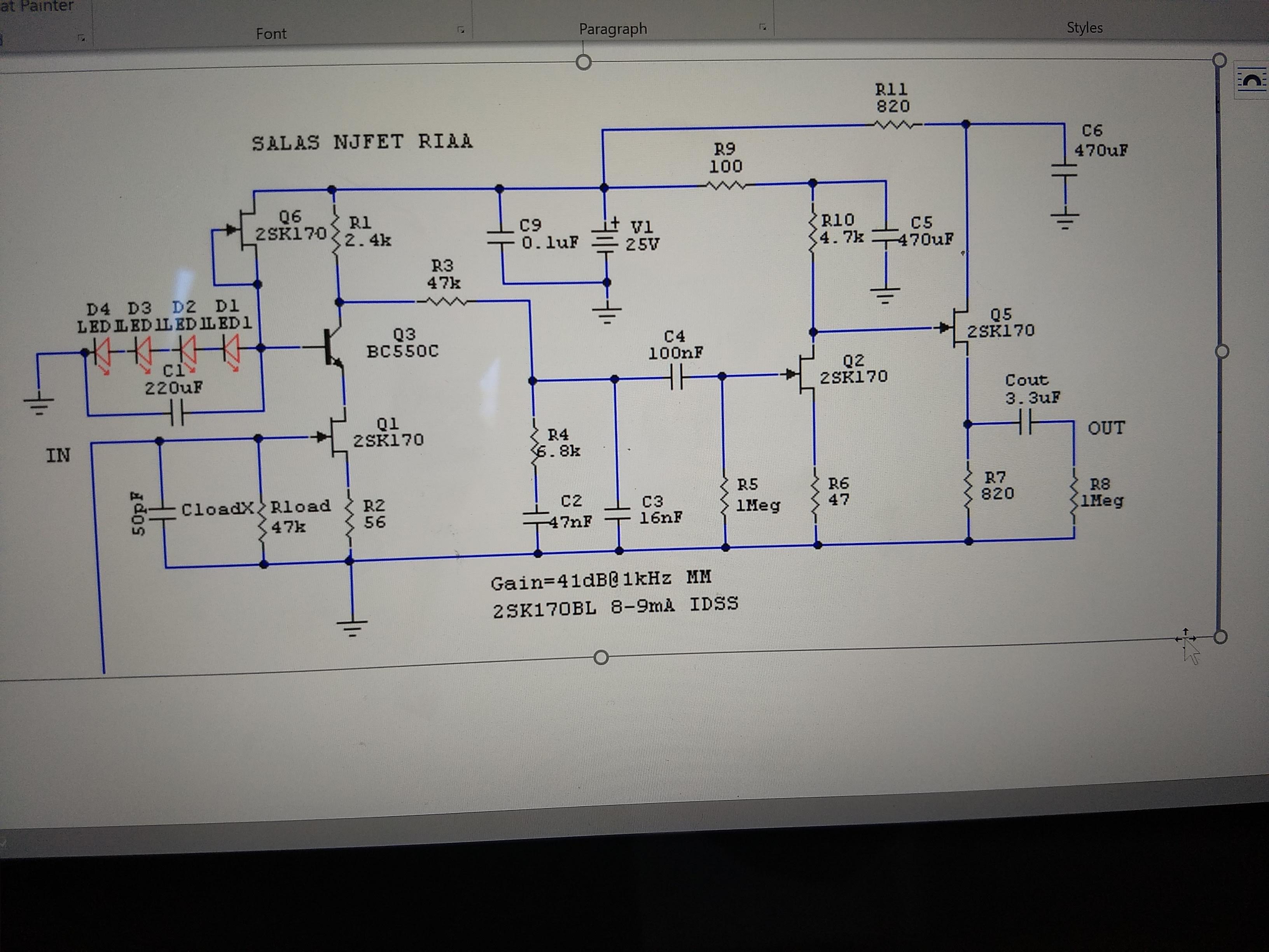

Hi I'd like to build this circuit and I'm going to build it myself on a perfboard. This thread is awesome but has way too many choices.
My system is a Klisch Fotres with DIY Al Klapeberg crossovers.
An Aleph J amp, stock build_no mods yet.
Currently I'm tweaking a Korg B1 nutube preamp, but also just recieved a mesmerize board and plan to build Zen Mod's Iron Pumpkin early fall.
Cartrige is a Nagaoka MP150 MM 4.5mV out.
I have 2 nice sets of 2sk170BL matced octets one at 9.9mA IDSS and one at 8.0/8.1mA IDSS plus enough spares for the mesmerize.
I'd like to be able to use all of the preamps with little or minor tweaking on the phono stage and plan to start phono off with battery power then add shunts later.
So what circuit should I build? maybe a 36db version? And if so which one there look to be a few.
Jeffrey
Ok, I couldn't find a 40 dB schematic, but I found this 41 dB schematic that looks like it'd be fun to build and the IDSS looks in the right range for my JFETs. Is this one ok?
This schematic does not look right.
at a first glance,
The gain device(s) in Q1 place should not be 2sk170.
The last stage should be a nice 2sk170 buffer
For the most updated version, see the FSP pdf guide in thread post #1 and in the pdf, gain section adjust the source and drain resistor for the desired gain.
Jim and Escucalin, Yes I would really love to build the circuit from the FSP pdf, however, the 2sk369BL's seem to be near near impossible to sorce from anyone reputable. Is there a suitable substitute? I agree it has a better buffer in the last stage.
Rush thanks, the schematic I posted is in the wiki you linked.
All those 2SK170BL telescopic cascode earlier circuits are subjectively good, you will not regret building such, but best is the FSP folded cascode variation. For IDSS selected genuine 2SK369BLs ask Tea-Bag if he is willing to help. For MM configuration you only need one per channel.
Make short signal paths and best build against a copper plane for all ground returns. Works well for noiseless prototypes. Veroboard is usually adequate for MM but why not try more promising ways since you you got sensitive speakers. Google dead bug style (ugly) and Manhattan style (presentable) circuits construction.
