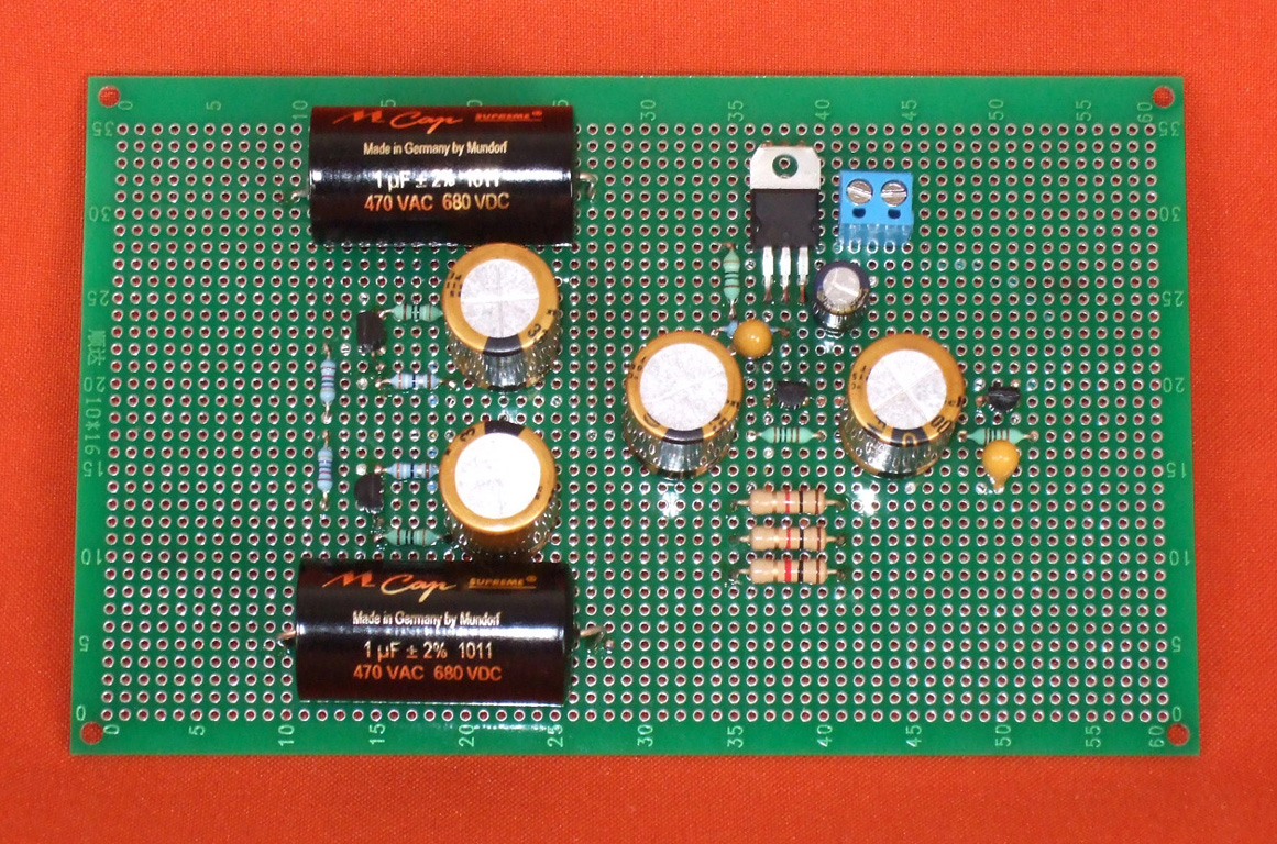

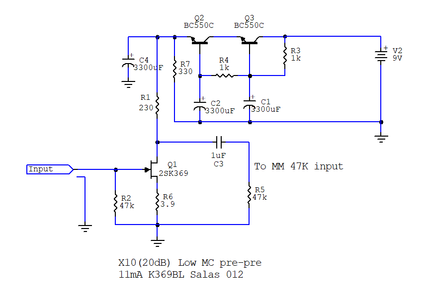

I have been experimenting with this step-up...which has turned out well. Mine is built on perfboard with PRP resistors, Nichicon KZ and a Mundorf Supreme output cap. So far, I prefer it to transformers, although I haven't tried big $$$ transformers.
This circuit is very sensitive to power supply quality. I have tried LM317, LM317 with adjustment cap and a variety of batteries.
LM317 with an external transformer (12VAC wall wart) is not so good. It's OK, but noise is an issue and it lacks some sparkle. Probably still better sounding than my mic transformers, but noisier.
LM317 with adjustment cap is better. Got some sparkle back. Still noisy. Not terrible, but not as good as batteries.
Set of 6 AA batteries sounds good. Less noise, more elastic sounding. Carbon batteries not as good as alkaline.
2 sets of 6 AA batteries (dual mono) sounds really excellent. Especially if the batteries are alkaline. Really liquid sounding, least amount of noise.
2 sets of 6AA Batteries (dual mono) followed by a pair of 33,000uf caps (like Hiraga would use)....this is really nice. Best of everything. Power, control, blackness and very liquid. Sounds very rich and free.
Hiraga must have known what he was doing. And this is a very nice circuit if you are willing to experiment.

Yes. And cap multiplier after batteries as well. I did not try 7809 because I don't have any.
Linear PSU was 12V AC wall wart, MUR160, 10K UF Nichicon KG, LM317. Single mono.

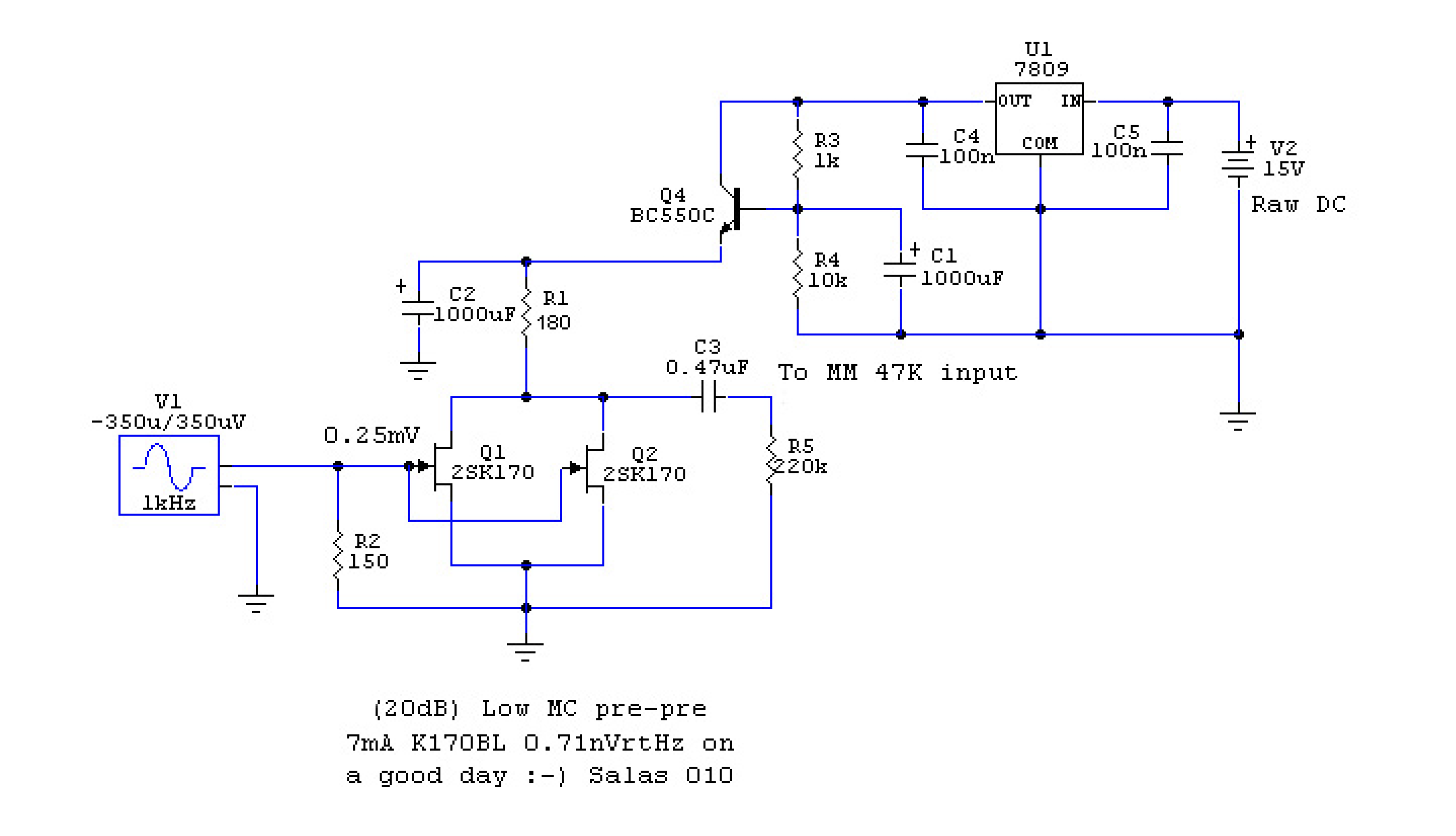

Yes, I know the practical difficulties you are facing. After we gather enough experience and we are careful, an MC pre-pre can be executed well for low self noise floor with almost absent rail noise influence and tiny harmonic spikes though. Even when conventionally mains powered.

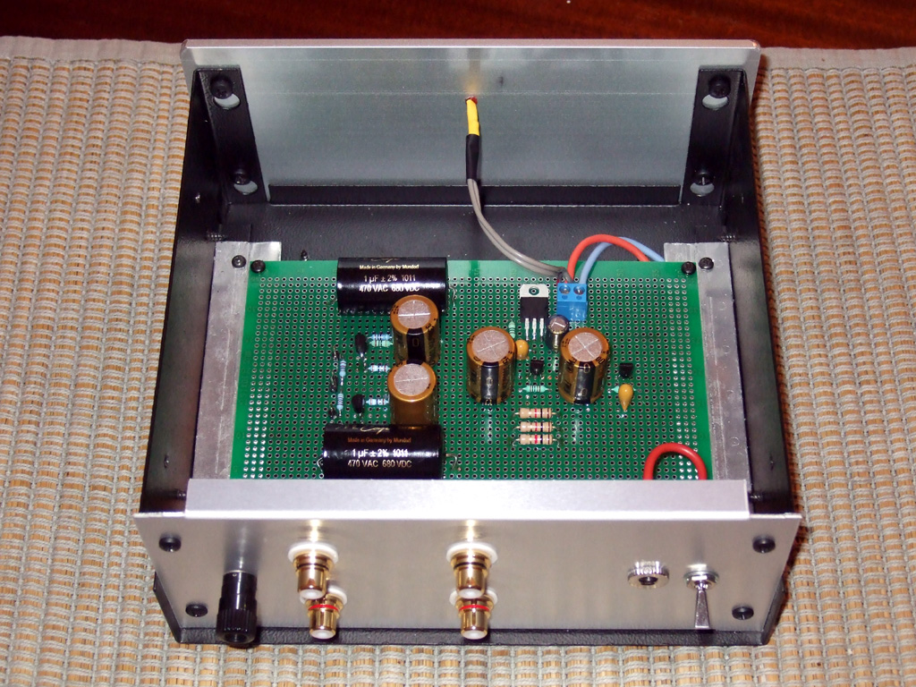

Here is a custom one I made in 2012 for an audiophile in Germany. He had a VDH Colibri XPP MC cartridge with platinum wire coils which presented a weird output impedance due to the higher resistance metallurgy and their four layer winding inductance that he simply could not find a SUT to match well although he had tried.
He was looking for a SUT to start with because when hooked up directly to the MC input of his very expensive phono stage it was sounding like a mediocre CD he said. A batteries powered German design with sophisticated recharge automation. Possibly an ASR high rank model, can't remember well, its been years. Maybe an RFI problem due to inductance and non optimum termination I suspected. And/or underperforming BJT input type op-amps MC circuitry when on a source impedance they were not designed for.
It was a special MC cartridge of high cost and great sonic potential but with an unexpected signal engine for its category in other words. Difficult to predict with what hi-end gear to mate best. It had fairly high output at least. Nearing 0.4mV.
Make something for me of your inspiration that it may finally suit my cart and I am willing to sponsor it even as a failed experiment he said. So I did devise and built something for a very fair charge. Nobody was 100% sure of how good it will mate with the whimsical cartridge, but it all went very well in the end as he replied with happy results when he got it.
Later on he asked for a BiB 1.1 external PSU also to replace the linear wall pack. He reported some additional subjective gains for including that one too.

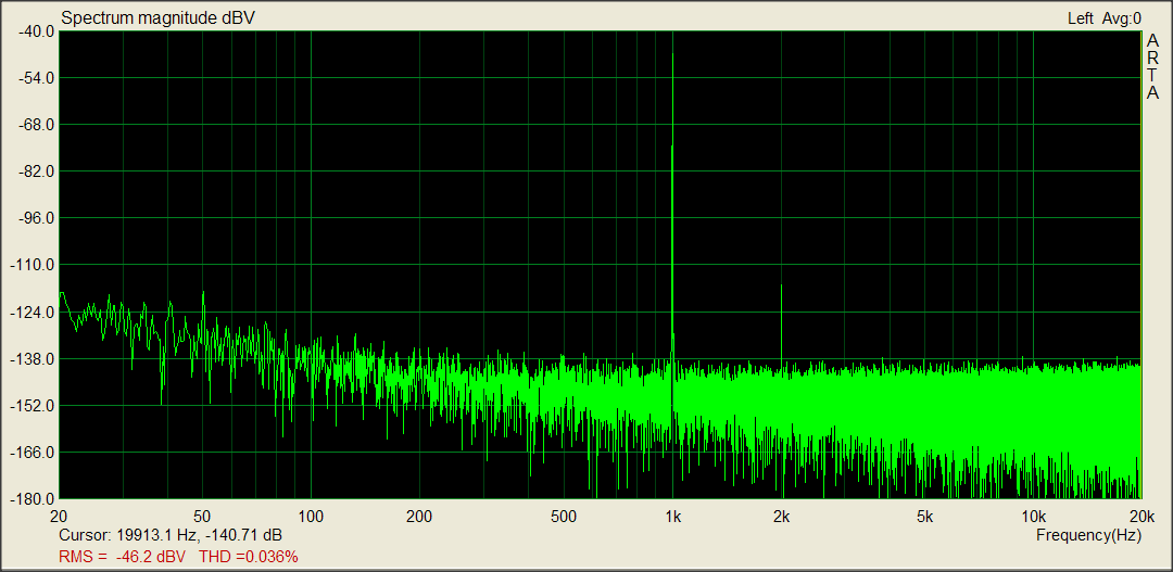

The FFT result you see is for 0.5mV input 5mV output when using a linear wall wart, 9V set LM317, two stage capacitance multiplier. Just careful proto-board build, not even using a groundplane of any sort (!)

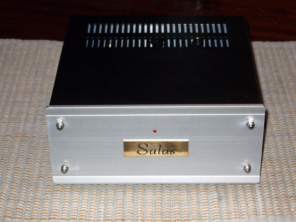

Good Day All,
Well not really, I seem to have had a disaster and was looking for some advice. I was trying to switch pre-amps in my system from the WHAMMY headphone amp I've modified to a Schitt Vali just to give my ears a fresh perspective when there was a brief light show that went from the Vali, from what I can tell, backwards to the Salas Phono Stage. The audible after effects are a garbled signal switching channels dropping out and reappearing all the while varying in amplitude. The Power supply of the amp is still fine, but reading DC voltage across components in the amplifier portion gives me non symmetrical and undulating readings. What do you think happened, first of all, and what are the most likely candidates for having been fried. Where to start?
I appreciate any help or guidance in this trying pisser of a time.
