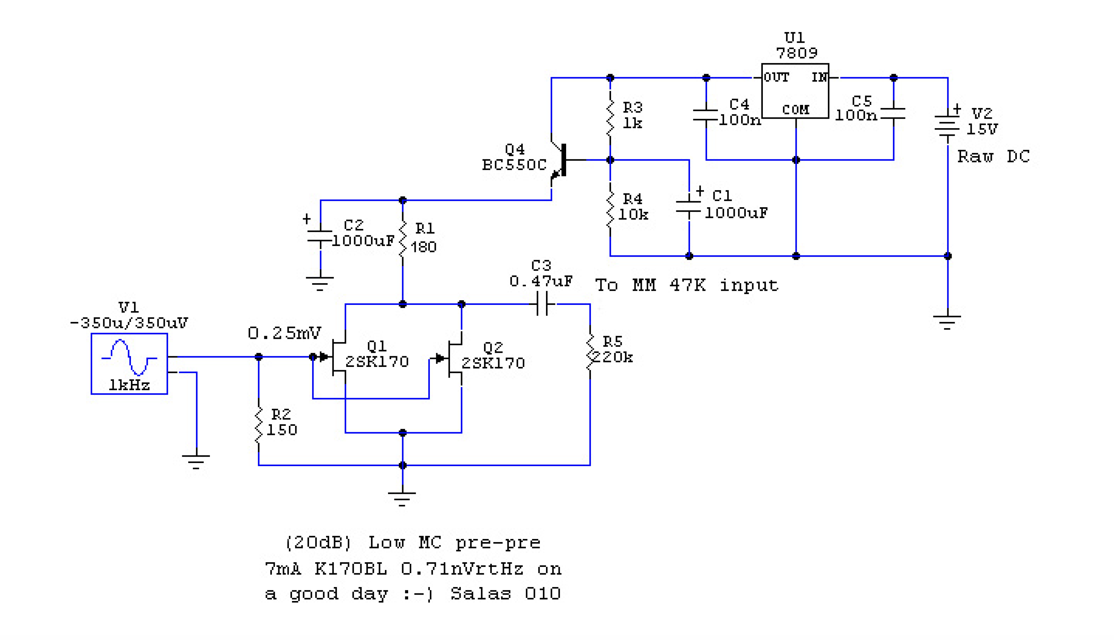

Looks like its electrically correct. Is it configured with 1X2SK369 per channel (MM) or with 2X (MC)?
I built the MC step up. Sounds very, very good. But it's very sensitive to placement. It must be a meter away from my big class A amp for best results. But it is not in a metal box yet.

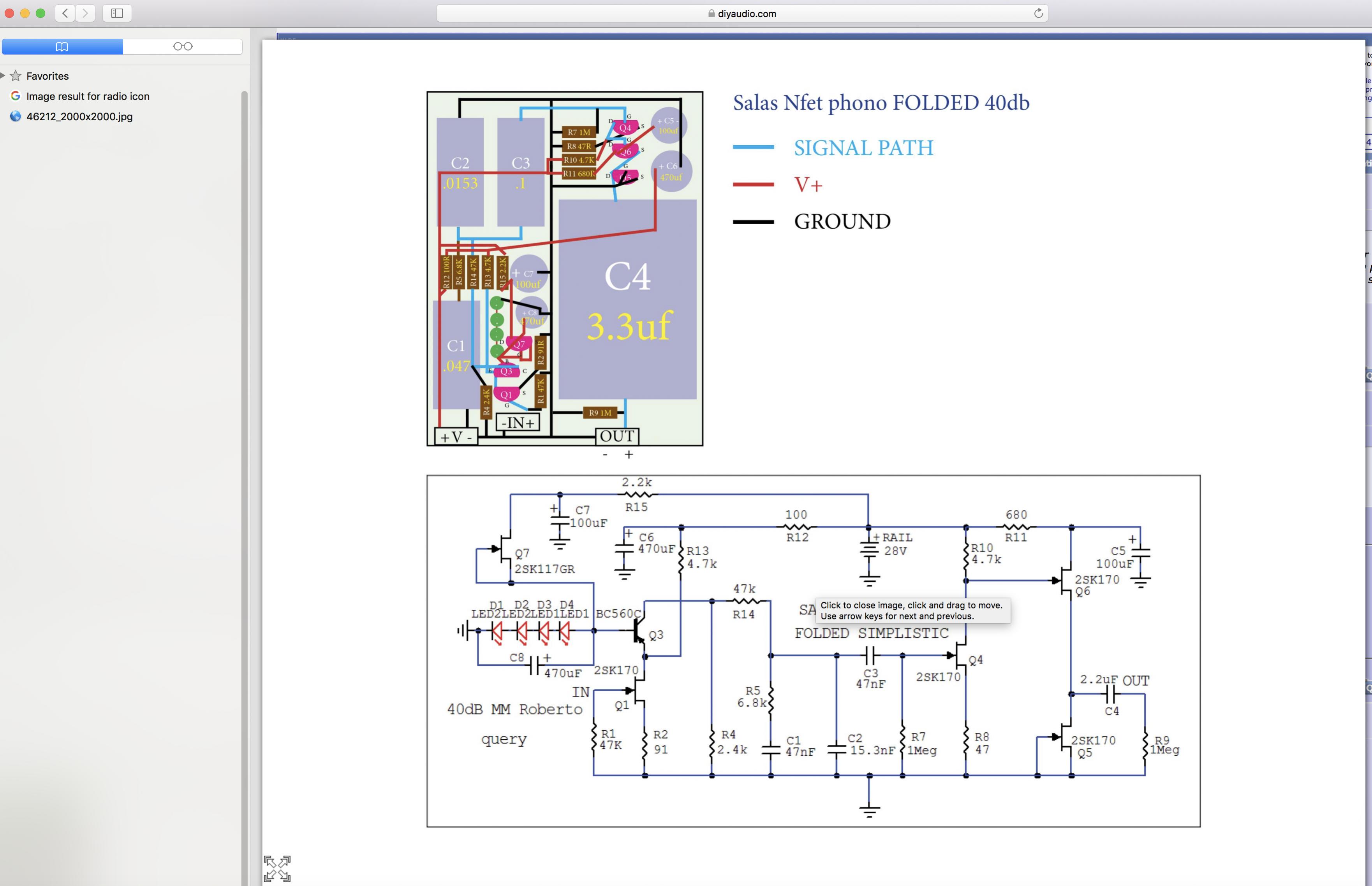

I compared the Salas Step Up run off of batteries with a 1:16 Shure Mic Transformer I bought for cheap on ebay. MM Stage is Salas folded, Cart is Ortofon Quintet Blue.
I have never used transformers before. And it will take a better transformer than this to beat the jfet step up. The transformer sounded very veiled compared to the jfet step up. I tried different loading on the secondary, always sounded dull in comparison.
