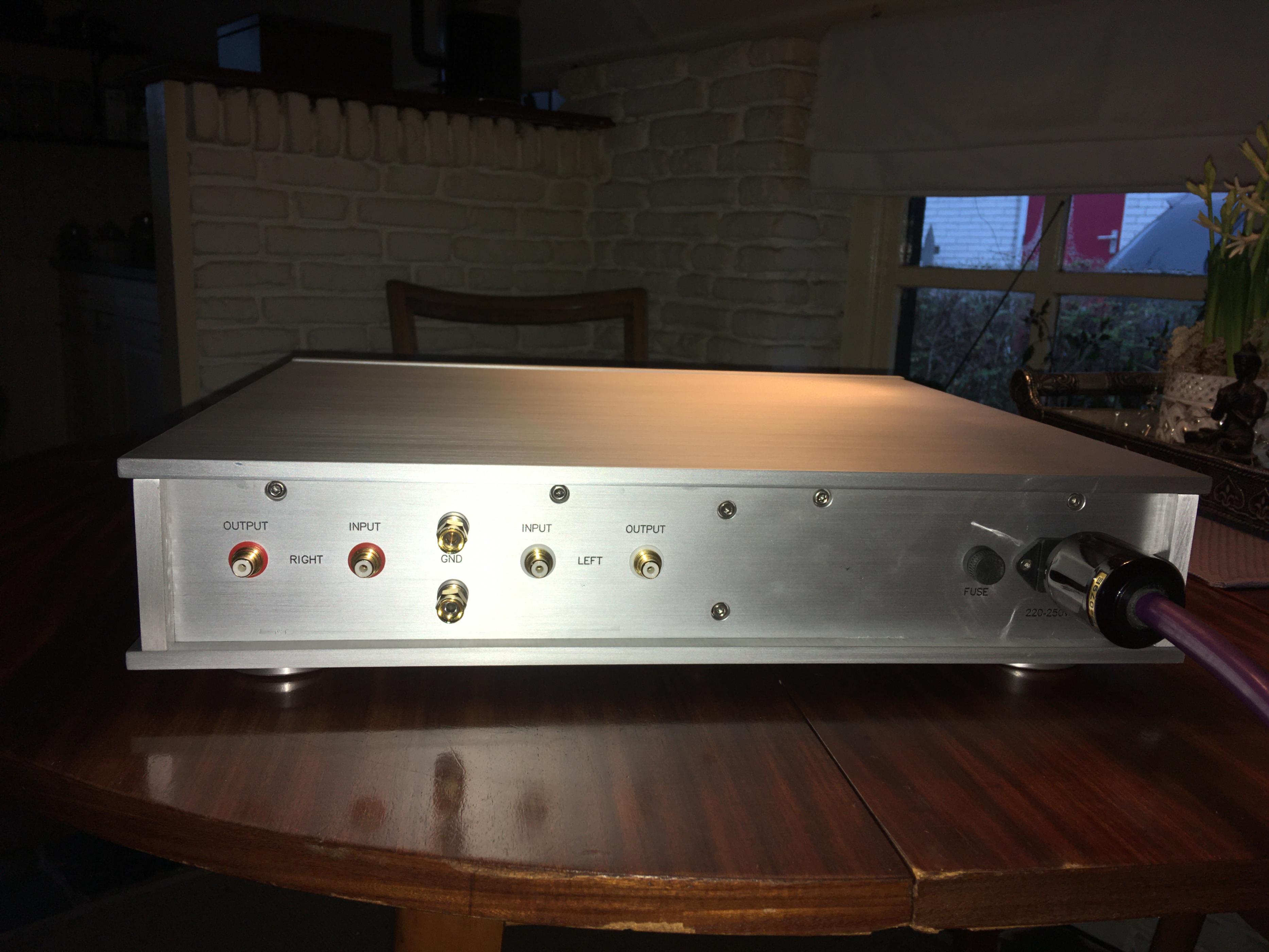

Adjusted for 3.6V both channels, finished the case and hooked it up.
It is dead silent, even with the transformers in the case. no hum at all.
it sounds promising from the start. i will let it play for a while before commenting on the sound.
Thank you Salas and Theabag for this awesome piece of kit, well done.

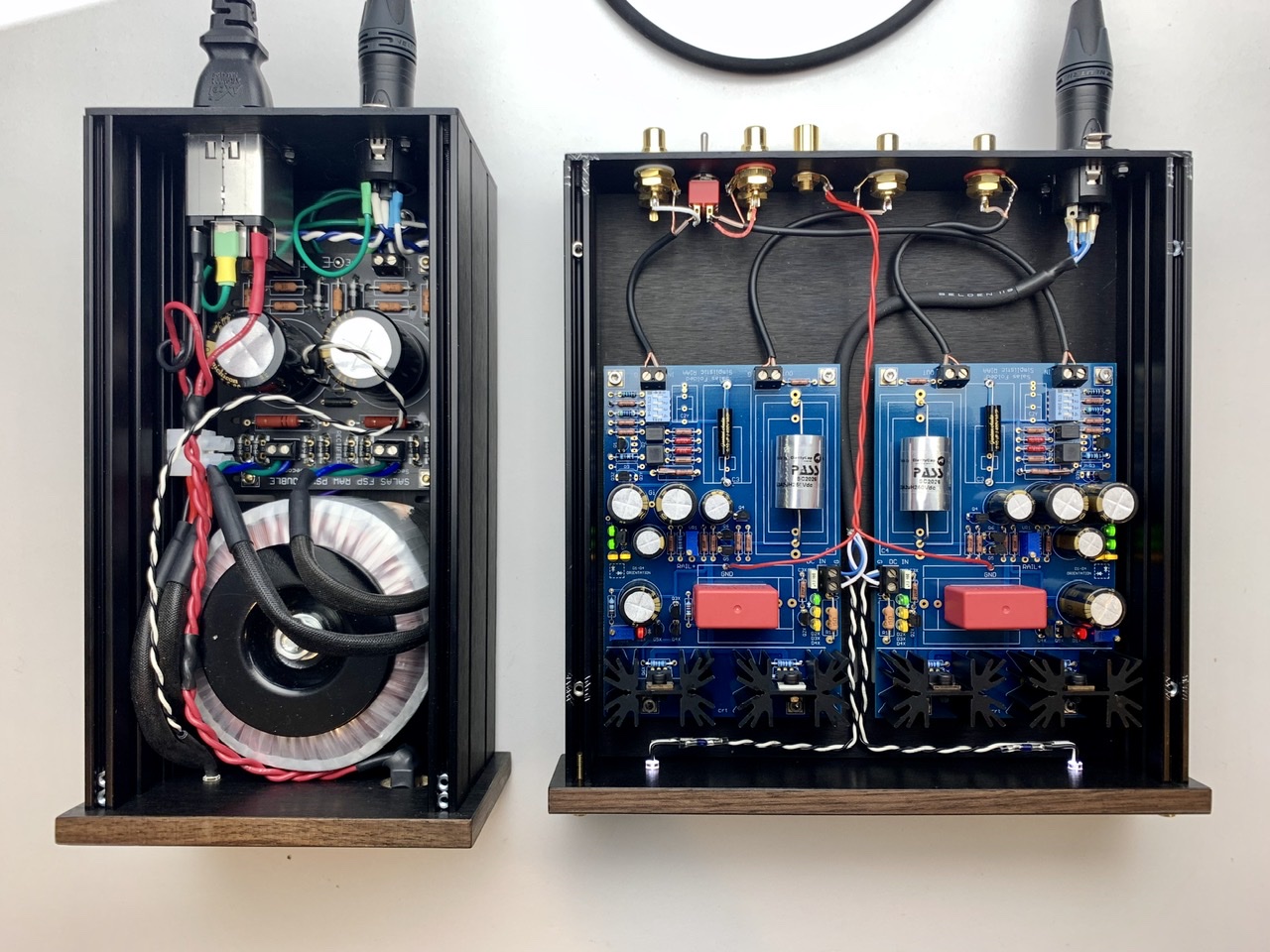

Finally had some time over the holidays to test and box my FSP.
It took a bit of trial and error to get the PSU input voltage in the right range, but now sitting at about 45.2 VDC off the cap multipliers (these reduced input ripple from about 38mV to about <1mV). Led’s on the cap mx are glowing a bit which is worrying - everything measures okay, but they may be a bit stressed because they are at their operating limit (~45V).
Started up without an issue, and regulated voltage is 33.6V right and 33.8 V left, with setup for mc. Tricky setting bias because as soon as I remove the lid to adjust, the voltage starts to drift - perhaps because of the temp change on the jfets? Best that I can get is 3.6V +/- 10 mV. Is that adequate tolerance or should one try again?
Regardless, here is a picture during biasing - I’ll update when I have done some listening.
Many thanks to Salas for this design, and to Teabag for the gb and sourcing some difficult to find parts.

You are welcome and congratulations for your build so far.
There's absolutely no problem with different rail settings tolerance between channels or thermal drift of input stage DC voltage centering (T.P.) especially manifested in MC mode. Such is the nature of things with 2SK369 when run at high Id mA due to small value degeneration resistors in this mode. But that's best for noise performance. In reality there is much leeway allowed left and right of the 3.6V T.P. center for several hundreds mV level signal to develop between end stops even if bias point drift is going to augment a lot with time or season.

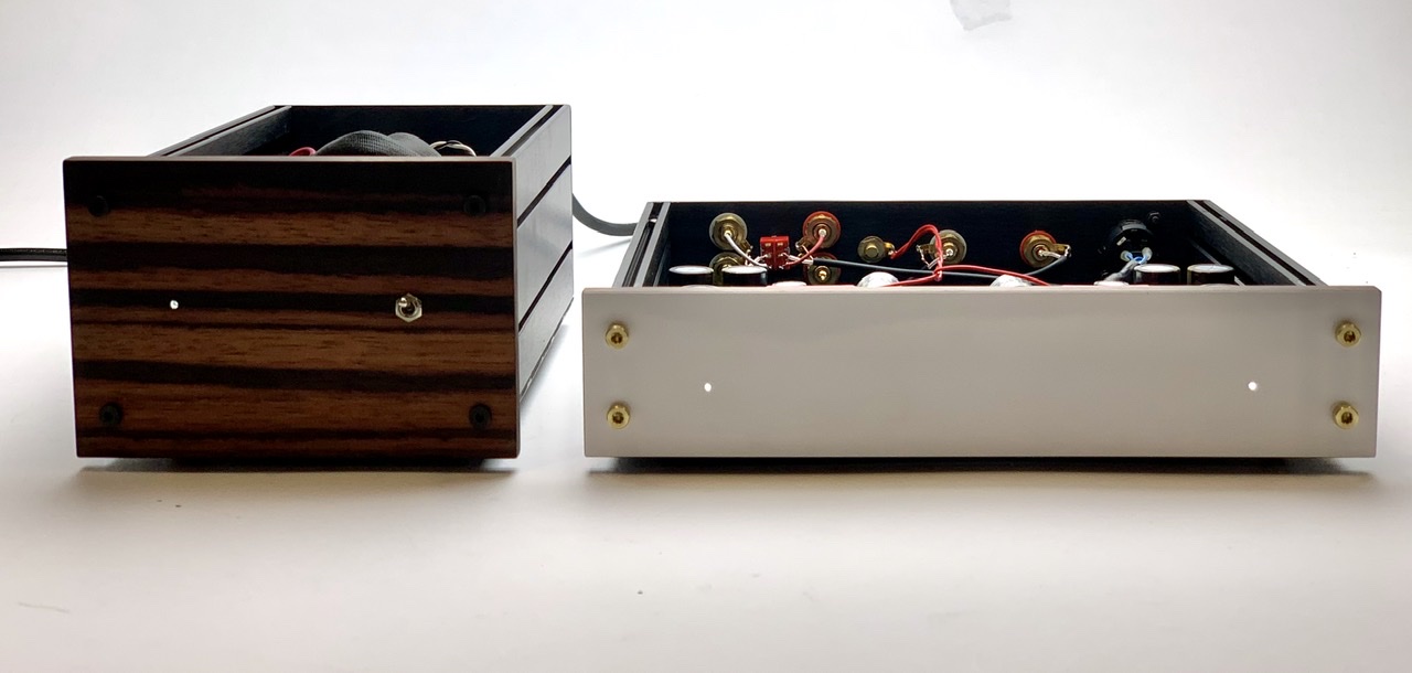

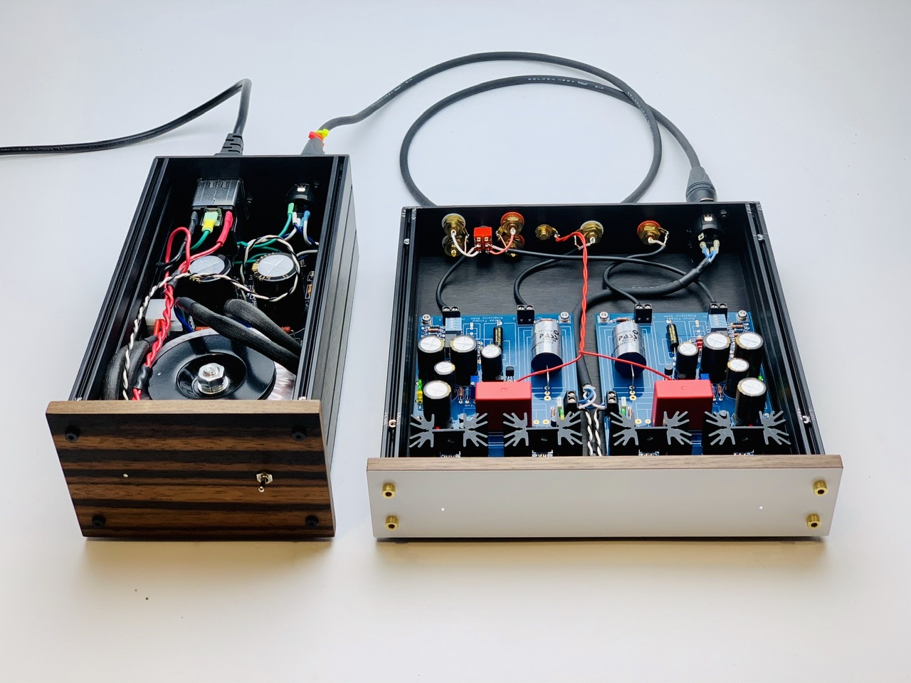

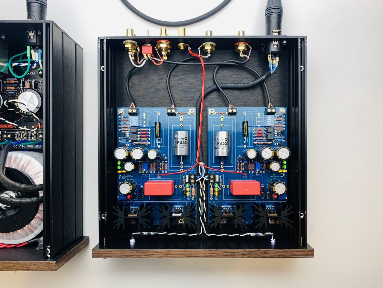

Hey guys, made this incredible phono pre over the weekend at “Camp 6L6”. Been in the making for a while now... and I definitely needed help since it’s beyond my current skills (which we all know Jim has in spades. :) ) Learned a TON, and it sounds incredible.
Little drama with some hum.. wasn’t a lot.... but 2 perfectionists sorted it out. VERY quiet now and I can’t imagine a better sounding phono pre.
HUGE thanks to Salas and Tea for the insightful design and parts connect.
Seriously amazing build both in visual design and application.
