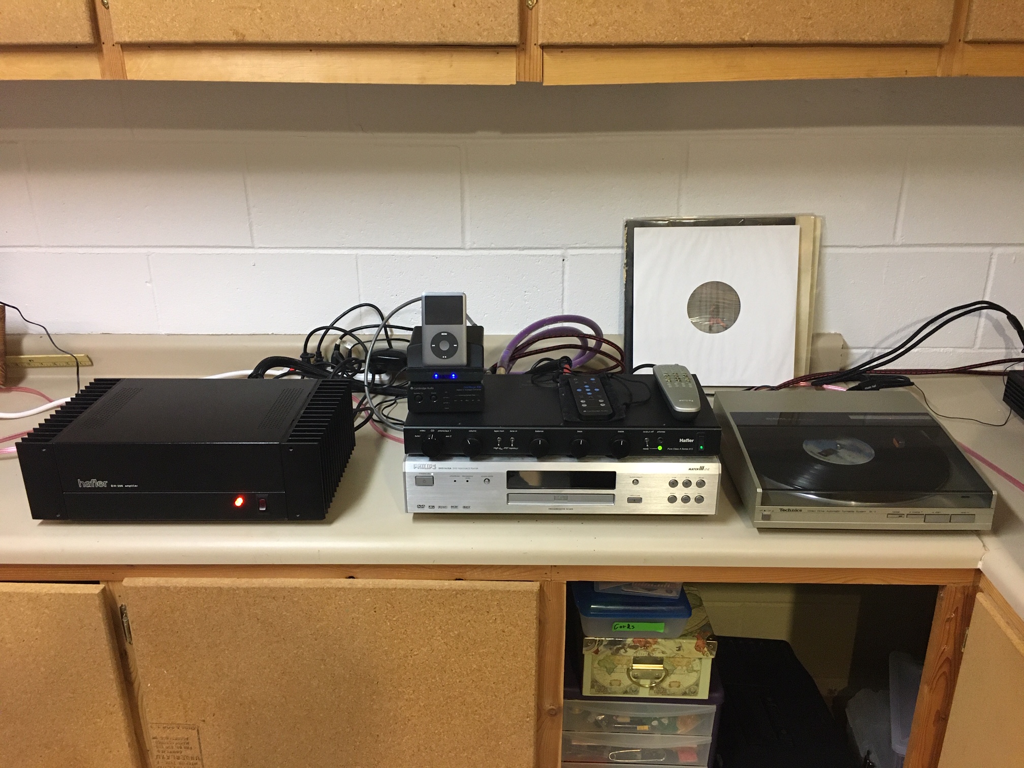

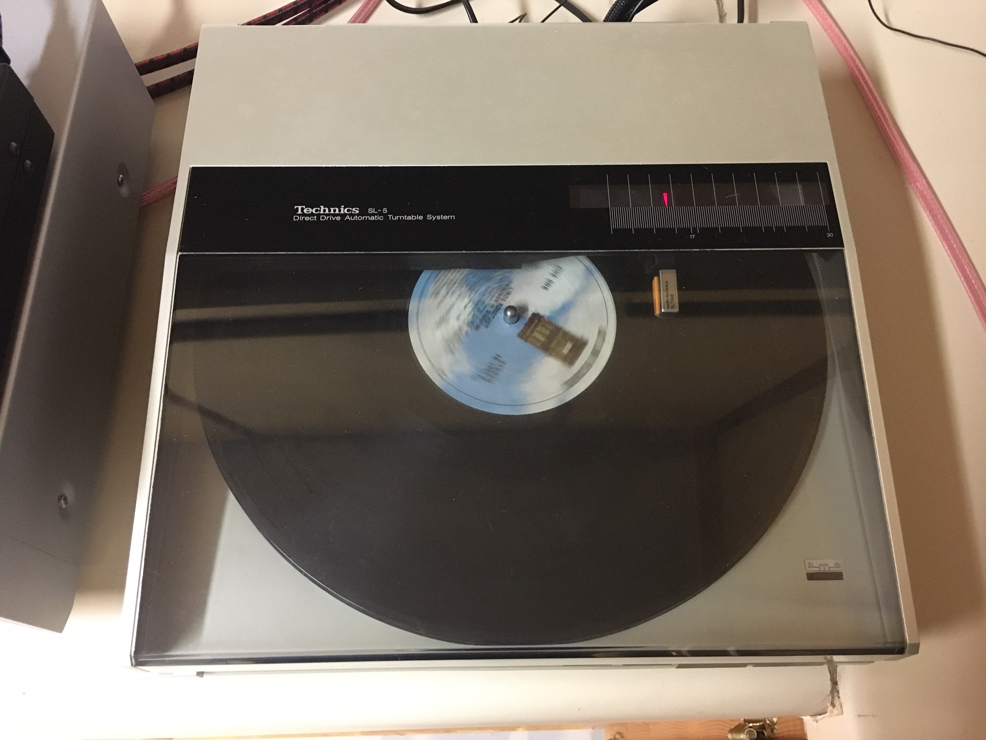

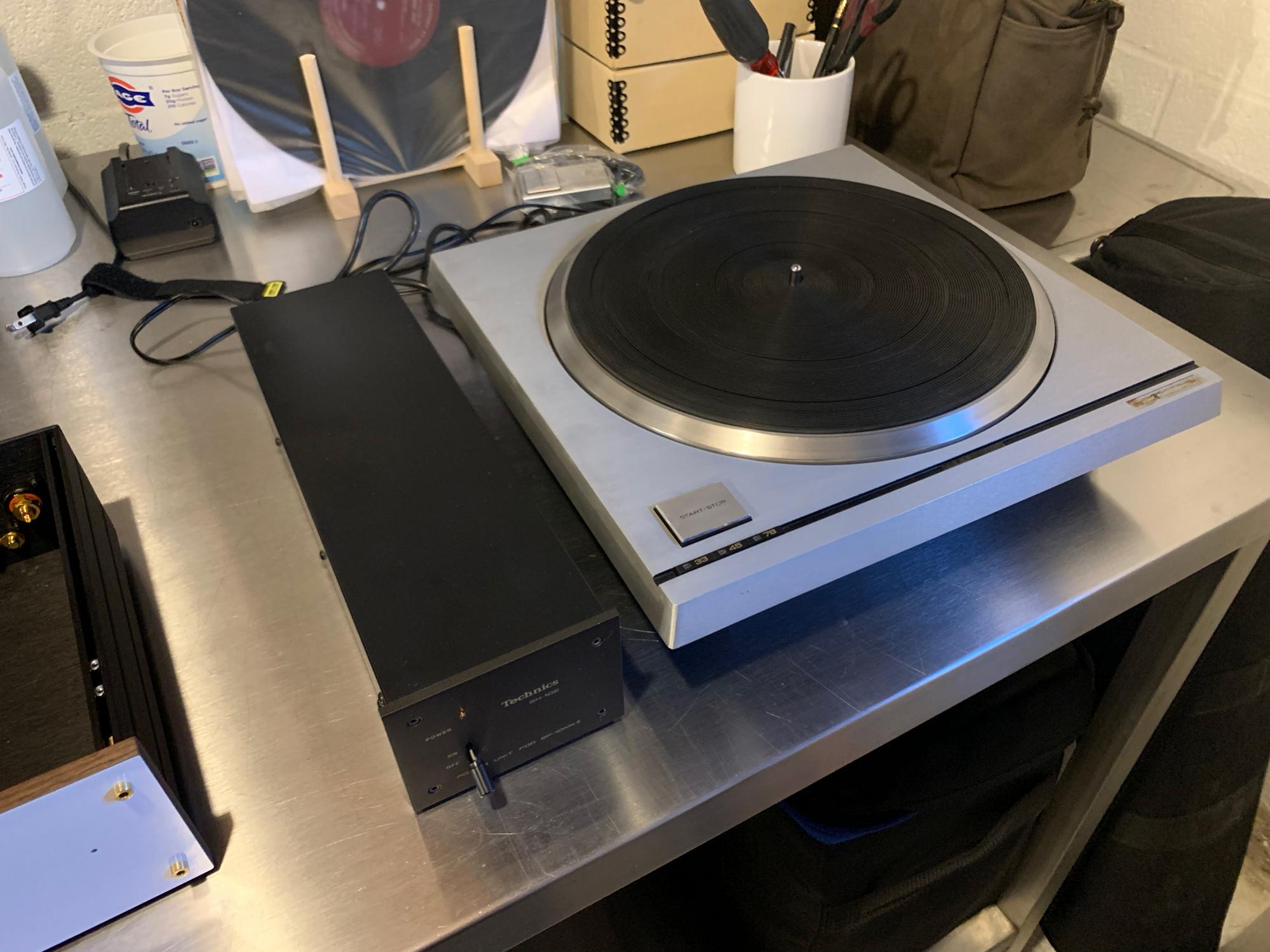

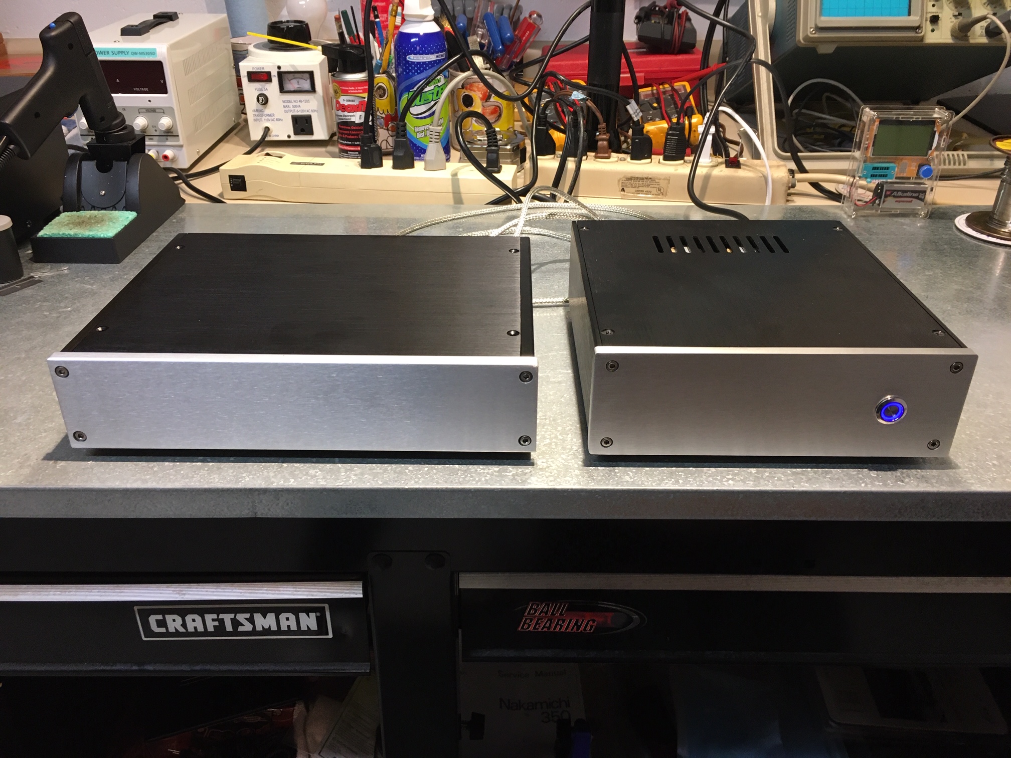

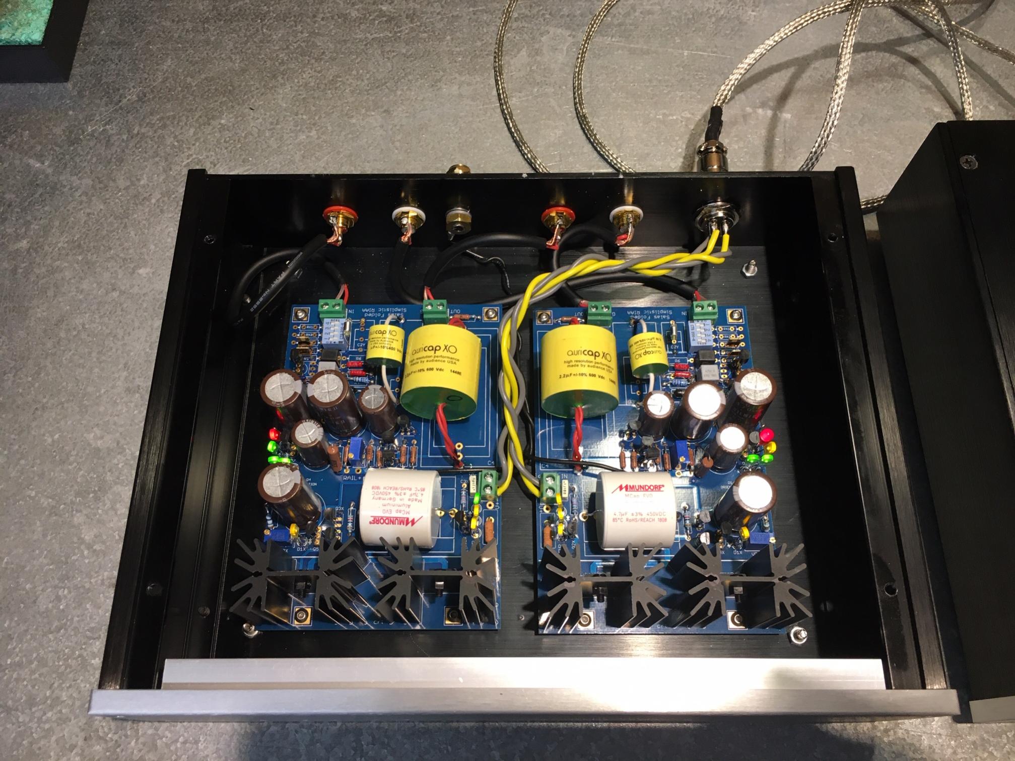

I finished my MM version of the FS NJFET preamp. After I got over the initial thrill of having it play music from both channels at the same time, I spent the next four hours listening. Every couple of songs, I would stop working just to listen, I was surprised at how it kept pulling my attention to the music and not the work I was doing.
It really caught my attention when Lou Reed's New Sensation was playing. A love story of a man and his Kawasakit GPZ motorcycle, the guitar chords were so pleasant to listen to. That is my initial impression, how pleasant!
At the end of the session, I heard more hum than I heard when first started, could be my work area stereo or the "reference quality" turntable I use in the work room.

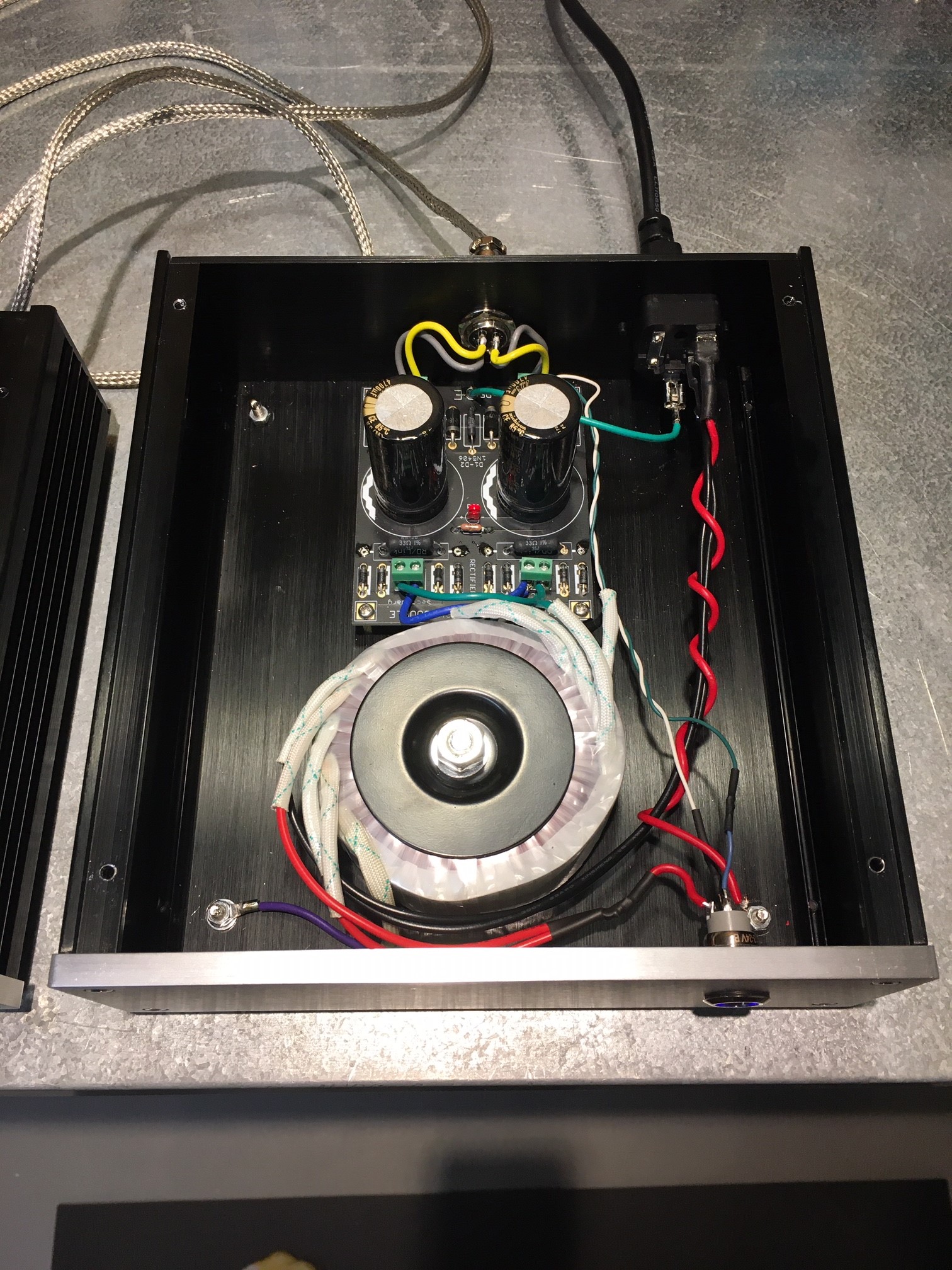

Can't be sure form the photos, but the PSU box must also be linked to the mains protective earth if not, I can see the RAW DC board is linked, also check there is proper electrical continuity between all the phono box panels and the TT lug where the boards signal earth connects. Painted or anodized surfaces can remain isolated if screws aren't making the continuity. Some surface scratching at points of contact between panels or non anodized screws can do the trick if so. I read that the SL-5 can be noisy at times depending on its state of contacts but inspect the above about the boxes earthing status anyway.
Joined 2013
Hello Salas - I found the cause of the hum, I did not have a connection to the chassis from the mains safety ground. I had the mains safety ground connected to the power supply board, but not the chassis, small wire from safety ground to chassis and all is quiet.
