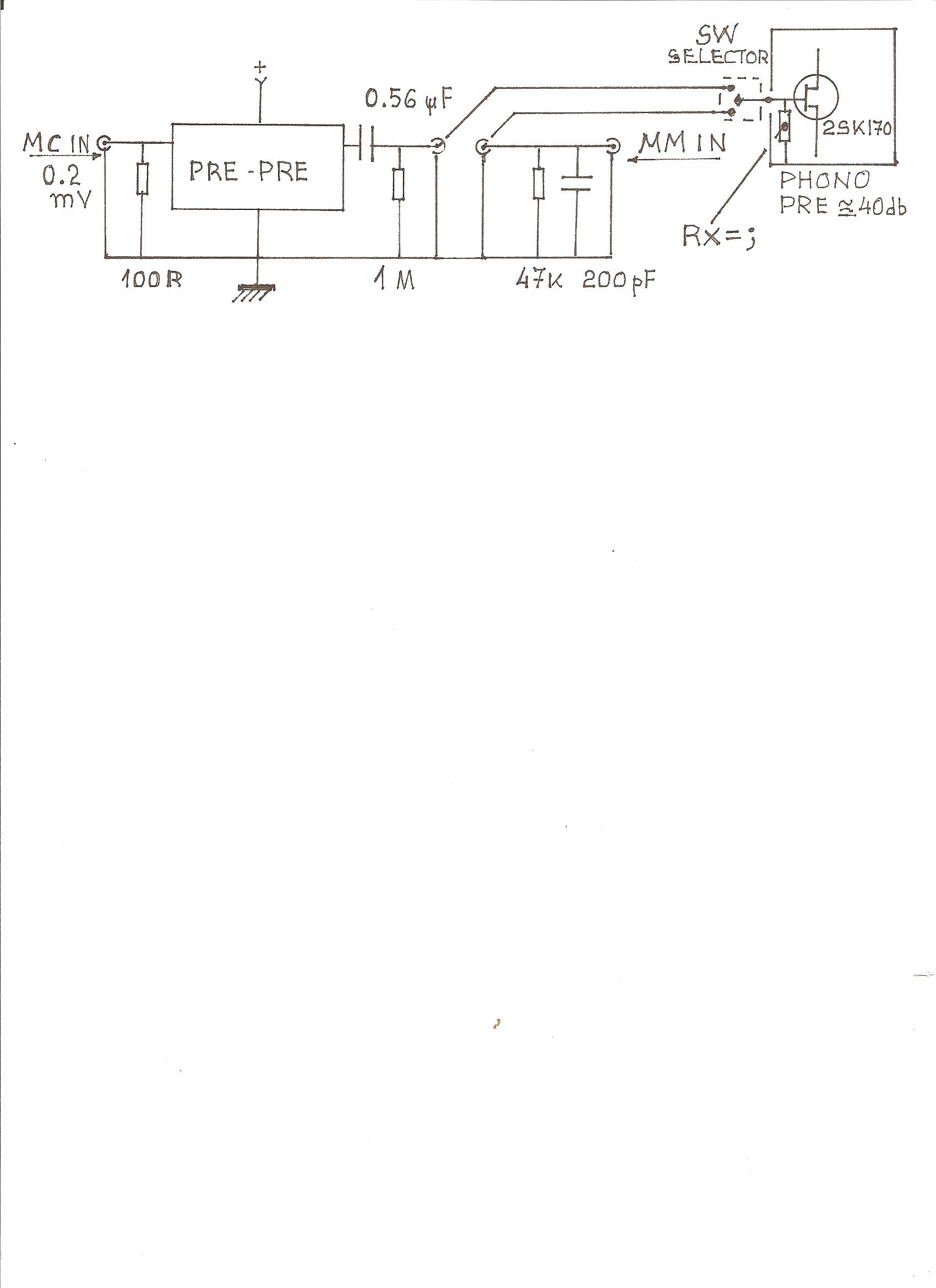

My riaa phono preamplifier with 2sk170 first stage has an input resistor 47K for MM cartridge .
I want to connect a pre-pre MC cartridge via selector (or switch).The output of the pre-pre is through 0.56μF cap and 1M resistor ,as the attached hand drawing (!).
QUESTIONS:
1) If assume that, i am implementing what the drawing shows , what input resistance ( Rx=? ) should i put at riaa preamplifier ?
2)If i leave the resistance 47K at the input (as it is now) of the preamplifier and select between the MC pre-pre out or only the 200pF capacitor with MM in, is correct ?
(sorry for the handdrawing , don't handle a desing program)
Thanks in advance.

Is that about using the 2xK170 pre pre from the older version's pdf?
Just put 47k for Rx. No other 47k no 200pF capacitor either, the JFET input and the TT cable together will provide enough pF.
If you would have to utilize that diagram, Rx should have been 470k at least. In that case the 0.56uF coupling cap could be as low as 33nF.
