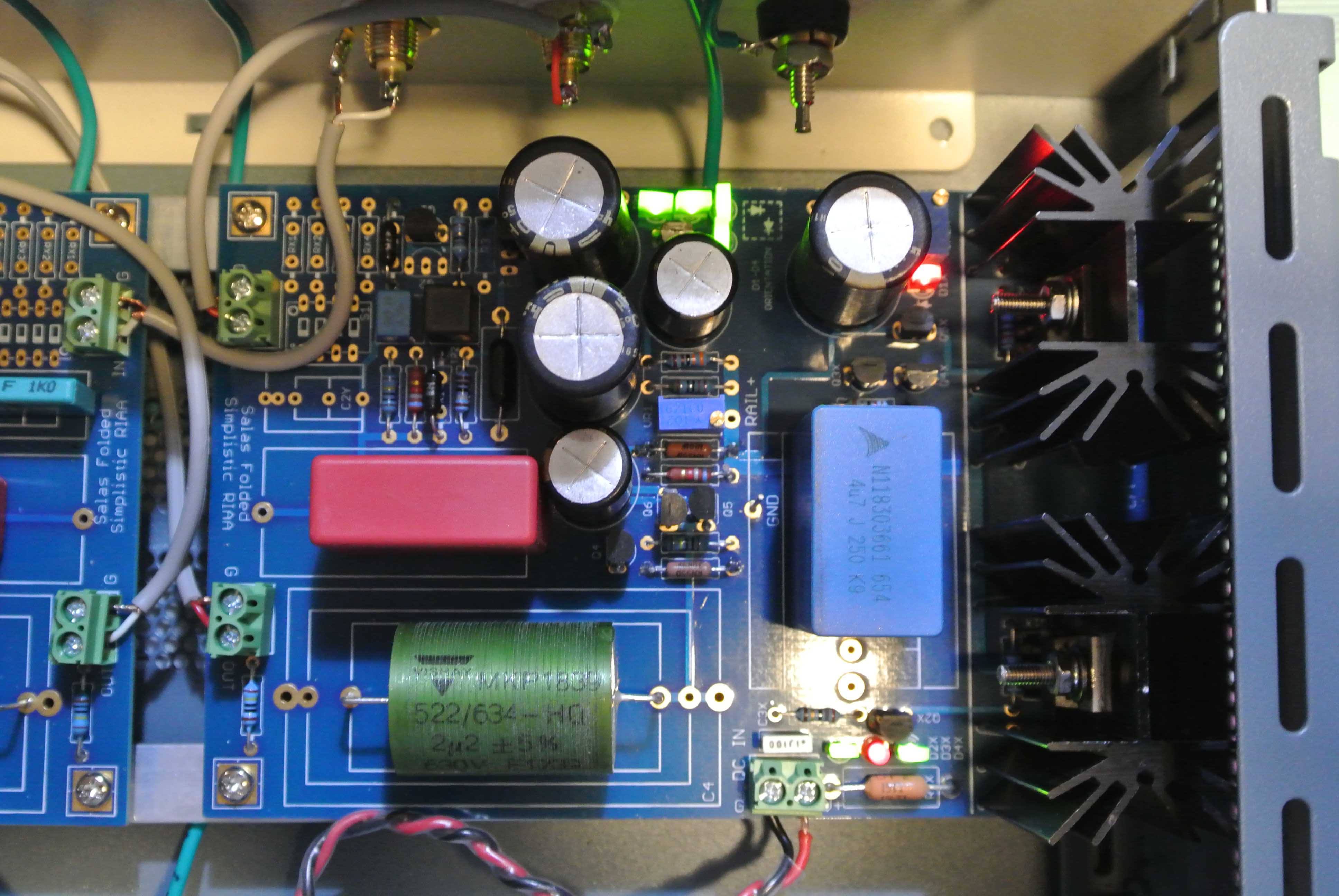

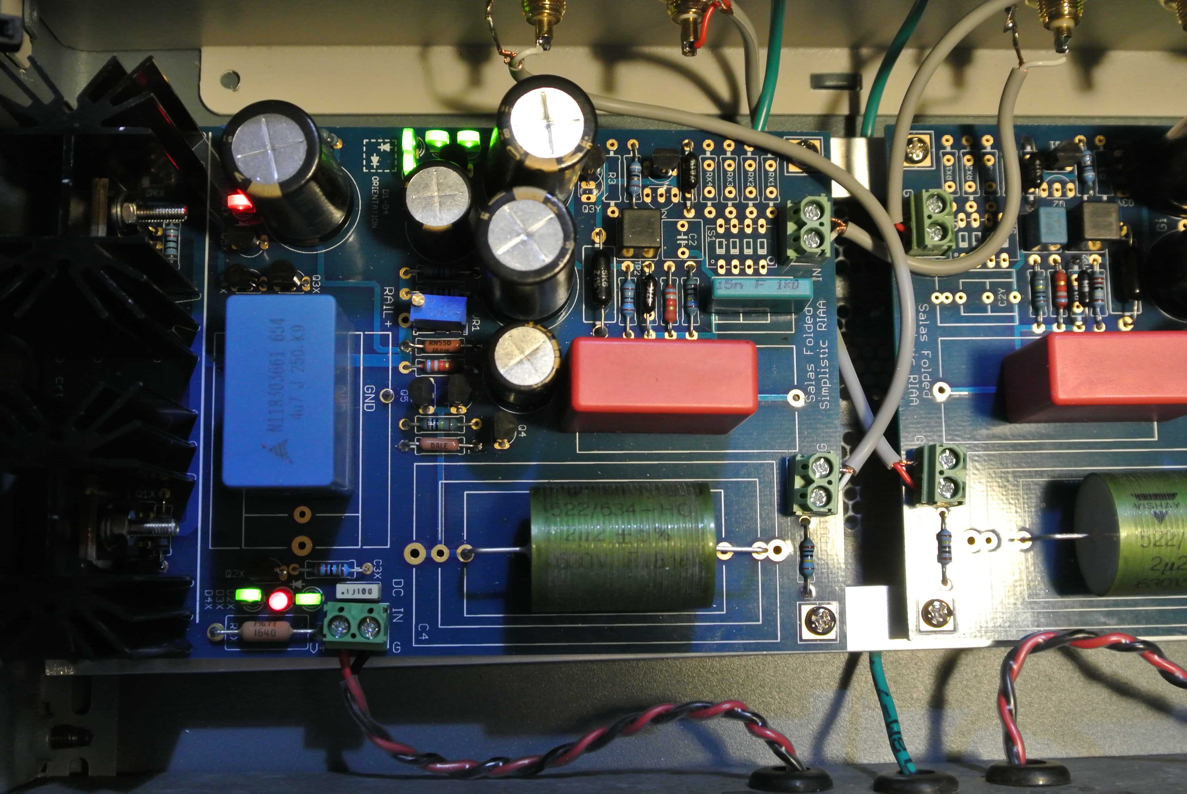

A few photos of my second build of this magic design. Had quite a time of this build and needed to look very carefully at Salas's advice to other builders to get to grips with difficulties in getting the voltages in the ballpark to set the bias to 3.60V in each channel. Couldn't have done it without you Salas. Your sage advice to elwood set me on the right path.

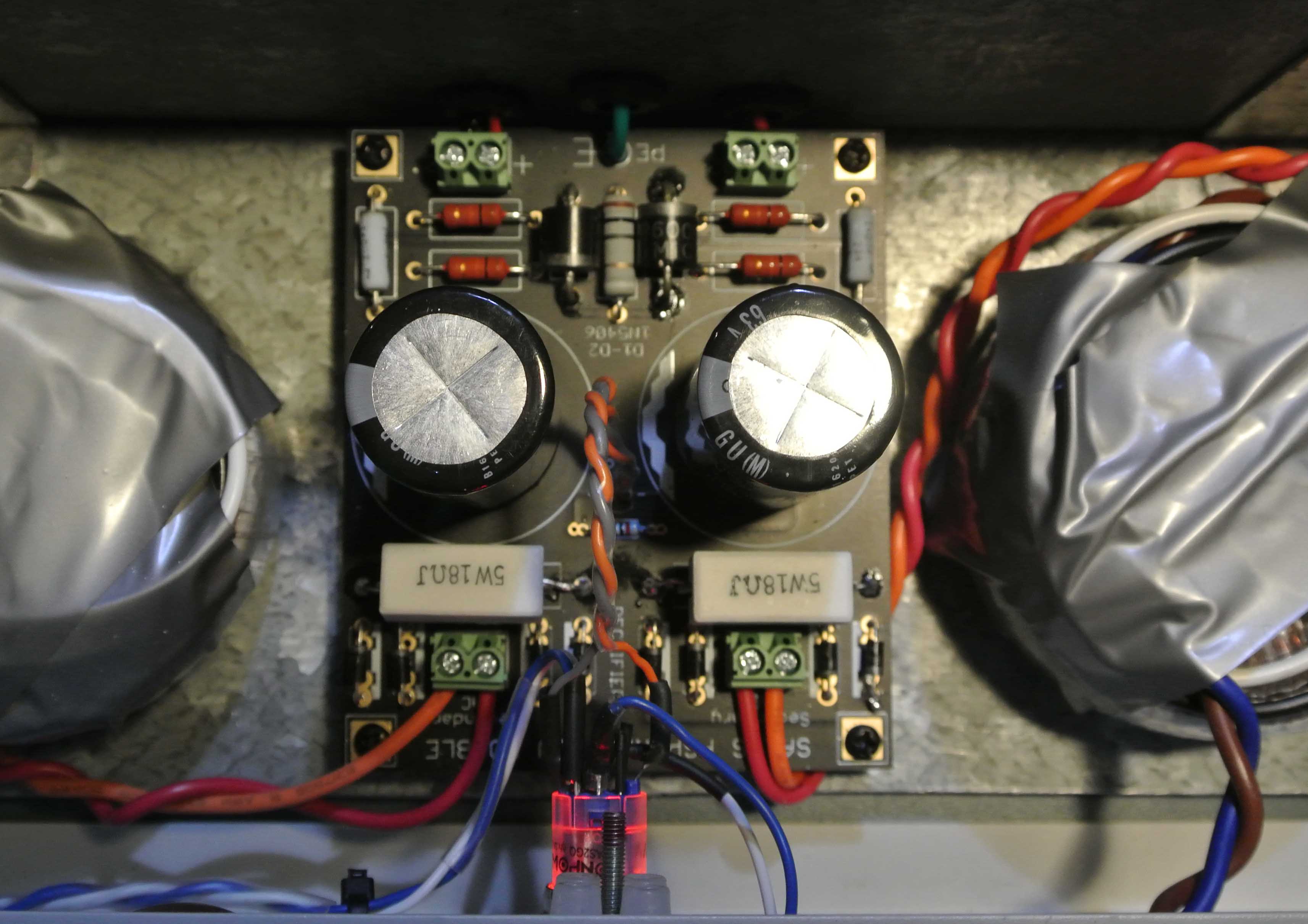

I think one cause for me was an external one: our notional mains supply of 230V spends most of its time very close to 250V so the raw supply was over 53V in each channel. After addressing that problem with the addition of 18R 5W in place of the links in the raw supply, I then needed to adjust R3x in each channel to bring the voltages within the range of the trimmers, ending with about 34V in each channel to give the required 3.60V between TP1 and TP2.

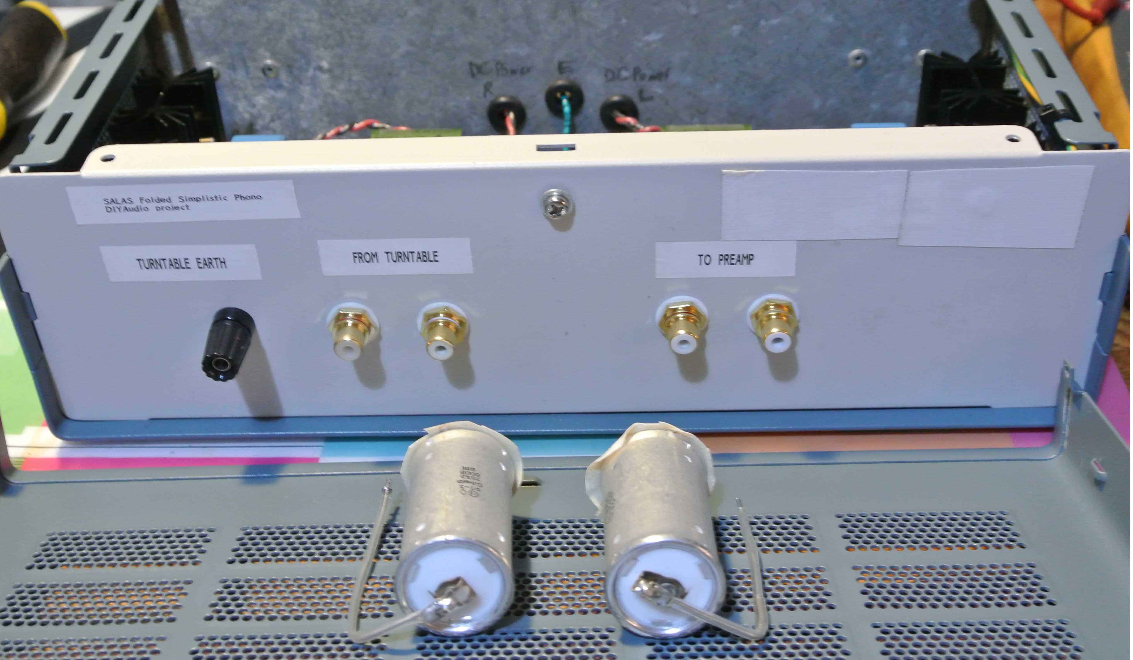

Had another interesting experience with C3. Initially fitted a couple of very large Russian .1uF caps but they had the unfortunate ability to act as antennas for every 50Hz signal within cooee. Fortunately I had in my collection a couple of Wima FKP1 .047uF and they solved the problem perfectly.

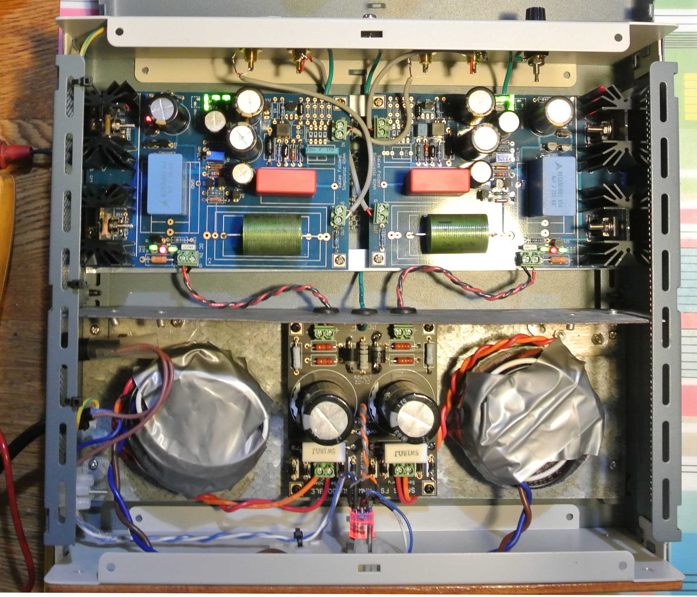

You will note that I have built the power supply in the same enclosure, ensuring that it is shielded from the main boards by a steel plate effectively having the PS in a Faraday cage as the enclosure is also steel. Of course the proof is always one's ears and the preamp is free from hum.

Too high a raw DC voltage at the PSU section's input may lead to trouble indeed. Can make Q1x and Q2x erratic.
Any big metal jacketed C3 could be a hum magnet indeed. A thing for C3 caps is orient their outer foil lead towards the input stage side, because impedance is lower there. They tend to pick less interference that way. Not all are sensitive to that though. Especially compact ones can be indifferent. There is a handy oscilloscope test for finding the outer foil in caps without a mark. Google for it. But the more drastic thing is ground their jacket if metal. With some wire and a tie wrap to can hold it around their aluminum skin. Solder wouldn't bond well on Alu. Very weakly if at all.

I came up against the file size issue for the attachments (numty forgot that he had to make them less than 1Mb). Hopefully they will appear now.
Graeme
A nicely arranged build. Well sorted out electrically, also with measures taken against internal electromagnetic fields interference. The polished wood front panel lends it a classy touch also. Congratulations.
You put a different C2 15nF cap on the left hand board I see. In the parallel C2Y position because of its long form factor. RIFA/KEMET? What is its exact value, is it matched to the other channel's Vishay C2?

Thanks for your kind comments Salas.
The different 15nF caps - well observed! I measured the values of the supplied caps and the Kemets which I had on hand and selected the two nearest to 15nF. I have not kept a record of the exact values. If over time I decide to add C2Y caps of say 150pF I would be able to mount the one in the C2 slot vertically.

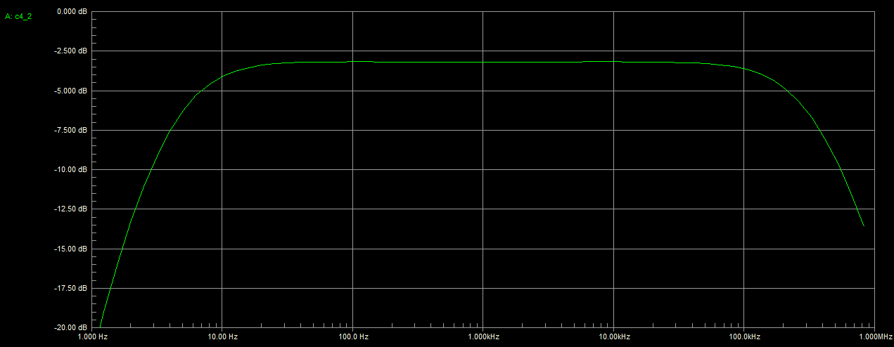

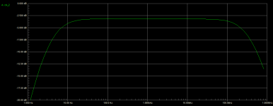

For what line preamp input impedance to couple to? How many kΩ?
At this point, it would be a dcb1,I think 10k pot, no more than 20k for sure.
Later, it may be an aksa lender with Melbourne daughter board. Not built yet.
C3 100nF C4 3.3uF in the phono when feeding 10kΩ control preamp input looks as simulated in the attachment. Close to what C4 2.2uF would look on 20kΩ.
In any case, if 3.3uF will come across overbearing in a specific TT-room-speaker situation, changing C3 to 47nF can pre-shape the curve back to a less shallow corner. Small value caps are cheaper to exchange.
