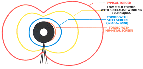

Meaning single 100VA toroid of two independent 32V secondaries? If talking double trafos, situation ends up total VA super heavy for the job. Bigger cores also throw wider stronger stray fields. A very important consideration when in the vicinity of tiny signal carrying turntable cables and a high gain preamp box.

BTW this nice self explanatory pic comes from Talema-Nuvotem a well known transformer manufacturer.

I wouldn’t use a big transformer in this case, and anyway, 50VA is humongous for the job. The primary reason why the 50VA Antek is chosen is because it’s the smallest they make with a shield.

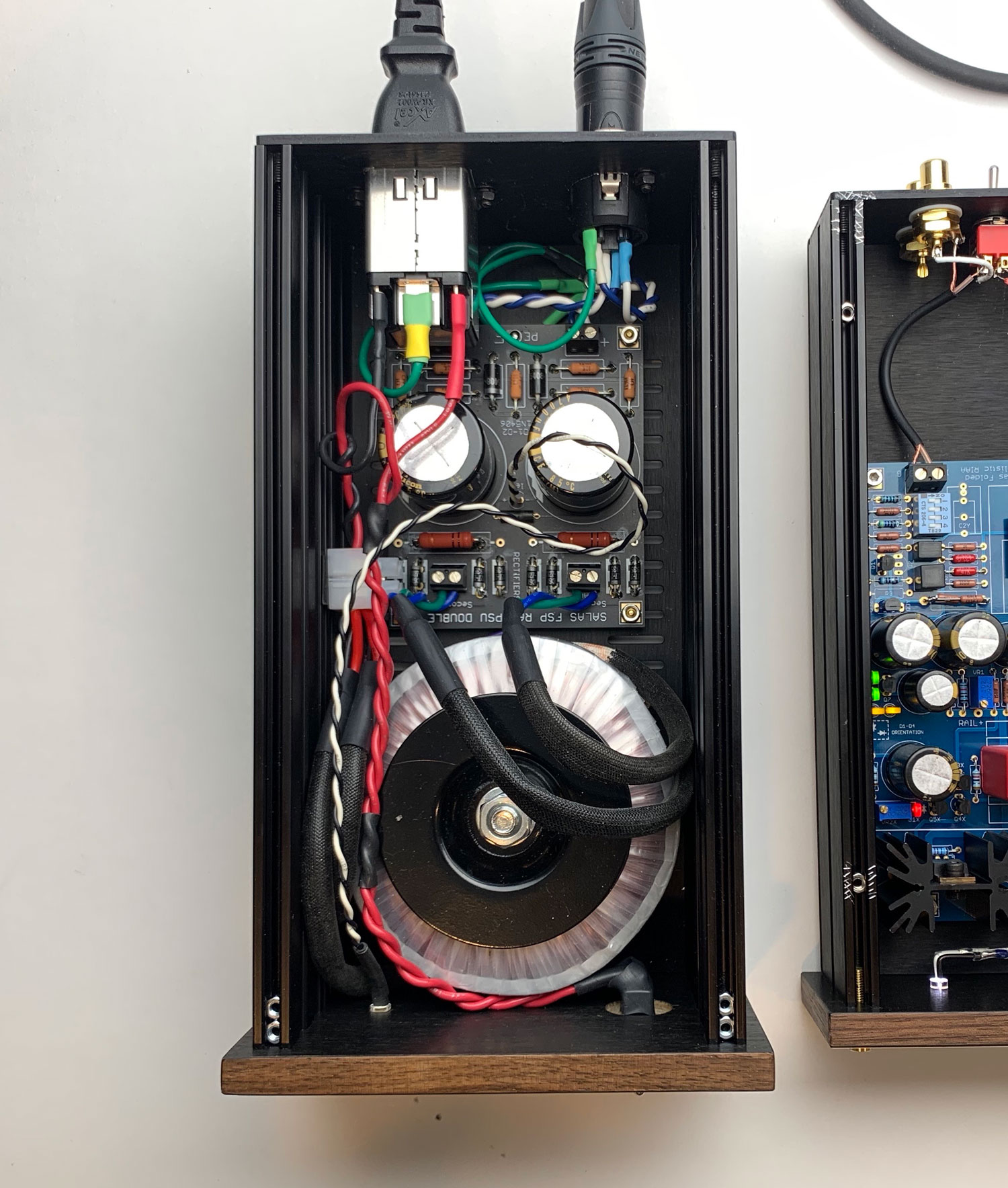

Here's the 50VA Antek in a 2U Galaxy (124 x 230D):
Galaxy 2U w/Aluminum Covers – diyAudio Store
Fits, just. It's a very nice brick of a power supply in hand.
