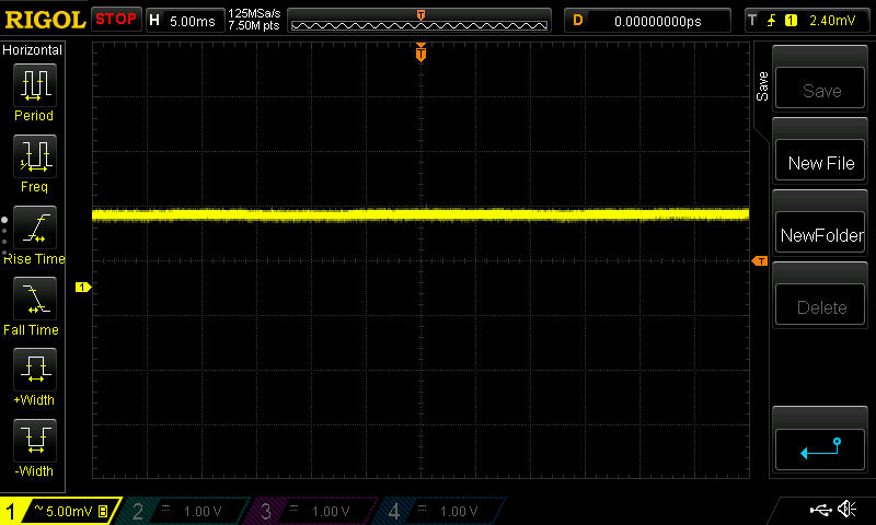

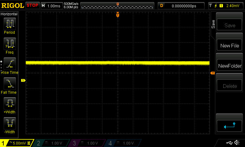

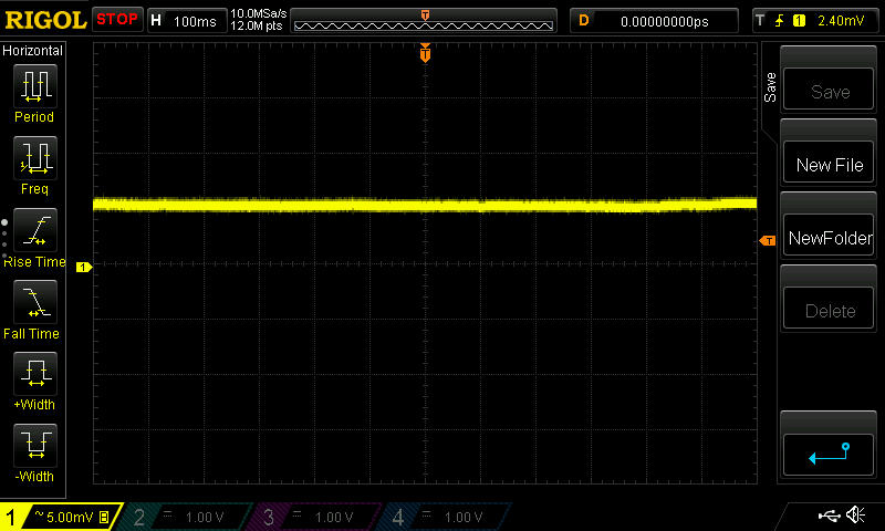

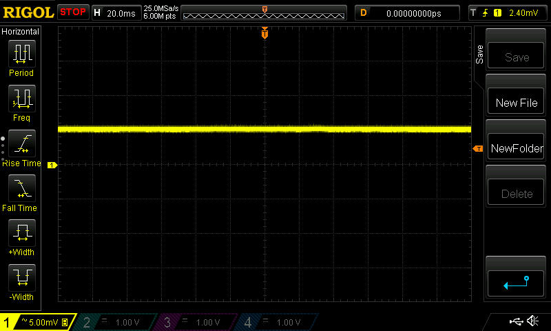

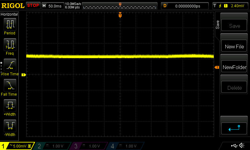

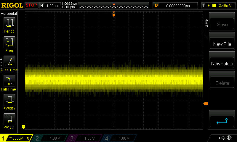

Salas helped me to run final electrical test on 1.3S part of new UltFolded to see if 34VDC is stable and has no oscillation or noise. 5mV/dev is used with different time domain. It is absolutely free of oscillation and noise operation. Very clean and stable shunt work. Phono side was connected during test. Please see images bellow.

With intensity high up on a DSO no hint of AC patterns in the bars across very slow to very fast time scan. Even on 0.5mV 1uS resolution. Very stable. Don't know what's the measurement loop's own noise, would show residual if shutting down the DUT while keeping the probe where it was, but its nice say 20mS is as thick as 1mS. Usually noise bunches up as we go slow. Due to 1/f noise knee. Your build seems very well executed and unproblematic.
If you also got analog scope handy see 1mS 5mV with same probe same setting same 20MHz bandwidth limit. Should be interesting between real phosphor and LCD screen.

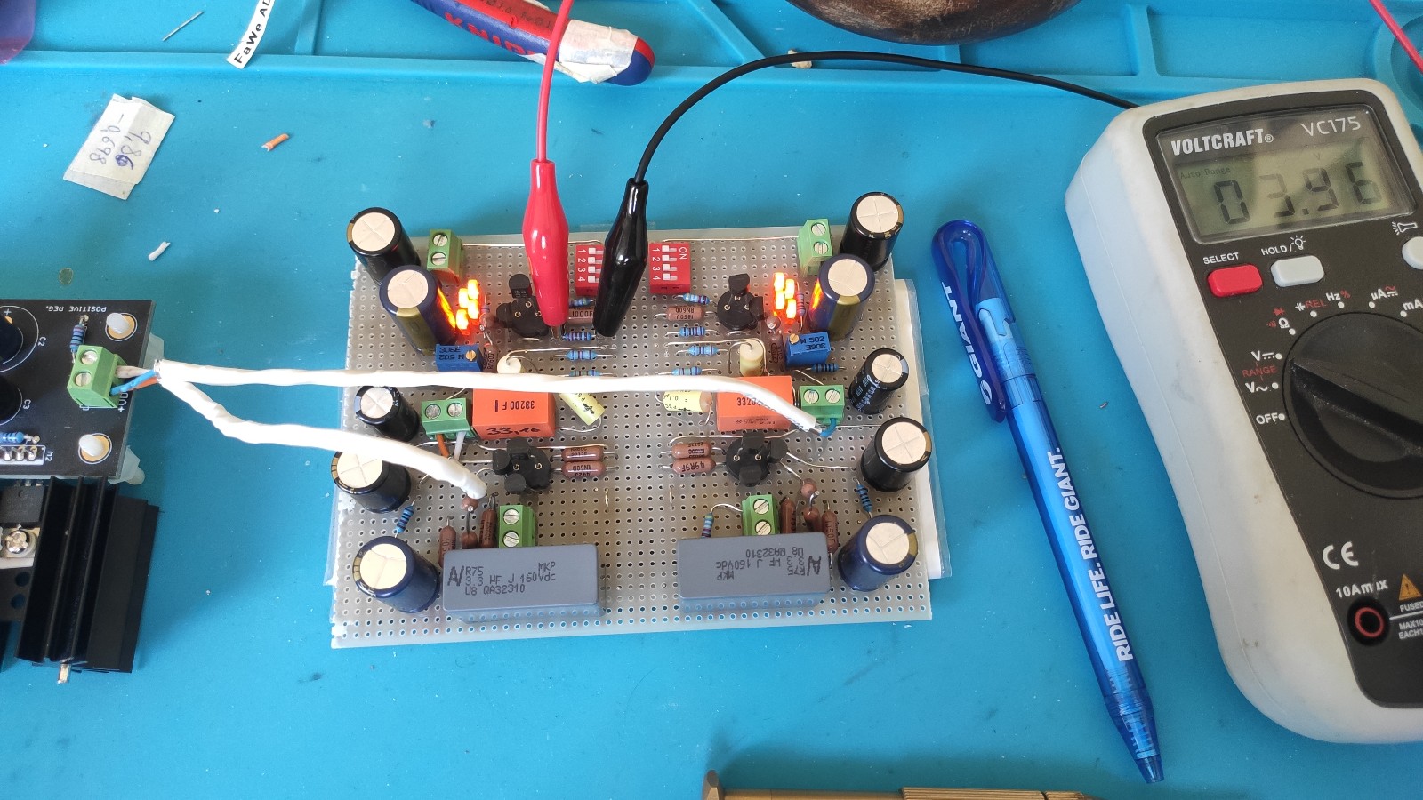

I could not resist to build a matrix board remix of the fsp layout, while i wait for the second run of the ultra fsp GB. I had already sourced and matched a small bunch of 2SK369s thats why i wanted to get started. I wanted to have a kind of test bench to test biasing with the Idss ranges my 2sk170s have. This version is mm only and comes without the gain switches of the new fsp.
Still waiting for my cheap component tester kit i ordered, thats why i had to used unmatched BC327-40 in the cascode.
Testing the LEDs for forward voltage i realized that the orange Kingbright LEDs wont be sufficient to achieve more then 7,5V at 6mA current. I had some random jfets with about 13mA at 12V Vds that made it possible to run my LED quad with about 7,75 V forward Voltage. I had to change R18 from 2.2k to 1k due to the higher Id of the Jfets i used. It works somehow, but i am not sure if this solution is sufficient for the final build?
I used 11mA 2sk369 as suggested. It was easy to achieve 4V at the TP. But powering the fsp proto with a Ultra-Bib 1.3 the bias point was drifting a lot during warm-up of the PSU.
I did not listen to many records yet but i feel that the 2sk369 folded cascode really sounds a bit better then the telescopic cascoded 2sk170s that i used in my last matrix board build. Bass seems to be firmer and stronger without beeing bloomy. Clarity has also improved.
When i play music, the bias voltage starts to fall, when the music stops it rises again. Is this a normal working condition of the fsp construction or a kind of flaw in my implementation?

Hi, you don't need reach very high total Vf on the LEDs. There's also the common base transistor adding Vbe. Measure across the K369 for no more than 8V DS. As MM it should have ~2.5mA Id. Readable on its 100R Rs.
Regarding layout and PSU collaboration there can be practical traps, maybe something isn't as perfect as it should be in this proto bed. Given those K369s are testing legit of course. But it could be good enough as a taste.
MM mode should be normally stabler for T.P due to its using a comparatively large value K369 source degeneration resistor. Adjust for after half an hour warm up. Always fully exploit local VR1 before resorting to rail voltage trim when hunting for T.P.
Hi, thank you for answering. Do you mean i can run my LEDs with 6mA @ 7.4 V as long as the voltages are matched between channels?
I observed TP voltage for a longer time and you are right, it doesnt change that much after about half an hour of warm-up. It varies only 3mV while music ist playing.

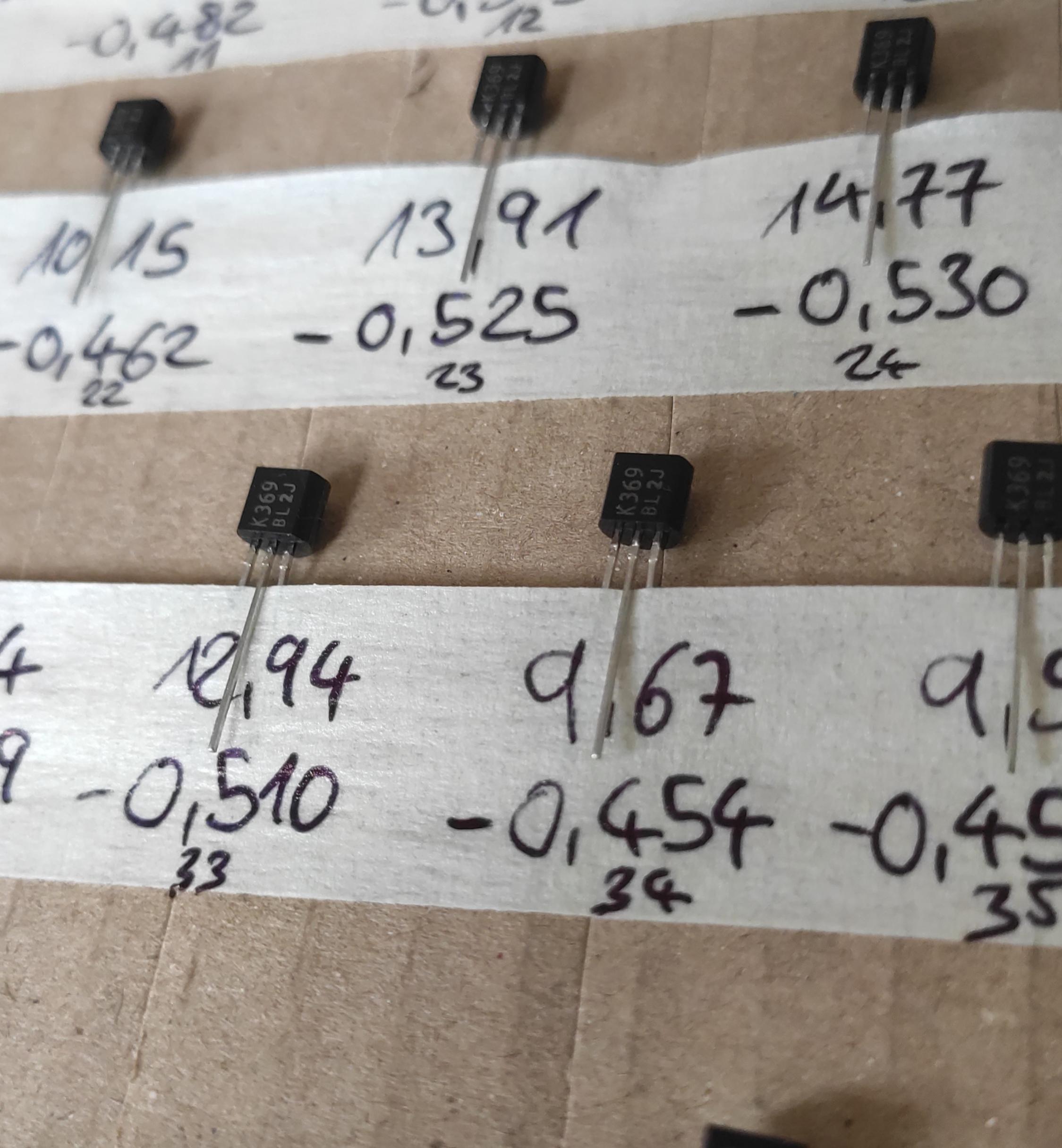

The 2sk369 come from a fishy source (Kessler Electronics) but seem to be the real deal. Rd measures in the 25 Ohm range, Idss vs Vp matches datasheet values. See attached picture of jfets for interest. The bad news is that they are sold out now at Kessler.

Yes you can run your LEDs at 7.3V or 7.4V without a practical problem in this.
Those last of stock K369s in the photos seem good electrically. RDS is normal for the type. I have cowboy legged white letters samples so I can't compare details about the correct looks of yours.
