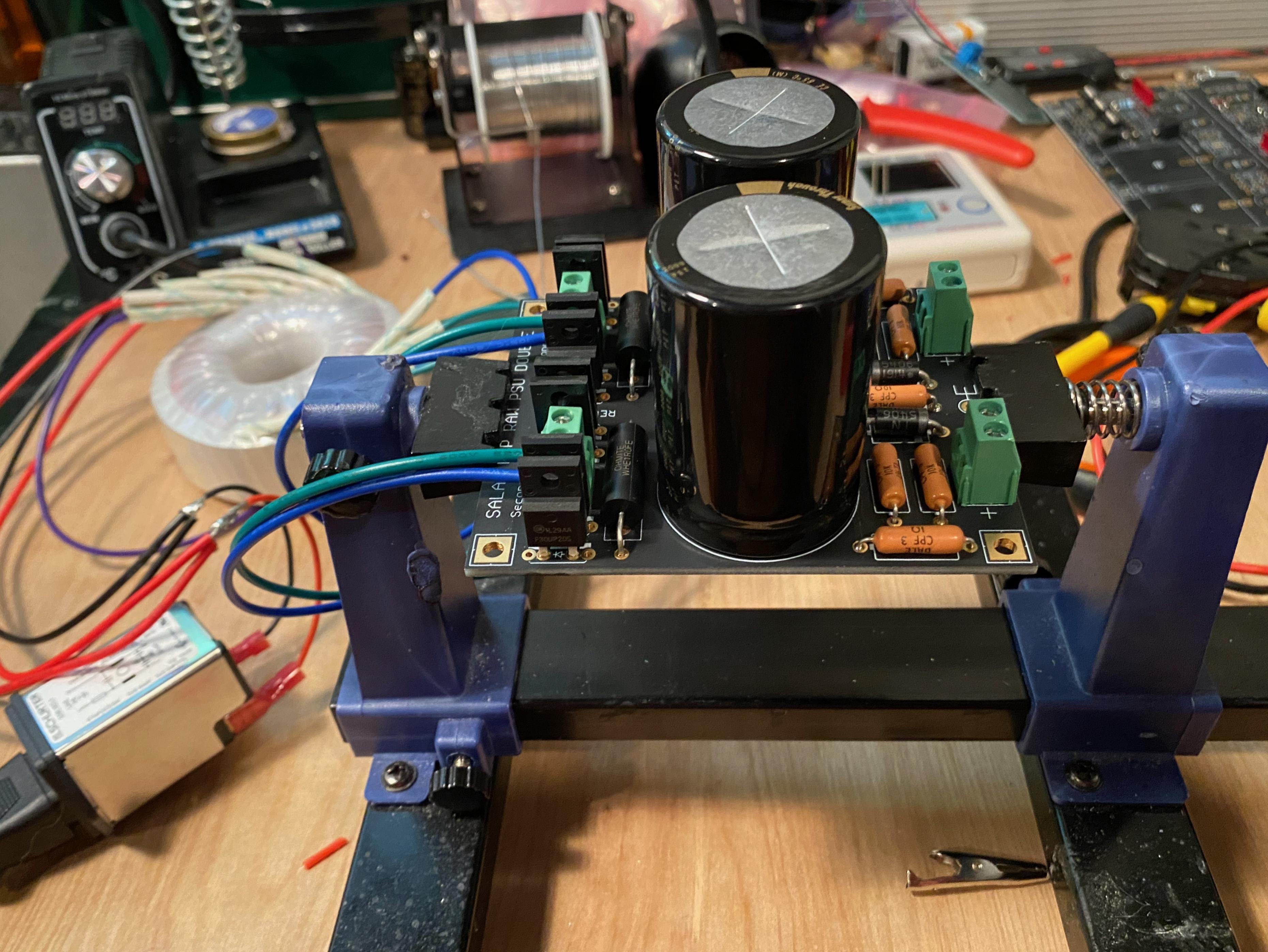

Moving along nicely here -- finished the Raw PSU. Using AS-0532 transformer, unloaded AC in @ 33.8v; unloaded DC out @ 45.6v.
Will move onto the main boards now that I have all the parts in hand.
I am working on some CAD files for drilled separate Modushop Galaxy chassis for the raw PSU and the main boards. I'll share them when finished.
