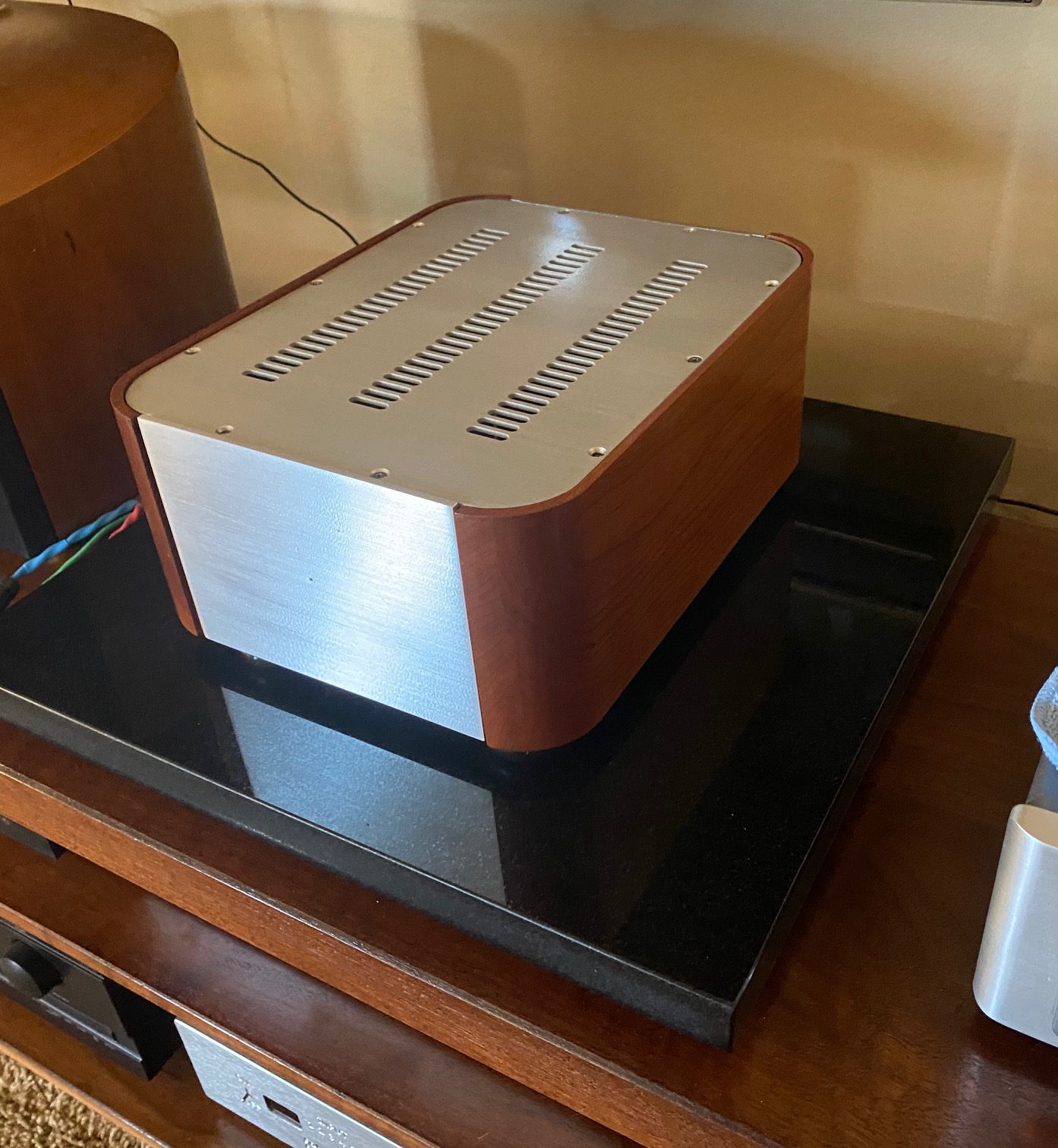

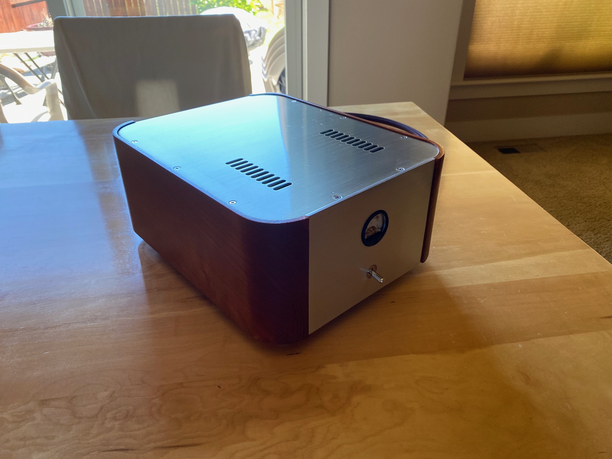

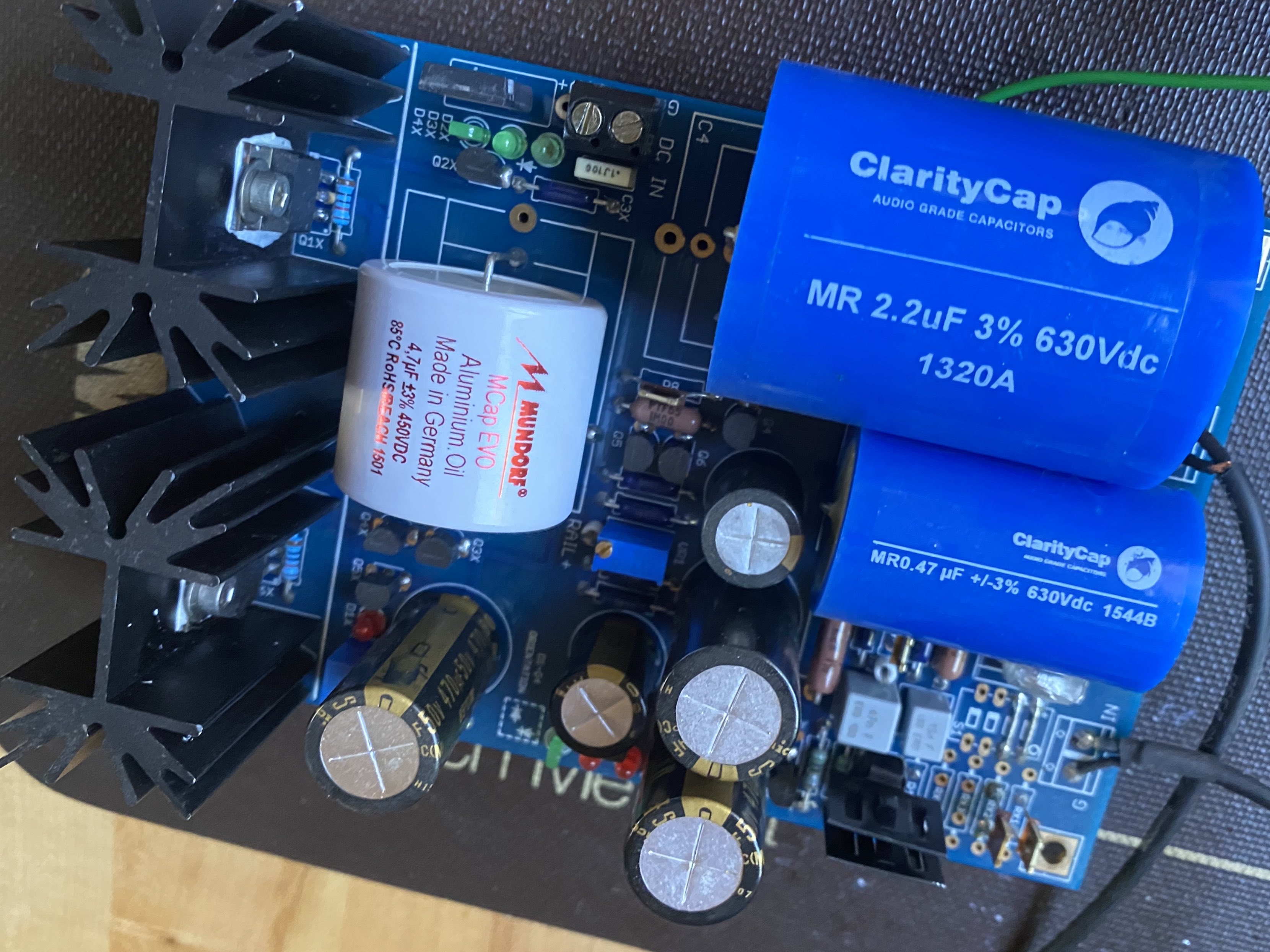

My C4 replacement is arrived and I swapped the damaged one. All is boxed. The only part that I’m still waiting for is my PSU front panel Voltage meter (not that is stopes me to start to listen to my phono). The one that I installed many years ago on that box is died. It was a cheap eBay item any way…. Please see attached images.

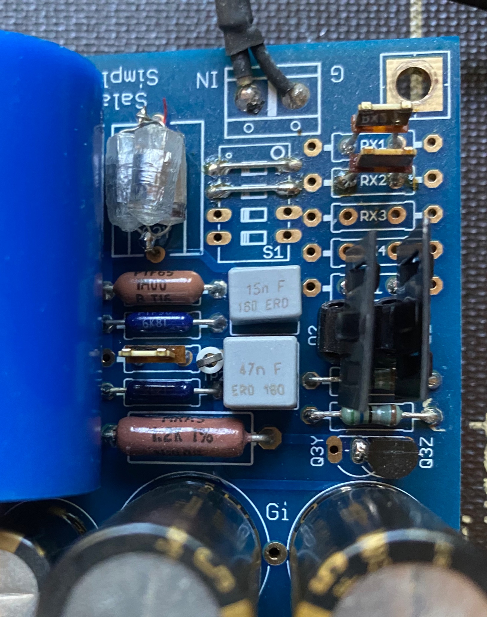

I made C2+C2Y test and ended up with 15.14nF (very accurately taken and via repeatable meter measured). Started with C2 alone and ended up my test roughly with 15. 6nF. Relatively hard to compare since it was sometime between swaps, but 15.14 gave me my full mental coherence and sensation of correct sound. C2 (14.89nF) alone as well as 15.6nF gave me some weird sensations and I felt for missing measures. As you know, all that is very subjective and might differ from person to person preferences, Also, it is related to system synergy in general. So, and as Salas indicated, the right tolerance for me is in-between 15.1nF and 15.2nF. My C2Y is combination of three of Mallroy polystyrene caps. You can see these on my images. Please also see wiring schematics attached.
It is very airy and more detailed sound. It is quite noticeable change compare to my classic Folded.

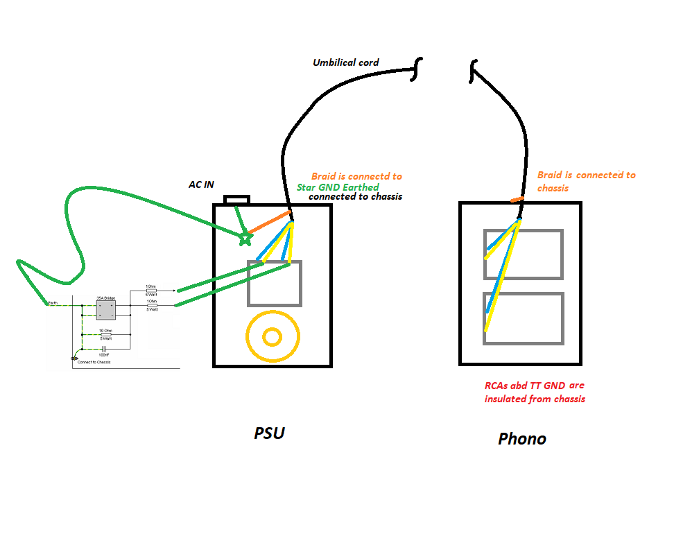

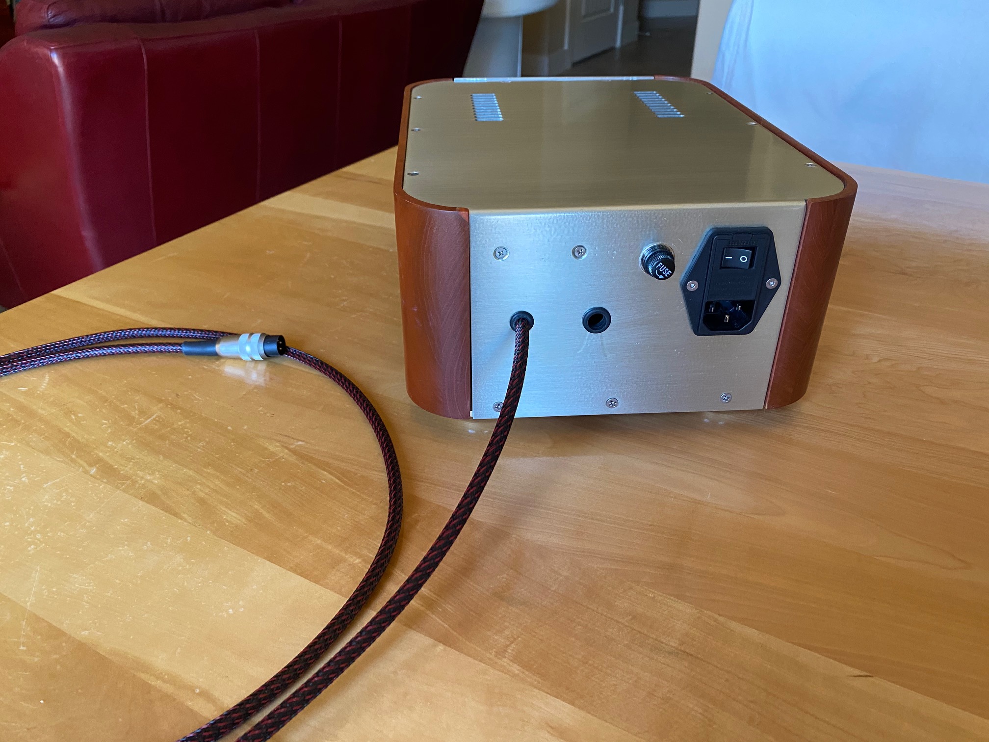

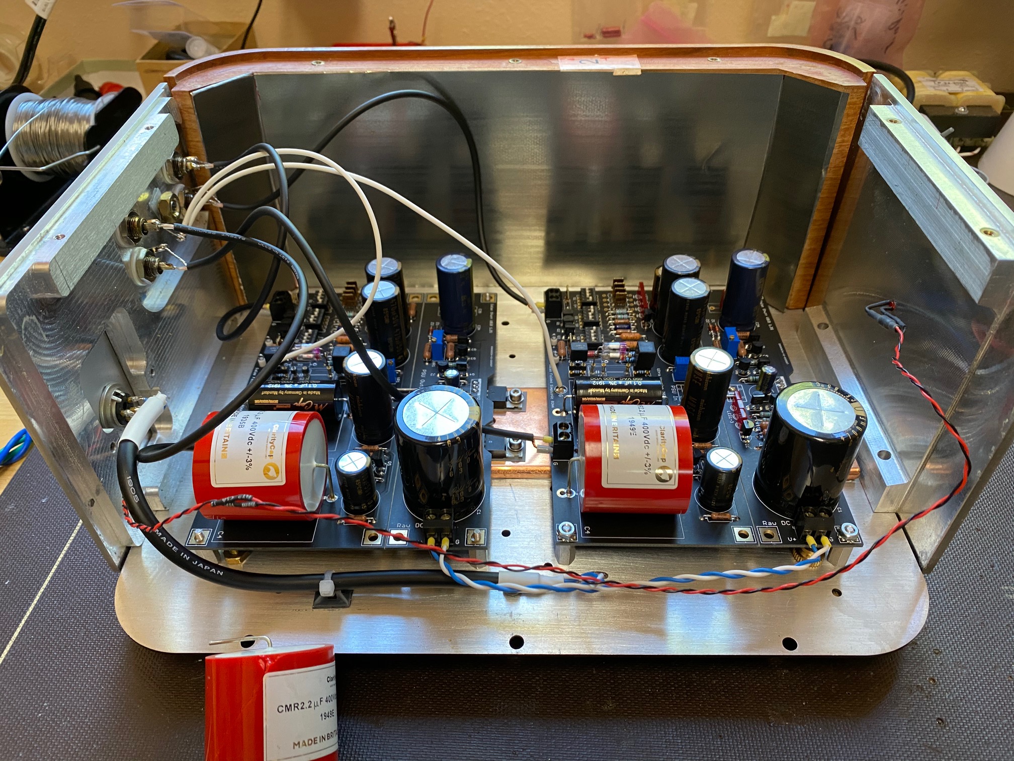

Beautiful! Grounding scheme shown is individualistic of course but it may also work for some.

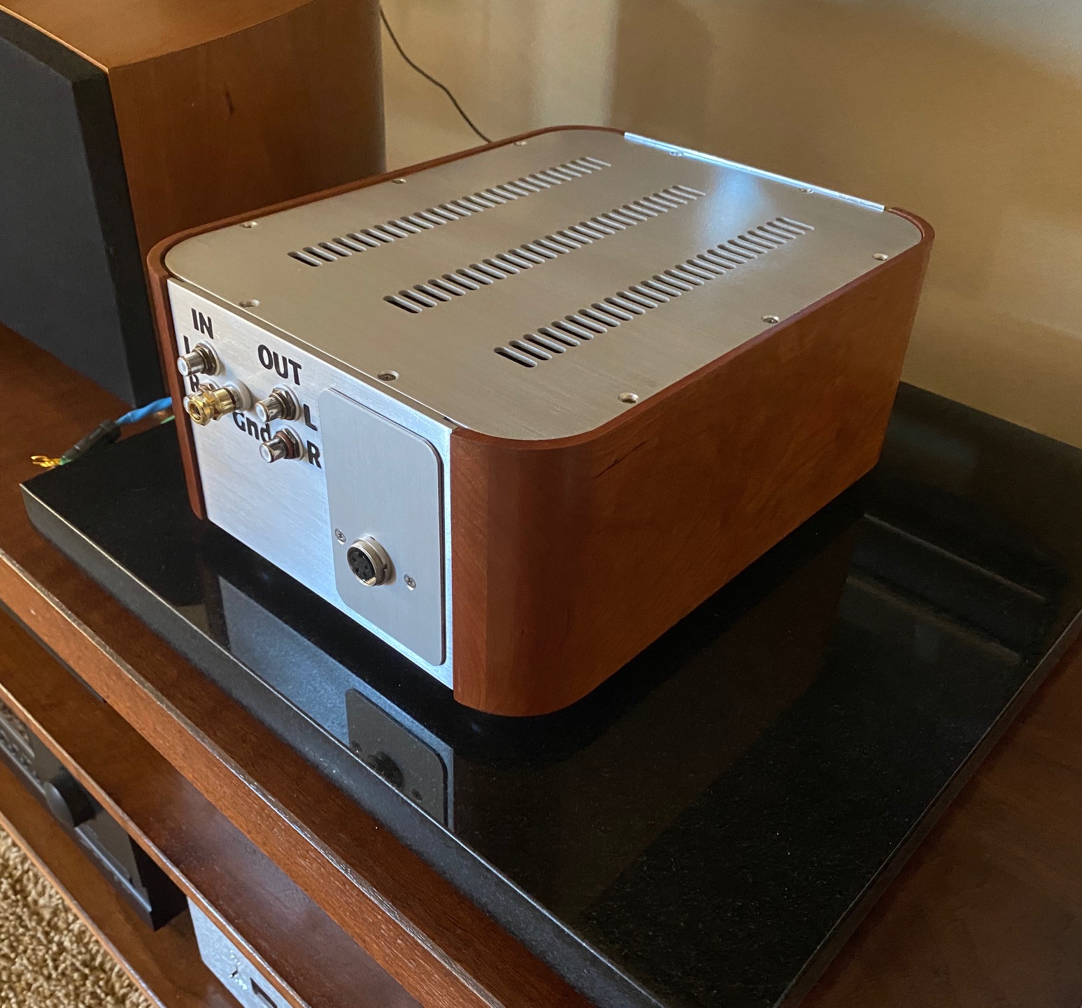

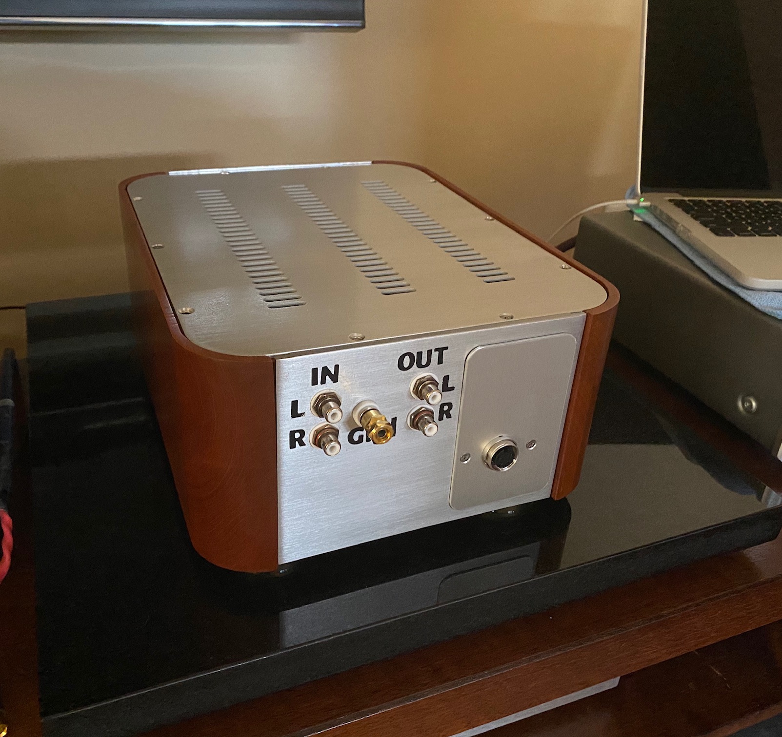

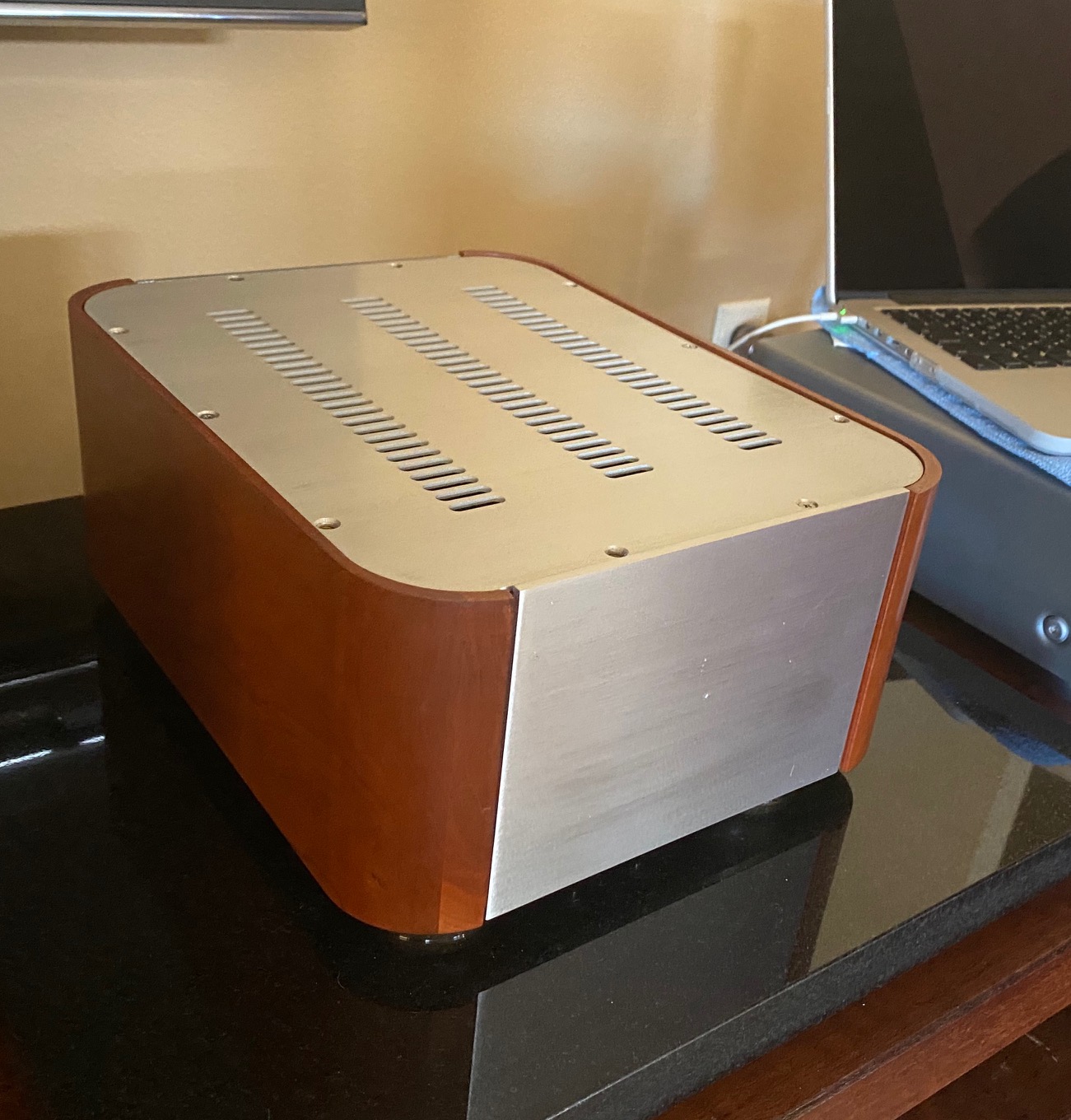

Ummm.... Gorgeous build. Did you do all the wood/mill work? Fantastic.
I purchased four of these raw material boxes about 10 years ago. It was some guy from Canada who made these woodwork from cherrywood. All milling/drilling is mine. I polished and stained this raw wood with Danish oil also 10 years ago. Thanks for compliment.
Thank you. Yes, and thanks for correction. It is only my way for GNDing. It might work for some and not for the others.
Some TTs ground best different than others indeed. BTW do you find this variation's sinking to floor choice better? Also the 1.3S PSU Vout drift logical for such a relatively high rail? I tried to improve on those practical things too given the all gains switchable redesign opportunity.
Yes, I do see that some TTs are use safety Earth connected directly to chassis (witch might set some Faraday) and tonearms are GNDed to it. Not in my case... My Wilson Benedch Circle One TT is connected to artificially made 120VAC with 90 deg shifted two sinuses. Body is made of some type of MDF. So, my tonearm with cart is totally floating for reference.
This is why I used suck GNDing way.
Floor sinking is very efficient method to dissipate heat from semi. We can use whole box as sink. No limitations for radiators sizes and etc. I see that as your genius design decision/choice. I used copper bar, but if guys uses 3mm bottom plate, then copper is probably not needed. I did not turned my unit off yet and I have about 34-36 deg Celsius on my bottom plate in average point.
I did not see any complexity (like huge swings) to set TP to 4V and drift was less dramatic than I remember from Classic Folded. I also like switches. Very flexible and accommodates variety of choices for all known needs.
Interestingly you ended up with C2+C2Y value alike the FSP average. Previous and new so far yet so close. Improvement not mutation. Did you hear any difference in bass and overall dynamics?

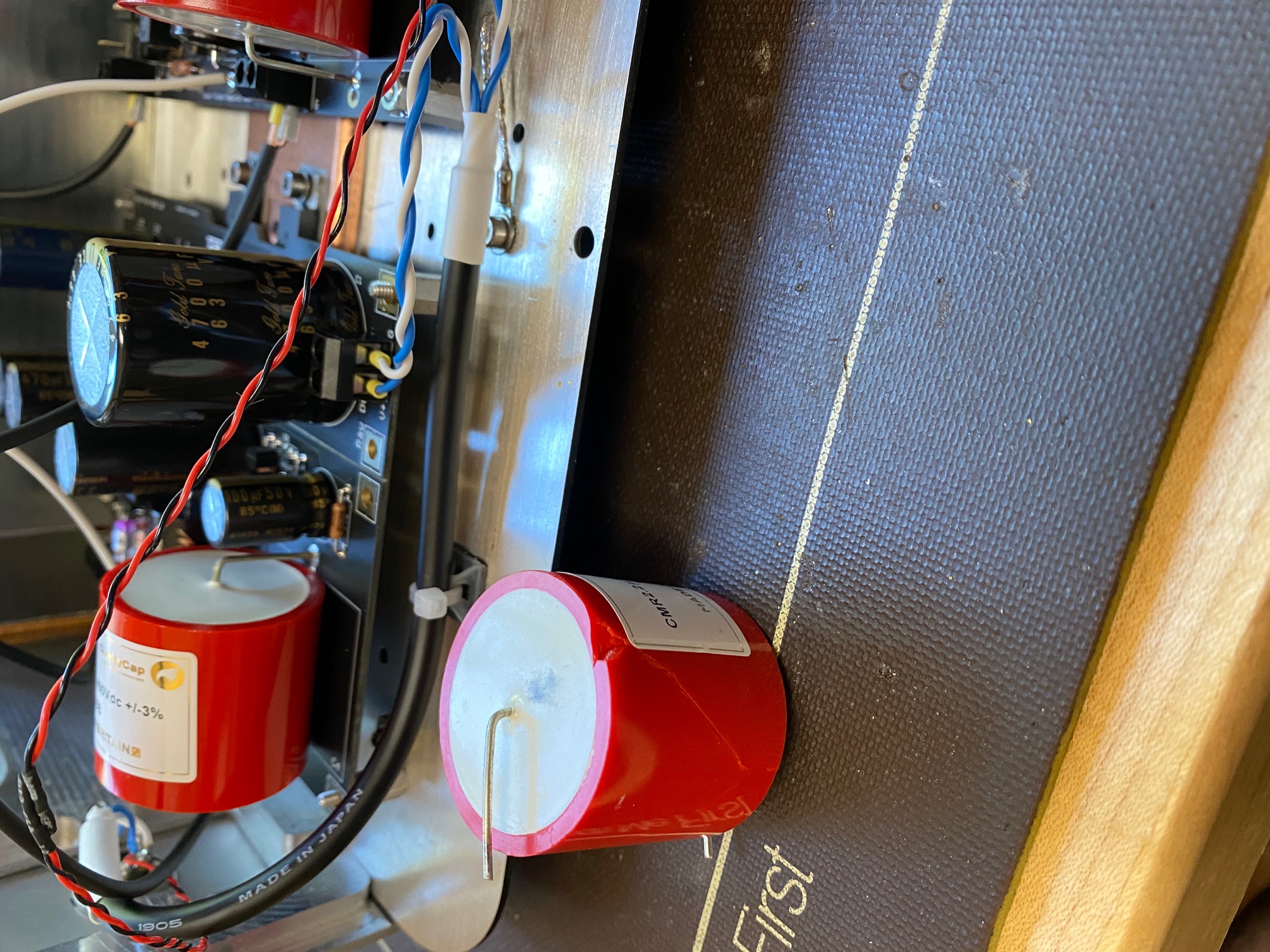

I used ClarityCap MRs, Mundorf’s EVO Al Oil, and Vishay’s.
0.47uF C3 you had in your previous maybe explains some rumble. It was in the directions you could choose between 0.047uF to 0.1uF.
