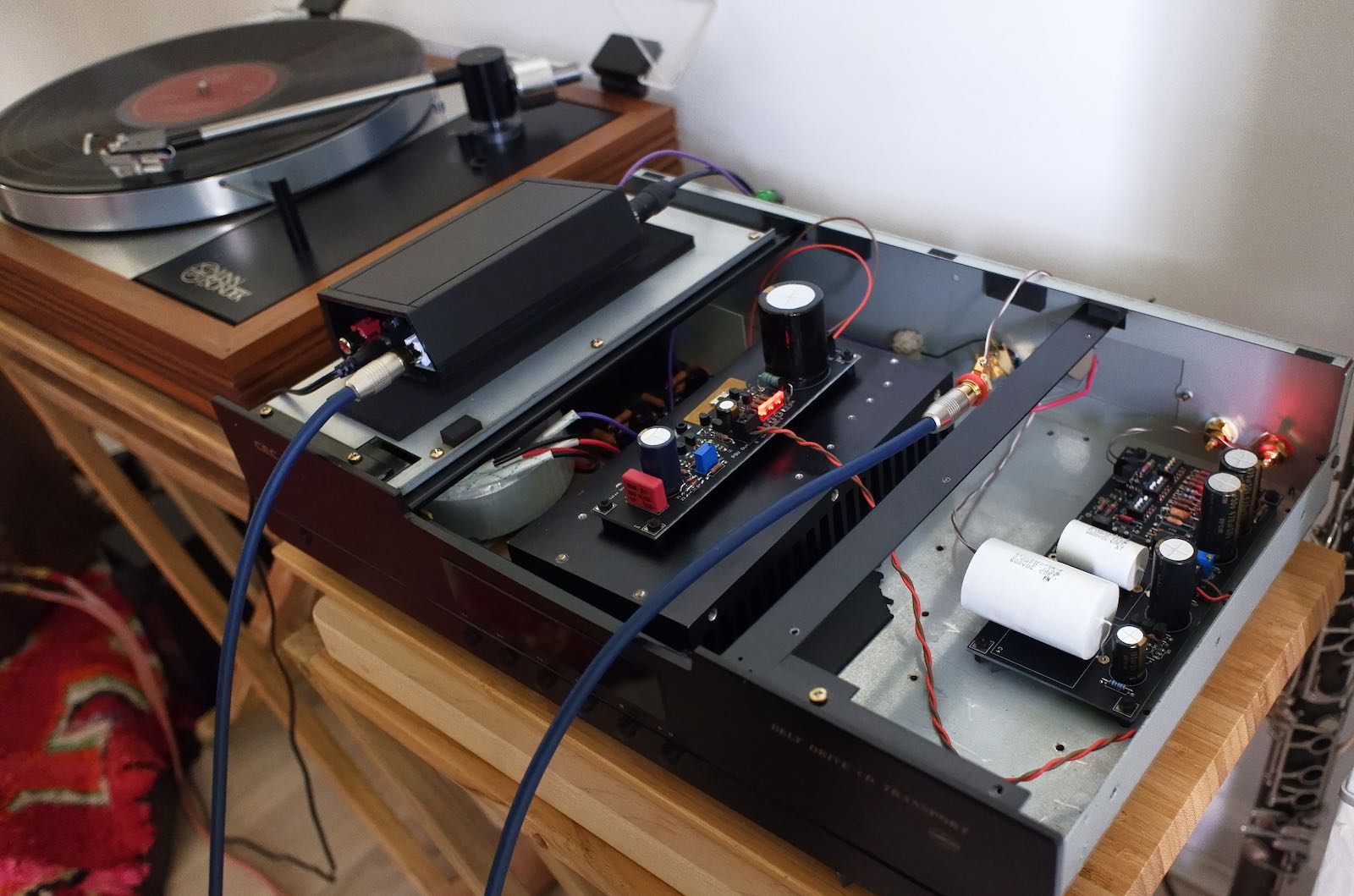

Hi all, I'm so excited I got to share a pic with you!
I just finished one channel of the UFSP and connected it, playing a very nice LP right now!
Currently right channel only, the left is still going through my Bugle 2 that this is going to replace.
I'm running at high gain from a Lyra Helikon SL (.22 mV). First impression is really good (but details later, it's hard to tell from my mixed debugging setup).
Noise seems minimal, certainly much better than the Bugle2, even without the proper grounding and shielding in place.
Thank you Salas and thank you Teabag for this wonderful design and carefully put together kit!

Hey, nice progress, now to the next channel. Try keep the shunt regs as close as practical to the main units in the final configuration. They won't need such a hefty sink, just the big chassis floor will do. What are those C3 C4 white film caps? CDE?
One channel up and running here as well.
Set the bias on the UBiB to 34v before connecting the main board, set the input load at 47K, and gain for 43db.
TP was 4.92v at start, dialed the UBiB down to 32.3v and the bias is steady at 4.00v with minor adjustments to the main board pot.
On this board, I measured IDSS of Q4 @ 9.39, Q5 @ 9.47, and Q6 @ 10.27 prior to install. Set R8 @ 54R and R11 @ 1.3K. Voltage across R10 is 23.4v and voltage across R11 is 11.68v. Should I increase the value of R11 to get closer to 14v?
C3 is a .1uF FT-3 and C4 is a Solen (both of which I had on hand). Once everything is boxed up and running, I’ll start rolling some caps. Thinking a Miflex KPCU for C3. I haven’t used the CMR before, so I’m leaning toward getting a pair for this build. I have some Mundorf Supreme 2.2uf in my Valve Itch so I’ll probably give those a roll too if all goes well.
I had really hoped to put the amp in a 1U chassis, but it’s gonna be real tight. I purchased the shortest electrolytic caps I could, but it’s going to be challenging keeping under 40mm high I think with C3/C4 on board.

I can't make the numbers work for a 1U chassis with the sweet caps Tea included in the kits (all tall caps slightly over 40mm). Plus I have some fancy-ish Clarity caps that will break the height. Non-ultra version is totally 1U-able with shorter heatsinks. So it's a 2U or custom (or sourcing all new sub-30mm caps and same height restriction for C3, C4). (my personal build will be custom around 50mm-60mm height all in).
Question: Are the LED array values for Ultra the same as previous version? I don't see it noted anywhere that the voltage references are different. Tea included a bunch of red LEDs.
