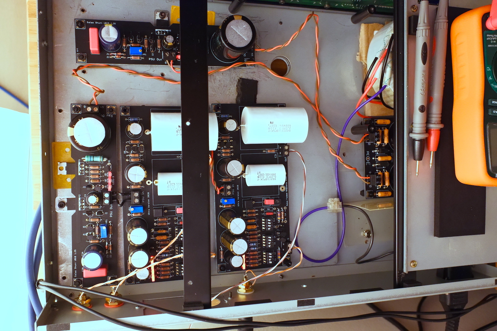

I can’t imagine anything bettering the Valve Itch, but I simply couldn’t resist the opportunity to build a UFSP. I can’t wait to compare them side by side, and it will be nice that the UFSP will be ready to support low output out of the box (which will of course put me in the market for a SUT for the itch)...it..never..ends...
I finished the other channel on Saturday and spent most of Sunday listening --including a little Led Zeppelin retrospective following Salas' post...
The discussion on the choice of C2Y came just at the right time! Teabag measured C2 at 14.93nF for me, and tonight I added 220pF from the helpful little bag of C2Ys he's included in the kit -- wow, that gave just the right last little edge towards clarity and transparency -- it's pretty amazing, am very happy.
I'm surprised how little heat the MOSFETs are producing. I expected something more like the DCB1 Mez, but no, there's almost nothing. I'm using a re-purposed chassis, and basically put the MOSFETs where I could find a tapped M3 hole -- I didn't even screw down M1 which, surprising to me, even then isn't getting hot. This way, I didn't have to drill or tap any holes at all!! yes, I'm lazy -- until I'll clean everything up later.
I'll listen for a few more days and try a few things. I don't have a grounding scheme yet and also will partition off the power supply -- but it is already pretty quiet.
One thing I'm trying to understand is how the bias is wandering around, starting at 5.3V when switching on and then random walk around 4V +- 0.3V, basically. I'm trying to understand more of the design, started to read from post 1, but if you guys can point me to maybe a discussion or walkthrough or circuit description, I'll be very interested to read up!

Hi, nicely done up to now. :up:
There's a circuit description link in post#1 named how it works. Q1 Q2 bias goes through warm up time of thermal stabilization when starting.
M1 is lukewarm when RawDC Vin isn't too high. VDS M1 is Vin-Vout. Dissipation Watt M1 is VDS*CCS (100mA for R1 5.6R standard). If you hot-rod CCS mA a bit (145 mA with R1 3.9R) the diss W goes quickly up. For M1 and mainly M2. M2 is shunt to the load burning excess mA at 34V level. Each channel with both Q1 Q2 engaged is about a 36mA load.
You may confirm your shunt regs correct mA settings by measuring the voltage drops across their R1 and then dividing it by R1's value in Ohm.
