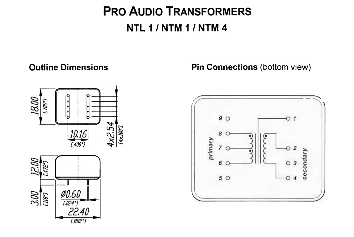

SUT= Step Up Transformer. Good ones are costly.
I'm playing with the original Simplistic, set up for high output MC. Recently I replaced the Denon 160 (1,6mV MC) for the Yamaha MC-9 (0,3mV MC). Therefor I installed two Neutrik NTM 1:4 step ups. Great combination on a lightweight tone arm btw. Since then I'm picking up static from telephones, on both channels. Any insights on a cure?
NTM4 - Neutrik

That's a split primary step up for XLR connected mics so its pin 7 may needs see ground? And is the metal shell showing continuity with the screen pin 1 or it needs an extra ground wire for the shell? Do you use shielded coaxial in general?

I tried several grounding variations, now it's making an extra popping sound of circa 5Hz, haha. I'll have look at daylight again.
I use RF coax for input and some low capacitance coax from an old tape deck out. Maybe it's the shielding, with the Denon it was fine.
