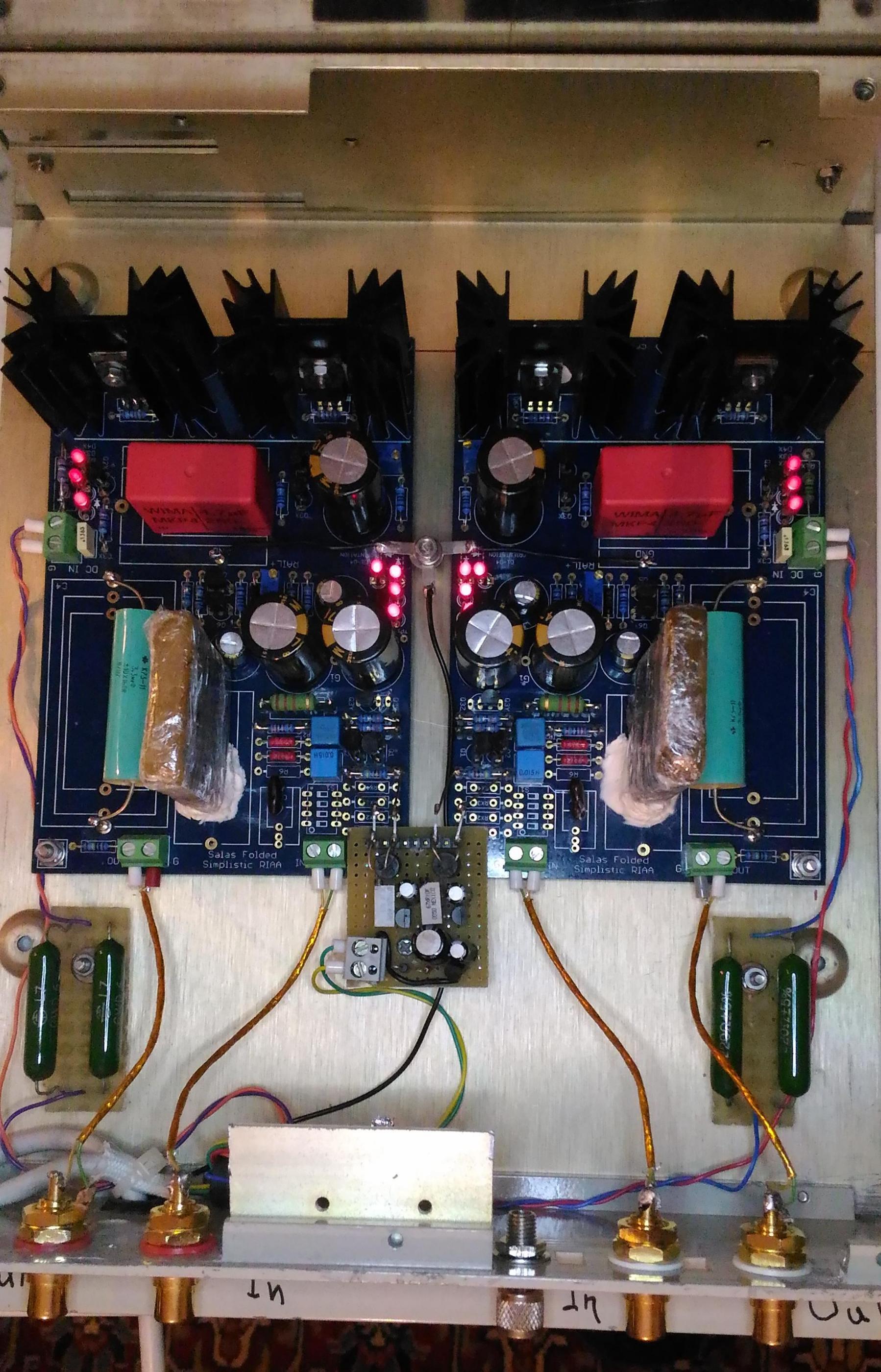

Here some picture of my low cost build, I use the Paradise pre-regulator .

Nice orderly build. Well thought out minimal distance GND "T". What is the perfoboard in the middle for? Maybe variable loading with LDR? Using a handmade interstage wax capacitor also? After some more use the whole thing will open just a bit further due to the electrolytics shaping up.
Compact and sweet. Congrats.
How do you like it after enough months? Something else you meanwhile changed in the system? Or still MM as it was set for a Nagaoka?
Thank´s Salas!
I like it very much! Was little afraid about hiss or hum when put the contruction in boxes but no worries here:) Dead quiet even with my ears close to membranes. No other changes yet but curious about 2 or 3 steps up in Nagaoka series

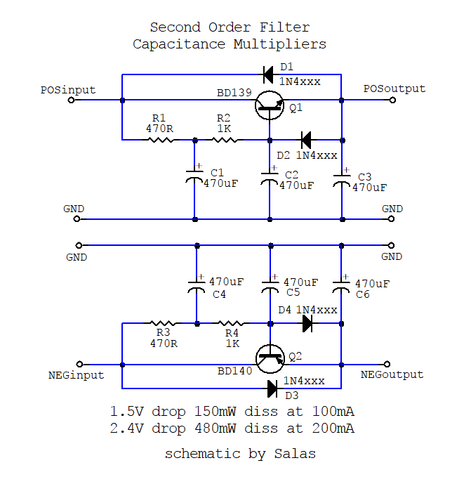

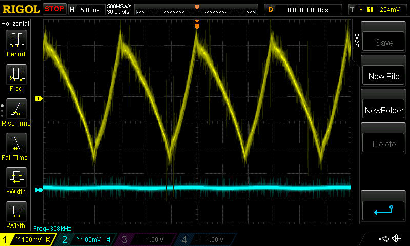

Here is some info for people who would like to try further V-ripple suppression on Raw DC part of our FSP.. Salas introduced it awhile ago and I tested it last weekend. FSP shunt regulator is not sensitive to high capacitance input, so no issue to use such device when you multiply C by BJT’s gain.
Please see results attached.
Vin – 25VDC with about 300mV ripple
Load – 90-100 mA
For such load, I see V drop is equal to 1.4V.
Yellow trace is input and Blue one is output from Cap Multiplier.
Sorry for high frequency noise. I used regular x10 probe with regular pigtail GND connector with crock. Unfortunately, it was impossible to use tiny-sprig GND connector with my perfboard.
I’m looking for volunteer to create Grabber files for Capacitor Multiplier PCB manufacture. Would be nice to get two multipliers on one board with possibility to connect them as double “mono” (+/0; +/0) or bipolar (+/0/-), As I say, would be nice have flexibility to reverse Caps and use BD 139 instead of BD140 in negative side.

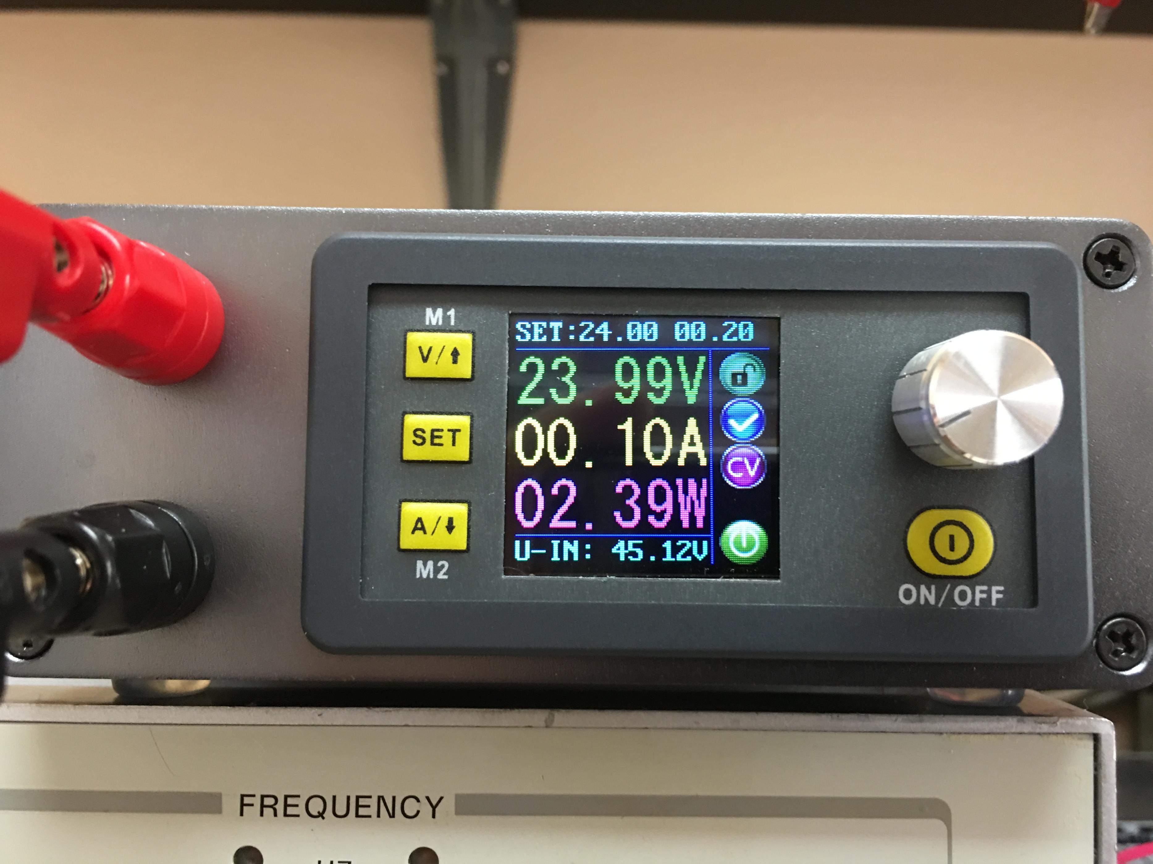

Nice cheap and handy switching PSU modules for general use those. But very noisy indeed. This multiplier did a great ripple eating job at 70kHz as I see in your scope's picture. The second order type has usefully controlled output impedance in the HF too. It skyrockets in high frequencies for those with just a resistor and a cap.
