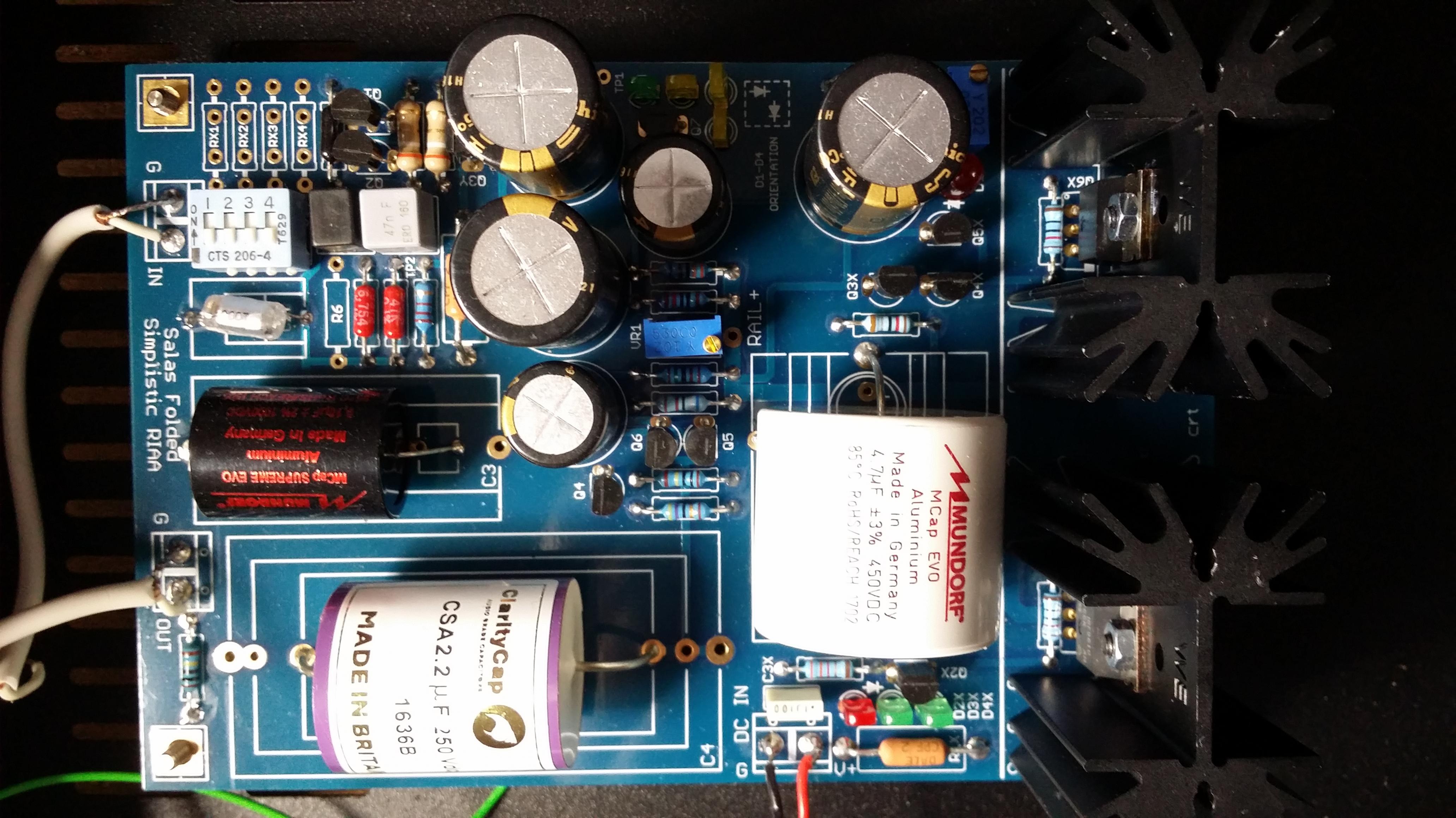

That's 1% matching. Not bad. You probably tested with less than 1mV RMS because the gain with double K369 is >1000. Unless its an MM configuration build that has x100. In general for DC checks have about 4V TP2 to GND, about 10V Q4 Drain to GND. 10-13V across DS of Q5 or Q6. Usually the more is across Q6.
*Check that R8 and R10 have the right values (6.8K & 47R)
We have guests this weekend so very limited time. I intended to build with maximum gain for my LOMC Denon 103pro, unless I've missed something. Another photo attached in case there's anything obvious. I'll check the gain again, but the volume sounds about right, not a factor of 10 out anyway.
The colour bands of R8 and R10 check as 47R and 6.8k.

Impossible to have good volume with a Denon 103 and having the wrong gain. An experimental error during the signal test most likely.
So the resistors are the proper ones. I was just wondering about that R10 voltage drop difference you mentioned at first so that is why I told you to have a look in the resistor values.

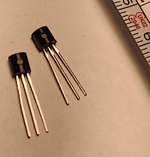

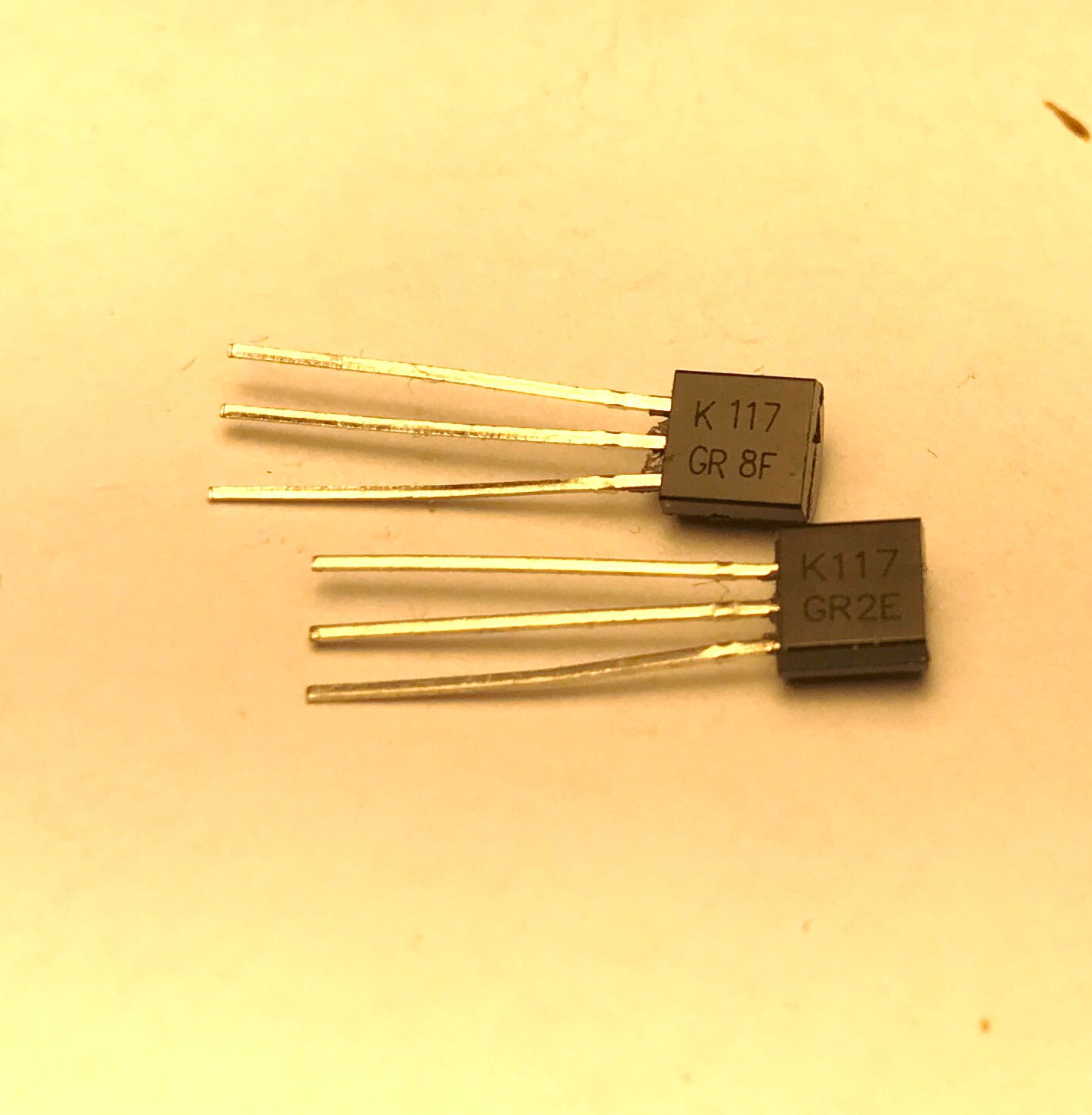

K117GR above 6.5mA are not in Toshiba spec. In general they don't average towards the 6.5mA upper limit in a random bunch either. Possibility for fakes. Post close up pictures of them before we discuss how to allocate placements.

Photos attached. i bought a batch of 20 a several years ago (I don't recall where, but probably eBay) and another batch of 10 on Amazon 2 months ago. I thought there would be a chance the latter would be fake, but I thought the older batch would be ok.
You have to watch for the sharp, laser cut writing now. What you are looking for are slightly messy stamped information with a date code that makes sense. Another warning are compliments that have the same date code. That doesn't often happen in real life for hobbyists.
I often buy test batches from Ebay to see how bad things are. They're pretty bad out there. If you can find a current transistor that will work, use it. The promise of lower noise and higher transconductance won't be found in the land of fakes.
I really miss the good 2SC1775A and 2SA970A transistors. I used to use them all the time. Now it looks like surface mount stuff is the last good supply of devices.
-Chris

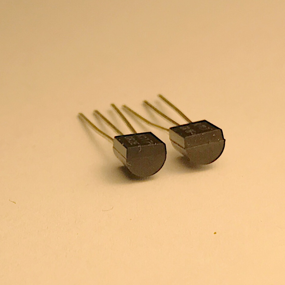

I checked my records and the seller i bought from on eBay is in the US. They are still selling them. Maybe I am measuring wrong. I will post a picture.
The resistor is 100R.
What's that number on the Fluke; Its dark. Is it 832mV? Means 8.32mA when across 100R. No way for a proper K117GR. Your connections on the breadboard look right for the purpose.
