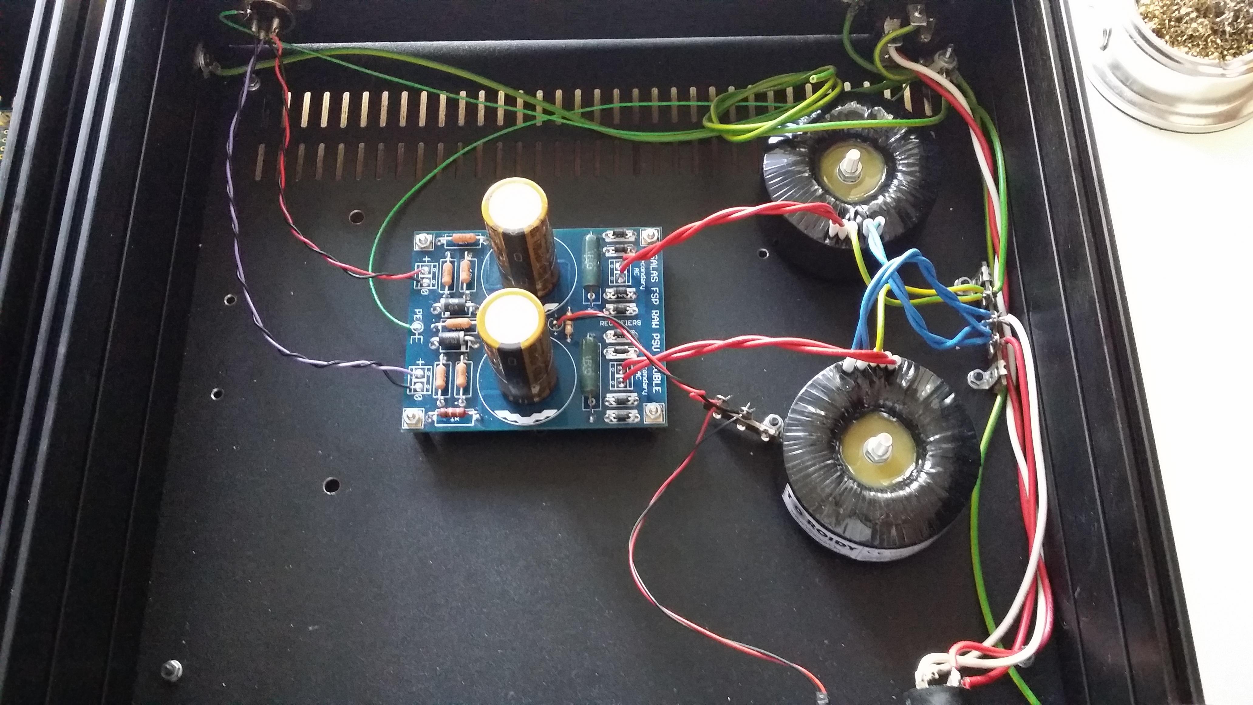

I finally powered up this morning for testing but despite Salas' warning I've still managed to switch the polarity of the raw DC-in to one of the channels :-(. Quite how I did this, and then didn't spot it is beyond me.
The fuse blew quickly so I reversed the wires and tried again. Voltages aren't bad: B+ ~34.5V for TP1-TP2 of ~3.6V, with a little difference between channels.
So relieved I hadn't killed the reg I plugged in for a test listen. Sadly it looks like I've killed the audio circuit though. The channel that is working us settling down nicely...
I'm going outside now to give myself a good talking to. I'll need some clear time to troubleshoot but any suggestions where to start looking? Maybe it's easier just to replace all the silicon???
I've attached a photo (hopefully) as we all like to see what others are playing with 🙂.

Check and compare the drop at R11s between good and bad channel first to see if you have killed the output stage (Q5 Q6) since the input stage biases up normally. Then compare the drops at R10s to also see if the intermediate stage FET (Q4) is alright.
Thanks Salas. Drop across R11 is pretty similar - 11.82V (good channel), 11.92V (bad channel).
R10 is different though - 24.40V (good), 30.20V (bad). So it looks like I've killed Q4? Perhaps if I ask Tea nicely he might have a replacement.

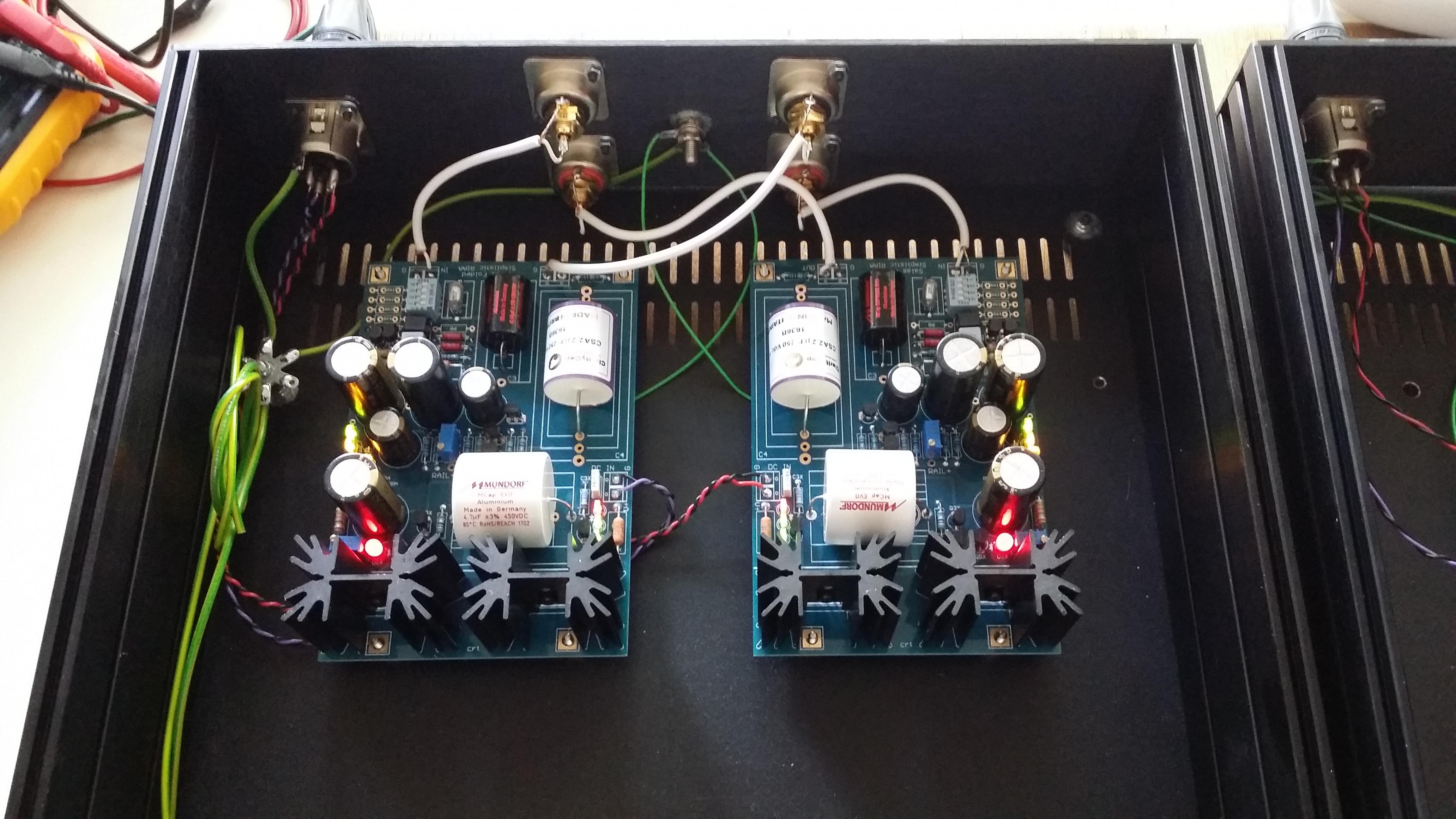

Hopefully some better photos attached this time.

You probably killed Q4. Beyond doubt so much drop across R10 in the bad channel is wrong for this circuit and its Q4 must be replaced anyway even if not burned. The one in the good channel that's pulling for 24V drop is showing correct drain voltage for 8mA IDSS and the R8 R10 values as listed i.e. about 3.5mA pull after the source pin resistor's degeneration effect.
Another easy test you can do before concluding nothing else needs replacement is to compare RDS for all JFETS between the two channels. Q1 VS Q1 and so on. In power off state you measure with the Ohmmeter between drain and source pins for each. No need to remove them from the PCB for that.
Also don't forget to measure drop across R4s and Vbe of Q3s in power on state.
Your construction looks nice in general. Good capacitors also. What type is C3 exactly? Don't know about the ground wiring, seems bit complicated or long. But if it will work with minimal hum so be it. Now you have true repair priorities.
Thanks again Salas, I'll check when I'm back home. C3 are Mundorf Mcap Supreme Evo. They're not great photos - taken on my phone.
The earthing is a bit of a mess and I think I'd do it differently if I were building again. I was trying to ensure all the case pieces were bonded, but it didn't occur to me that the chassis is at circuit ground too. There was a smidge of hum, which could be the earthing, but it could also be the arm wiring which isn't shielded. I might replace the 4 way connectors with five way and have separate chassis earth. One problem at a time.
