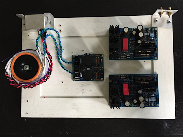

So I finally got everything together and powered up. With 27Vdc on the rail TP1 is 7.9V.
R2,3 should have been closer to 9r but 10r was the closest available in TNPW.
Q1,Q2 were labeled 13.84.
7.9V across four leds
R13 1.2k with Q1,2 populated.
Now for the big questions........
If I replace R2,3 with 9r will TP1 become adjustable within the recommended 3.6V range?
What does VR1 resolution adjustment do?

You don't want TP1 3.6V, you want TP1-TP2 to be 3.6V. TP1 is the positive end of the chain of 4 LED's, so it is 7.9V above ground. TP2 is the junction of R14 and R4 (took me forever to find it), it is the voltage on the collector of Q3. The 3.6V measurement is the base-collector voltage on Q3.

47Vdc in, TP1-TP2 7.9V, rail voltage maxes out at 27Vdc (VR2)
The manual says 24-27Vdc rails.

The build guide for this circuit says the rail voltage should be ~35V. Many of us have found it needs to be a little lower, like 32-33V. Where did you see 24-27V rails?
VR1 basically gives you finer control over front-end rail voltage to get the TP1-TP2 voltage right. If TP1-TP2 is 7.9V (TP1 higher), and your string of 4 LEDs is 7.9V, then the junction of R4/R14/Q3 collector is at 0V. I will let someone smarter than me figure out what that means. Either way I'm pretty sure your rail voltages are too low.
What is your voltage drop across R2 and R3 (i.e., how much current is going through Q1/Q2?).
That was buzzards. I swore that it said 24-27. But you are correct, I am 10v low and there's no voltage drop because the voltages are way to low.
If VR2 won't get the rail voltage higher then you either need a higher R3x or a Q3x with a higher Idss.
