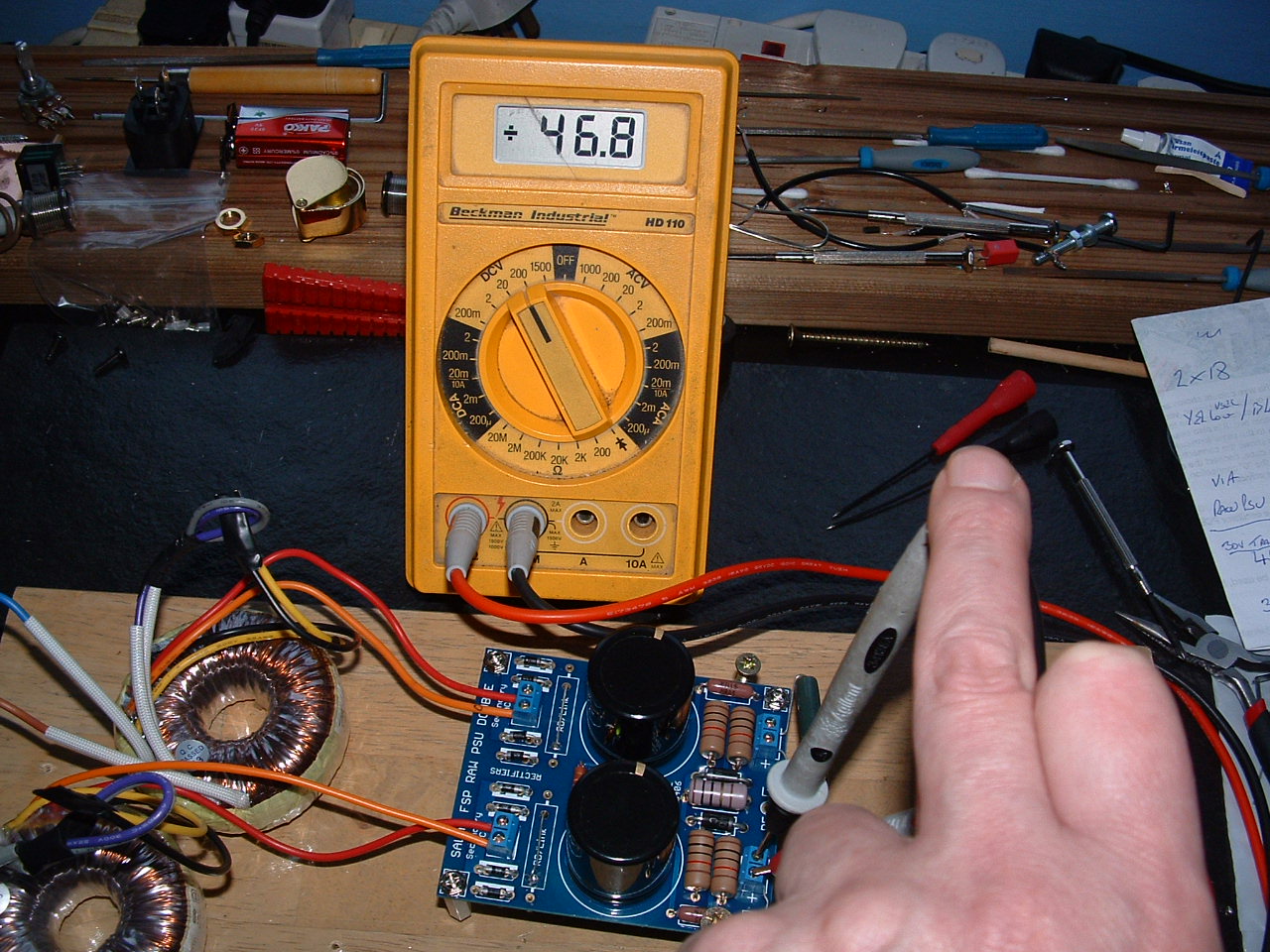

58V can damage the phono's on-board regs. I suggest you use 470 Ohm 10W dummy load resistors to load each RAW PSU board's output so to measure VDC while the transformers are comparably loaded to final phono loading.
If it is more than 50V put 20 Ohm 5W RD/LINK resistors on the RAW board designated places to drop the VDC. Remeasure while on dummy loads. If VDC has dropped enough (at 45V-50V), power off & disconnect the dummy resistors. Its modified & tested now for proper RAW DC voltage level when the real phono channels will get connected to it.
Hi Salas Hope I have done this right came to diyaudio late in life so don't know a lot ,as per pic ,fitted 470 ohm resistors as dummy load and dc is now 46 so do I need to fit any resistors to rd/link ,,,,,,,, john

No you don't need to fit anything, obviously those transformers being small are showing a large difference between loaded and unloaded. They must have gone near nominal secondary AC values now because they are designed for UK mains. Measure AC voltage input while loaded to double check.

Maybe in full VA loading they would drop to nominal. But its very difficult to get them hot or dropping while loaded lower. In our level of use they behave like nothing happens versus various others toroid and EI that I had.
Set the Lab PSU for 150mA CC mode per phono channel. It should read about 100mA current draw per channel on CV mode and not go to CC limit mode if all is well. That is when feeding at the regulators inputs. Good luck testing.
