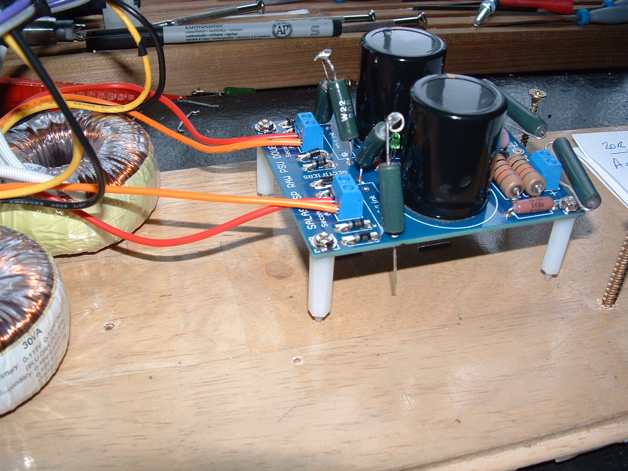

I roughly calculated 20 ohm when you talked 58V initially and I thought of 10 ohm when you found 55V. But put 20 Ohm which is safely more drastic and measure the loaded result. Its not easy to calculate spot on for various unknown in detail transformers. If it results over 42VDC is acceptable and if between 45VDC-48VDC most nice.Hi Salas Did you mean 20 ohm as an previous post which I have some coming tomorrow ,, fingers crossed ,, or 10ohm

Resistors came today (20ohm) so fitted and my volts are with load resistors fitted ac 43,,,dc 49.6 without load 57/58 vdc
I wanted to get it down a little more to Salas 45/48 most nice area so I added 4r7 wirewound to 20ohm which gave me ac 42,,,dc 47/48 with no load 56.3 dc.
I hope that's it
I hope that's it
So it worked. 49.6 is still nice but 45/48 leaves space for the odd little higher mains hour.

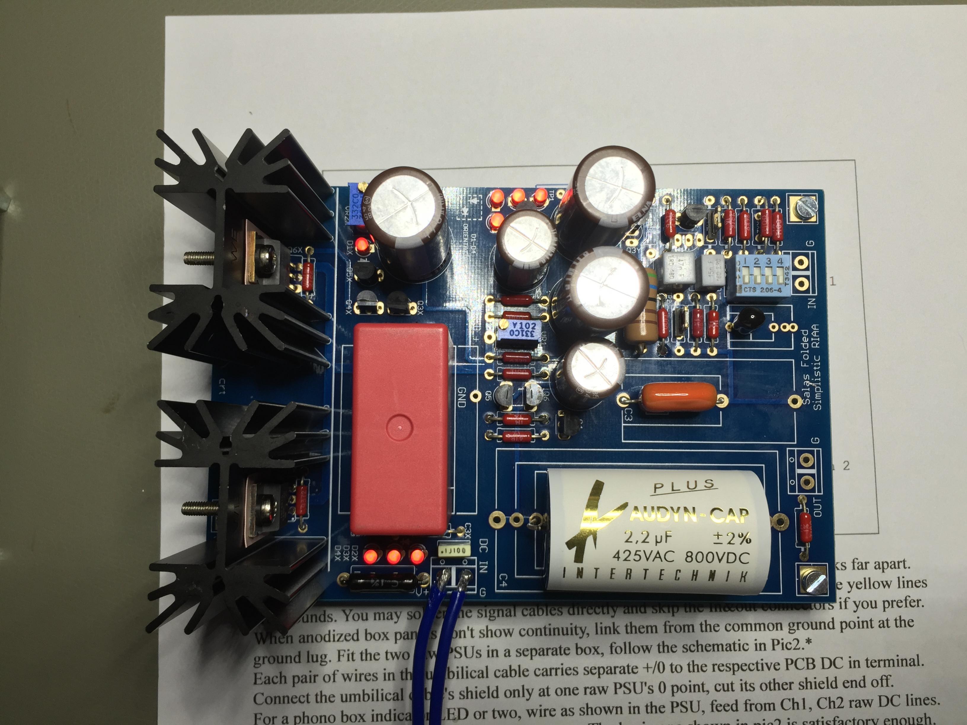

Yes spot on Salas, so need step I put it together and switched on no problems all leds on looking good 😉 but ! rail and gnd only measure 30v/32v and vr2x is at max
So reading guide and an old post I switched resistors r3x from 9.1k to 6.2k and r6x from 22r t0 33r doing this should raise volts Wrong opposite happens 22v/23v .🙁
Looking at that I should increase .Please advice
When you can't reach 35V+ with R3x 9.1k it means that Q3x is from a low IDSS range and you should compensate with higher value R3x than what is now installed. That resistor with VR2x (in series) convert the current provided by Q3x to voltage. Q4x and D1x contribute 0.6V+1.8V and the rest comes from the resistances. So either add 2.7k in series with 9.1k R3x or install 12K in its place. That should do it. Because it looks like you got about 3mA @ 10V IDSS Q3xs that do about 2.5mA current under 0.6V they work in the circuit. On the other hand its good because low IDSS ones have lower Vgs (off) and work better under low VDS voltage (Q4x's Vbe that is)

I am testing the boards on a LAB supply now.
Power into the amp boards is 44.2VDC. My LAB supply will not go any higher.
I see something strange. One of the boards will not go over 26.5VDC Rail. And the TP1/TP2 reading is 5.5VDC.
The other board has no such problem and can be tweaked as dicribed in the file. 3.6VDC on TP1/TP2.
What could be the problem?

Its possibly having a low IDSS Q3x in the low rail channel. Just like Lucylu only not in both. At least this is a typical condition I suspect first. Add some value to its R3x to confirm. Something like 3.3k extra. If its so, either install a stronger Q3x or keep the R3x higher value that you will find enough. BTW what is your C3? Orange Drop PP?
