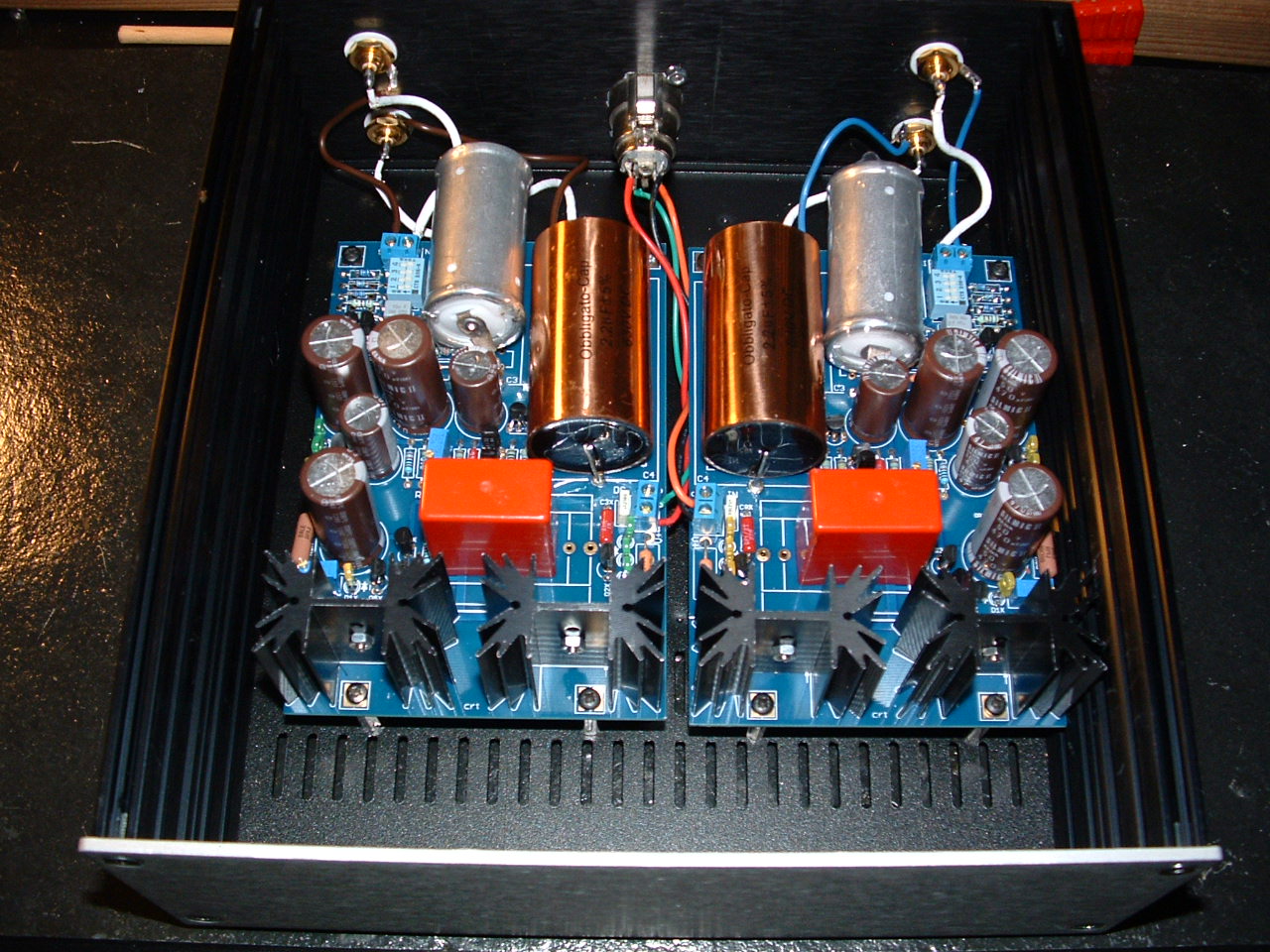

I have had this working for a few days its a good one allright, but the left channel is weaker than right not a huge amount I can also hear very slight crackle when I put my ear to speaker
Has anyone any idea where I should start to look cheers

Make sure that the undersides of the PCBs are fully clean from flux residue. Flux can make a high impedance JFET gate unstable. If that one check proves unrelated check the voltages from drain pin to ground across all JFETs in case one has significantly different voltage than its sibling in the good channel so it draws different current and replace it. If nothing like that happens, try with another C3 in the left channel first just to make sure its not about a dud NOS USSR sample. Also the metal capacitors bodies should not be in contact to alternative size capacitor pads located underneath them
