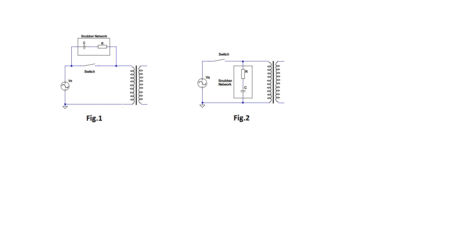

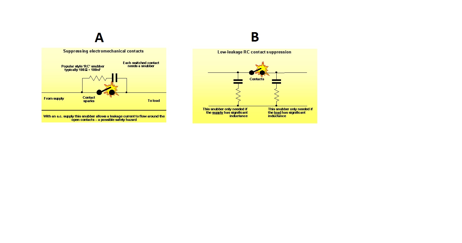

Any way, I couldn't find any RC device encapsulated in one body for arc suppression. Ton of articles, but not ready to use devices. It might be easier to build it and please help us to calculate resistor value based on 0.01uF Vishay 338 or F1778 caps.
Andrew, you created intrigue about RC snubbering across main power switches usage and did not advise about any practical parts to use there. Please close the loop.
search google.
"switch spark suppressor"
The wiki shows what the arc is
The next 3 show typical RC snubbers.
The fourth is a propriety "secret" product.
then the pics are quite informative.

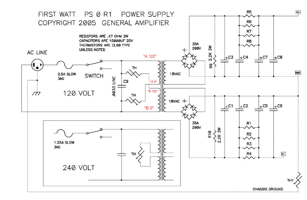

Based on what I saw, BKM is to use snubber parallel to the trany primary winding right after main switch (Fig.2). Parallel connection to the main switch (Fig.1) might introduce some small current (leakage) trough cap and resistor when switch is in open position.
Also, I do see that Nelson Pass used 0.033uF and 10 Ohm Thermistors in his First Watt amp PSU in position pictured in Fig.2. So, beside over-themp, this thermisrors are created RC with 0.0033uF cap. So, same method as in Fig.2.
Please comment.
Please comment.
I am not sure, but I think the two arrangements require different R values.
The Illinois link gives a pair of formulae, but does not say they are different R, so maybe they are the same.
http://www.google.co.uk/url?sa=t&rc...w-Kz4fFYozCkSQg&bvm=bv.95515949,d.ZGU&cad=rja
That previous post has a link copied from Google. Is there a way to simplify the link to take one straight to the pdf page?
No. it is completely different.same method as in Fig.2.
The Pass capacitor is straight across the L&N of the mains. It is an interference attenuator. It combines with the source and cable impedance to create a low pass filter.
The CL60, one on each 110/120Vac primary, is a permanently in place soft start for the transformer. Better to arrange an automatic time delayed bypass of the added resistance of CL60 in the primary circuit .

After our discussion and after reading relevant articles, I desired that it is portably better not to use any arc suppression snubbers or caps on our low current devices.. They might create more troubles than to solve issues. They more needed on high current relays when on/off rate is high. Nick, do you use these snubbers on your builds or just dissent quality main power on/off switch is good enough ?
