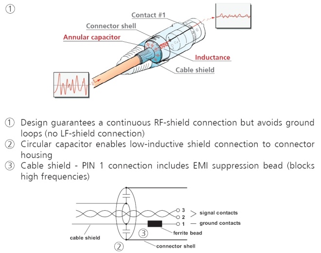

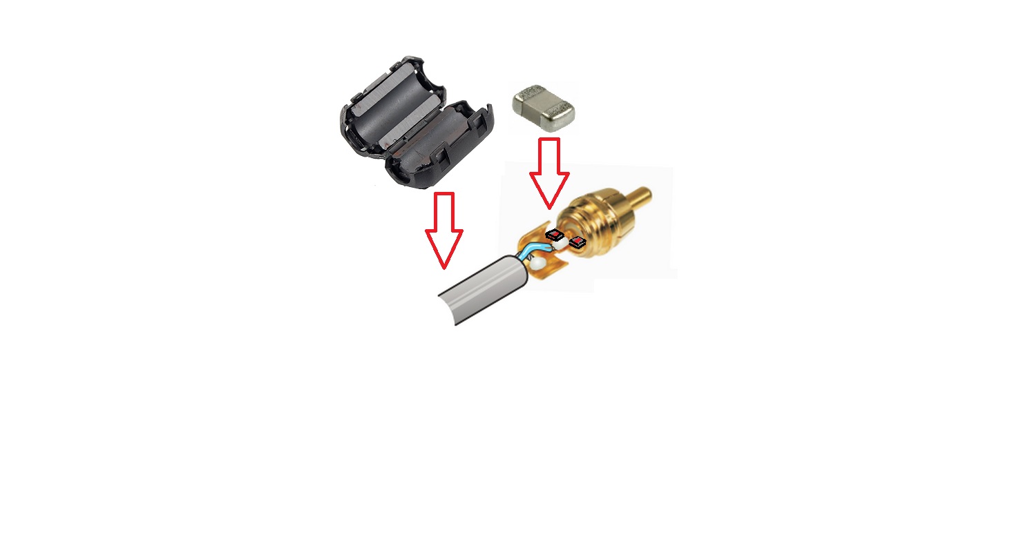

I used a 805 or 604 smd cap across the gap from Hot to Cold on the back of the RCA
This achieves the next to lowest RF impedance.
The lowest impedance would be a group of smd distributed around the whole perimeter of that gap from Hot to Cold.
On that basis using two lower value smd caps would be better than using one smd cap.
Have a look at the newer XLR plugs with the integrated & distributed capacitance from Hot to shell to conduct RF to Chassis.
Hi Andrew,
I do see Neutrik uses that technique, but they connect shield to GND. Not Hot to shield or GND.
I hope I got your advice correctly. Please see second picture. Caps must be 0.01uF. Right?

It's only conencted on one side of the cables... source or receiver...
