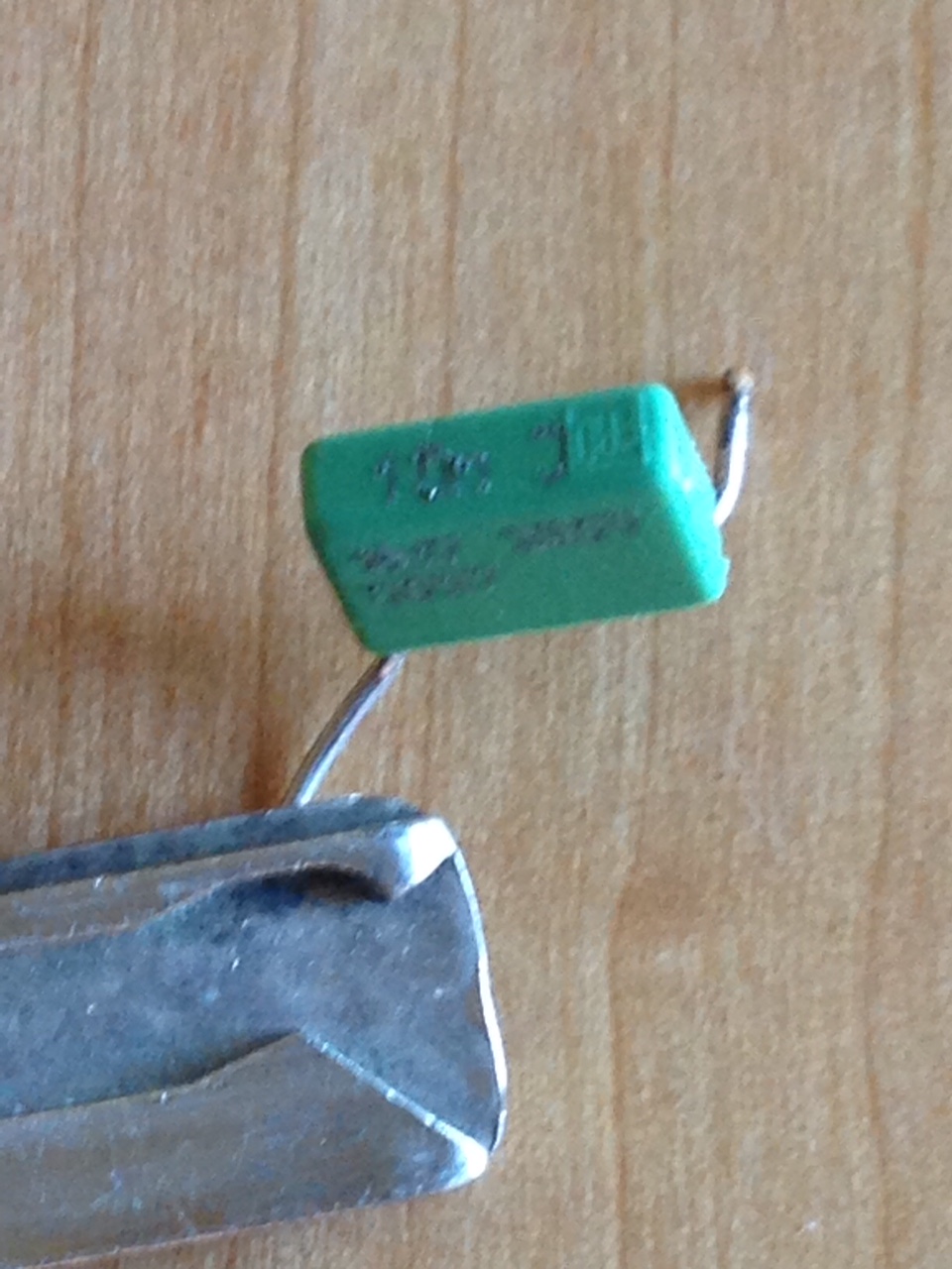

I know simple ceramic is the best for that purpose, but the only 47p that I have in home is Polystyrene. I might find silver mica...
Both not SMD. If SMD is mandatory better, then I need to go to Mouser... Will take 2-3 days to get it.
To look for ceramic SMD in Mouser or I might use one of these that I have in-hand?

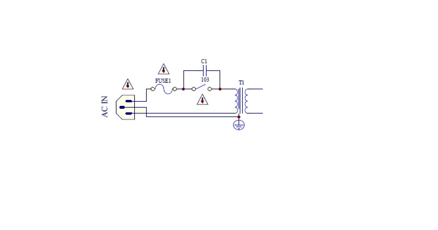

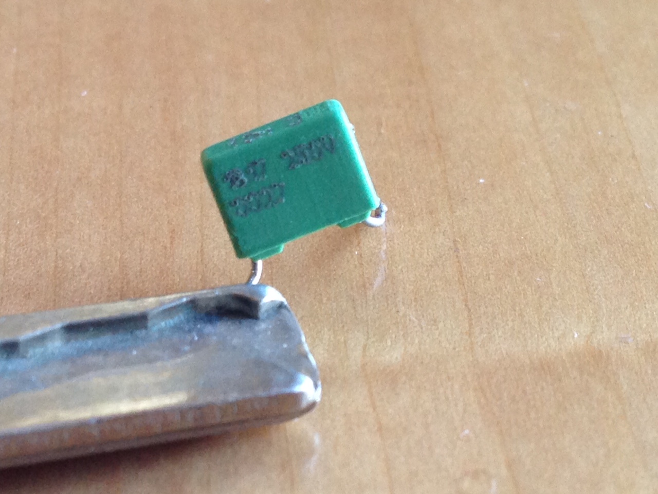

Hi Nick,
Thank you very much for your advice to use scope.
I imminently found the reason of my sudden signal sense turn on for my sub.
BTW, it might be a good lesson for all other guys who use small bypass caps on main AC switches.
So, I connected scope and turned Linkwitz On. Adjusted scope to see "0" signal and off position introduced noise in signal. Disconnected power cord from Likwitz and oops..., noise gone. Repeated several times and same thing. Noise when Filter is not powered.
I accidentally turned room light off and my main power switch (it has an internal LED) was showing some light. It was dimmed, but definitely light was there.
So, long story short: I used ERO Vishay 1817 10n 250v cap as a bypass for main power switch and it was leaking. I had 0.5V on my filter during power off.
I removed it and Voila!!!

Yes, I will use X class cap.
I would appreciate if you will device for specific brand/type on Mouser or Digikey.
X2 is normally used on single phase 220/240Vac systems.
X2 can also be used on 110/120Vac systems with extra Factor of Safety (FoS).
X1 is normally used on 3phase 400/440Vac systems.
X1 can be used on 110/120Vac and on 220/240Vac systems with extra FoS.
The MKP 338 example in post14606 is an X1 rated to 440Vac.
You can use this cap, but an X2 is good enough for single phase systems.
I still have 0.01uF Vishay MKP F1778 which left from my Main AC Filter project. They rated X2. Based on your explanation, I can use these with no issues. Right?
