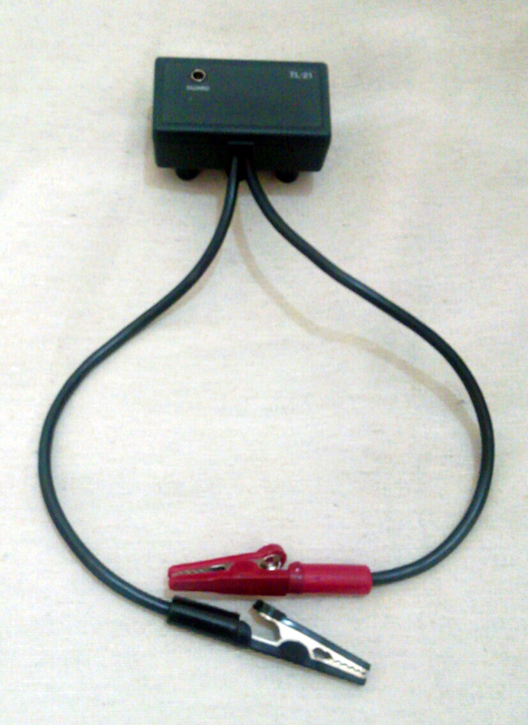

DE-5000 is good, but calibrate separately if using the slots or the TL-21 short crocks.😉
Yes agreed. There are at least 0.9pF offset when using the TL-21, I have a few ref polystyrene caps (over ea decade and 3 units at each decade) that Ive had calibrated by a buddy at local university EE dept... its worth the effort. I keep them in a safe them all together in the box and in a thermally stable location...
Legally defensible traceable calibration was my job for >20yrs old habits linger.
I had elongated and reinforced my TL-21 to make it handier since one original short wire became erratic. Can also grab those speaker air core big coils now.🙂 The TL-22 SMT pincher is nice though. Can help with many small through hole components too. It just takes to note the deviations vs the body slots and to run the calibration routine each time when changing the Kelvin(ish) leads type used.
I have same problem with my TL-21. I already replaced crocks since the original were really poor quality and they did not lock tightly.
The tools we use are only as good as the way we use them. ie maintenance and a clear understanding of its limitations are essential when pushing the limits
Its because very short and soft so they soon get tired mechanically by trying to grab biggish capacitors etc. I changed with sturdy jacket microphone wire and hefty crocks. All sense and shield connections used as in the original configuration of course. Not an easy operation, the thicker cable was a tight fit.
I'm also very gentle user and always keep all my equipment in perfect shape. I'm fully agree with Salas.
