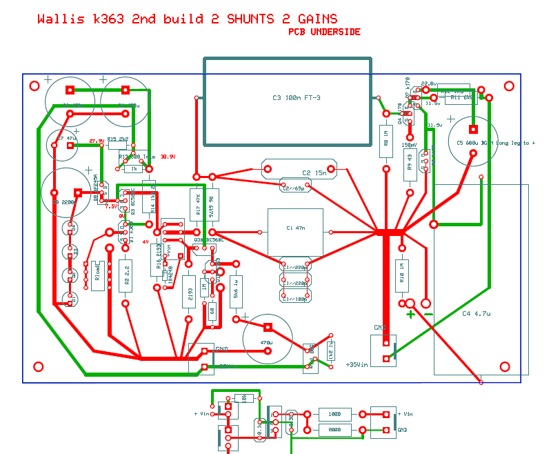

It works 🙂
Now I have two gains in the same board.
I used a common bias arrangement for the BC560 and another input k369 with 68Rs.
Switching between gain stages does not even produce any noises.... outstanding 🙂
Yes. What I find outstanding is the absence of noises when I flip the switch.
Now I have 43dB for my B&O MMC20CL and 57dB for the Benz ACE M.
I have a WW 100k linear pot to load the MM cart and the other is loaded with fixed résistors.
Well done RCruz. Could you please draw an picture of what you did?
Regards
Here you have.
Thanks RC. It will take me some time to understand this. Is this an extra pcb so you only reused the shunt regulator? What would be needed to just switch between input stages if even possible to reuse anything earlier than C3 and preferably even earlier? Please, I do not want to be disrespectful - I'm sure it is as you wish it to be but I'm wondering if I could reuse more of the intermediate/output stages.
I'll have a look at the schematic as well to see if more can be reused. Then again it is possible that other brands/types of C3/C4 and other components are prefered at 43dB.
Regards
Regards
I just duplicated the input stage leaving the riaa filter and output stage common to both gains.
There is a chip fed relay just before the riaa filter and the first stage cascode bias circuit is also common to both gains.
What you see here is only the amp.
The shunts are built in external boards. (In this example I am using two shunts per channel so there is one shunt for the input stage and another for the output stage in each channel 🙂
Using two shunts provides more overall lucidity and perceived attack.
