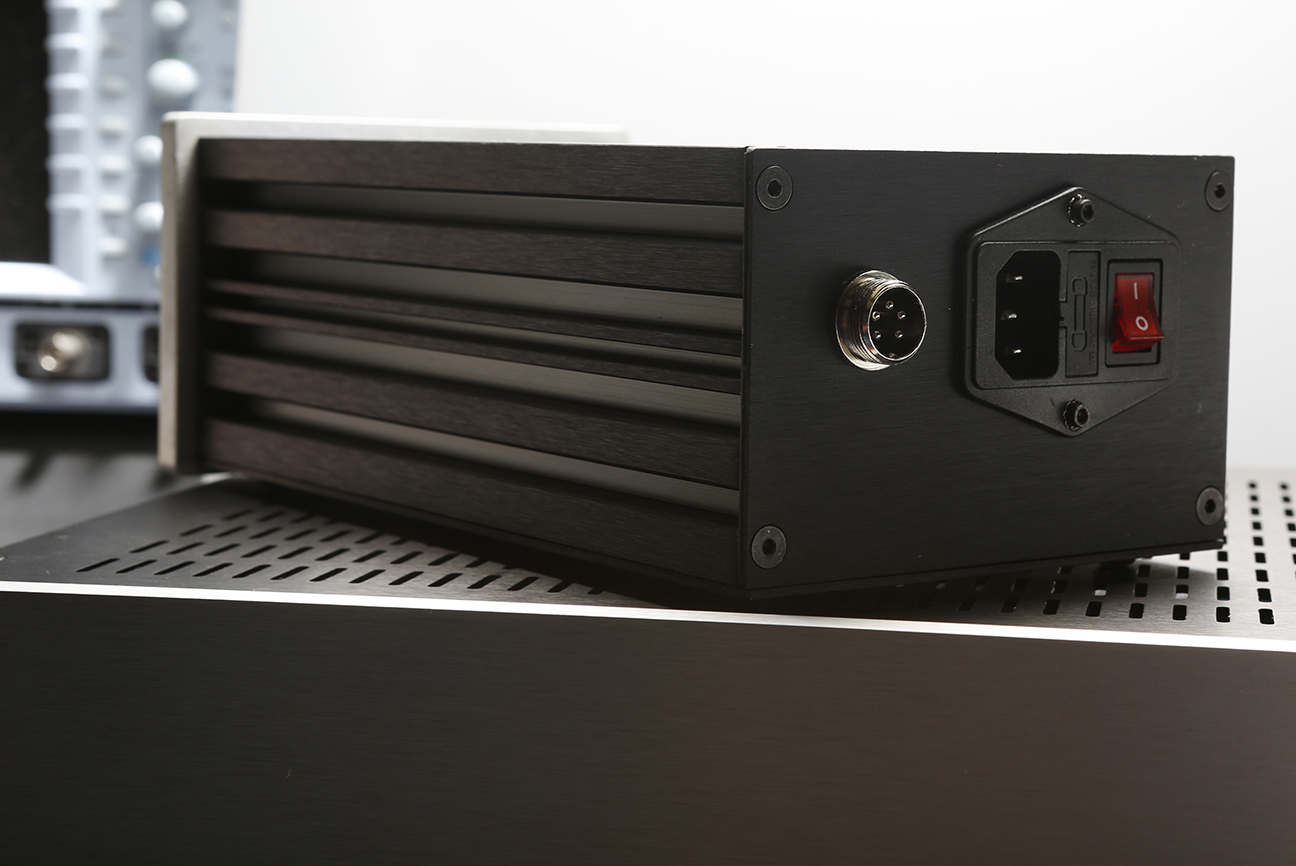

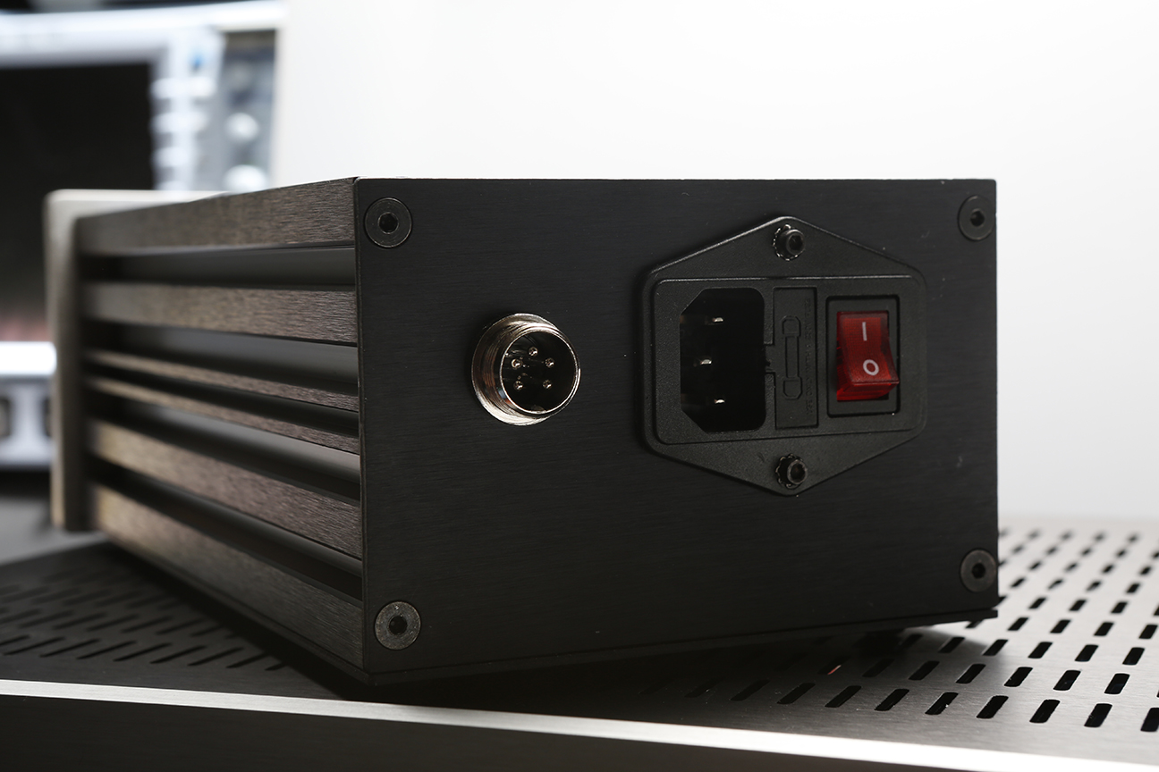

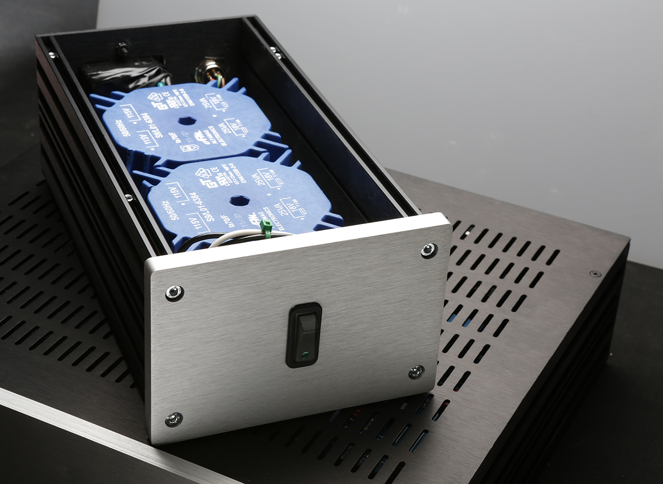

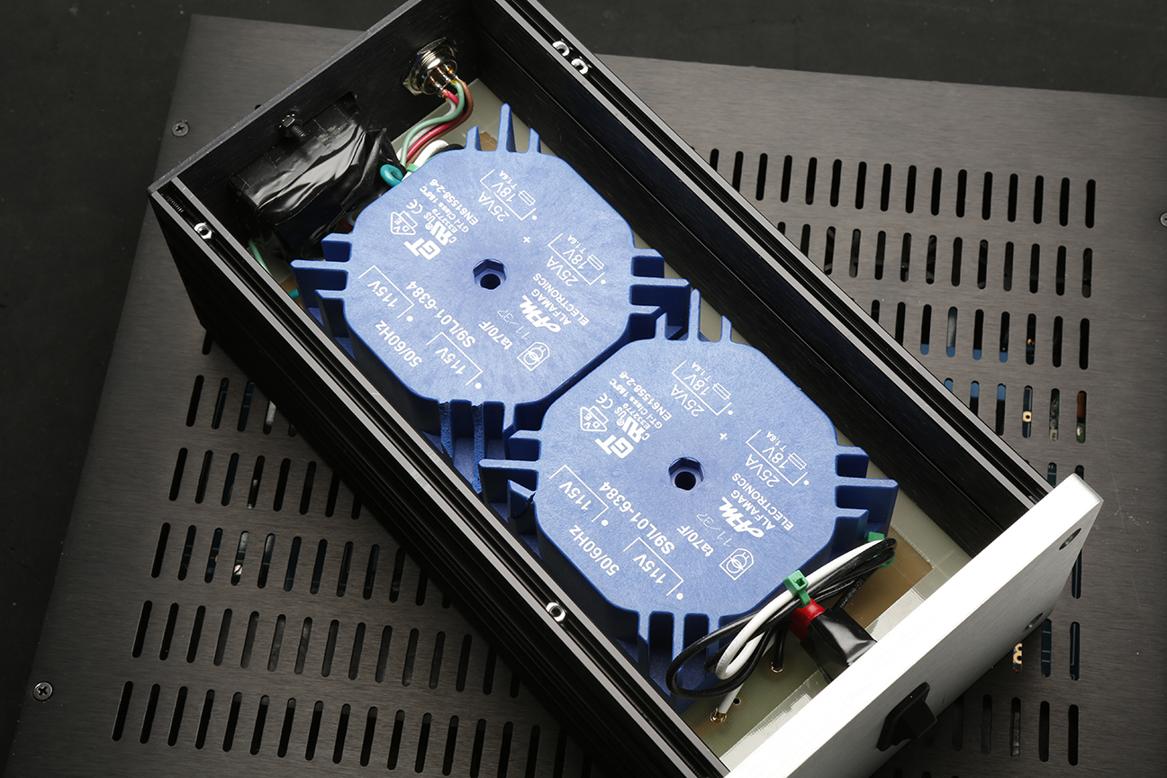

Sure. In the meantime here are some images. Power supply transformers. I etched board that fits nicely into the case to hold transformers and distribute power lines.

Nice photos. Very orderly transformer box build. Keep secondary AC cabling that enters the phono box well twisted and dressed, far away from any internal & external signal cabling. Especially from phono input signal route. We normally put the rectifying PCBs in the little box so to send out DC cabling that emits no hum field. But you don't have the space for such boards in that box as I see. Let us know how the rest went and how it played with your cart. Best load etc.

Really neat work on that psu AR2.... where did you get the enclosures ?

I got them here from DIYAudio store. Those are Italian made and really great in quality. I will post pictures of preamp when it is completely done. For now is in the case, but since I am still tiding it up it is not ready for the show 🙂
To answer Salas's comment - since I got these from DIYAudio store, these were the only two sizes available at the time, hence the decision to have transformers only, while PS is housed with preamps. Since all the wires are shielded and twisted than I am hopeful it will not create problems. Preamp case is pretty spacious so AC lines are far from anything else. I decided to go for these cases without waiting for new order, since I promised to my son to do this... so deadline is much tighter than when I am making something for myself, haha. 😛
