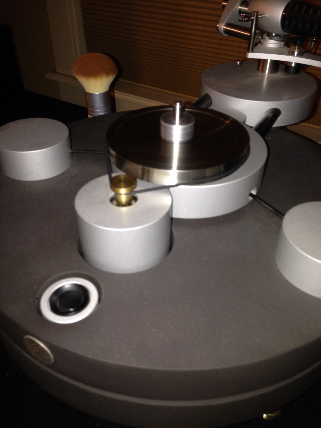

Short question to all TT experienced guys...

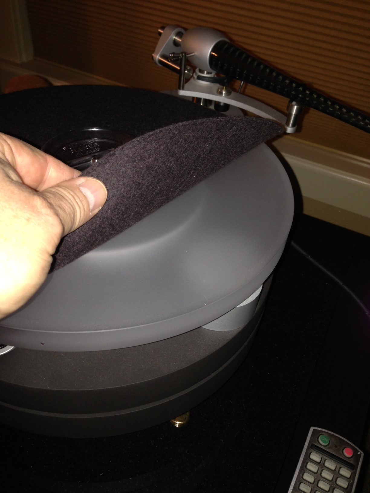

The final little noise that I start to hear in 3/4 of full volume is when TT motor is On and I rotate TT arm towards center pin (like to the end of LP). Rotate arm back to LP start position and noise is going down. Absolute quite when TT motor Off.
So, the issue is related to cart pickup from my motor. How to cure that?

Metal bodied carts are generally more immune to that. You can't do much if the shielding ain't strong in the cart itself. You already balanced the transfer on SUT. DC motor TT with external PSU is emitting the least. But as you describe it i.e. when 3/4 volume and up-no music-20dB gain preamp-little noise, it does not seem intruding. What is it? Buzz or hum?
It is more like hum. It is quite above my listening habit volume level, but I thought we might try to fix it.
Its the AC motor field only then. I don't know...some experiment with shielding tape wrapped around the cart and grounded perhaps?
How to do that in practice? I imagine it will be ugly and complicated. I thought to try MU metal wrap or Cu foil wrap (or both) on motor enclose. What do you think?

Isn't it possible to shield the motor pod? The top of it for starters. I think the most effective is when you shield at the source. There are even sprays for better looks. Not sure if it would be effective. Never used: ERNSCP400H | ERNSCP400H, EMI/RFI Shielding Aerosol with Grey Colour 400mL | Electrolube

It is not MHz your shielding, it is Hz. Layered mu-metal or soft iron works best there. What is the motor can made of, is it aluminium?
