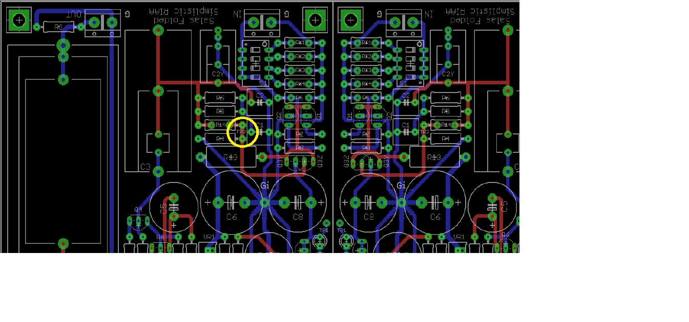

stupid question,where is TP2?,I think i'm blind .Thanks
lapsan
Here it is....in Yellow.

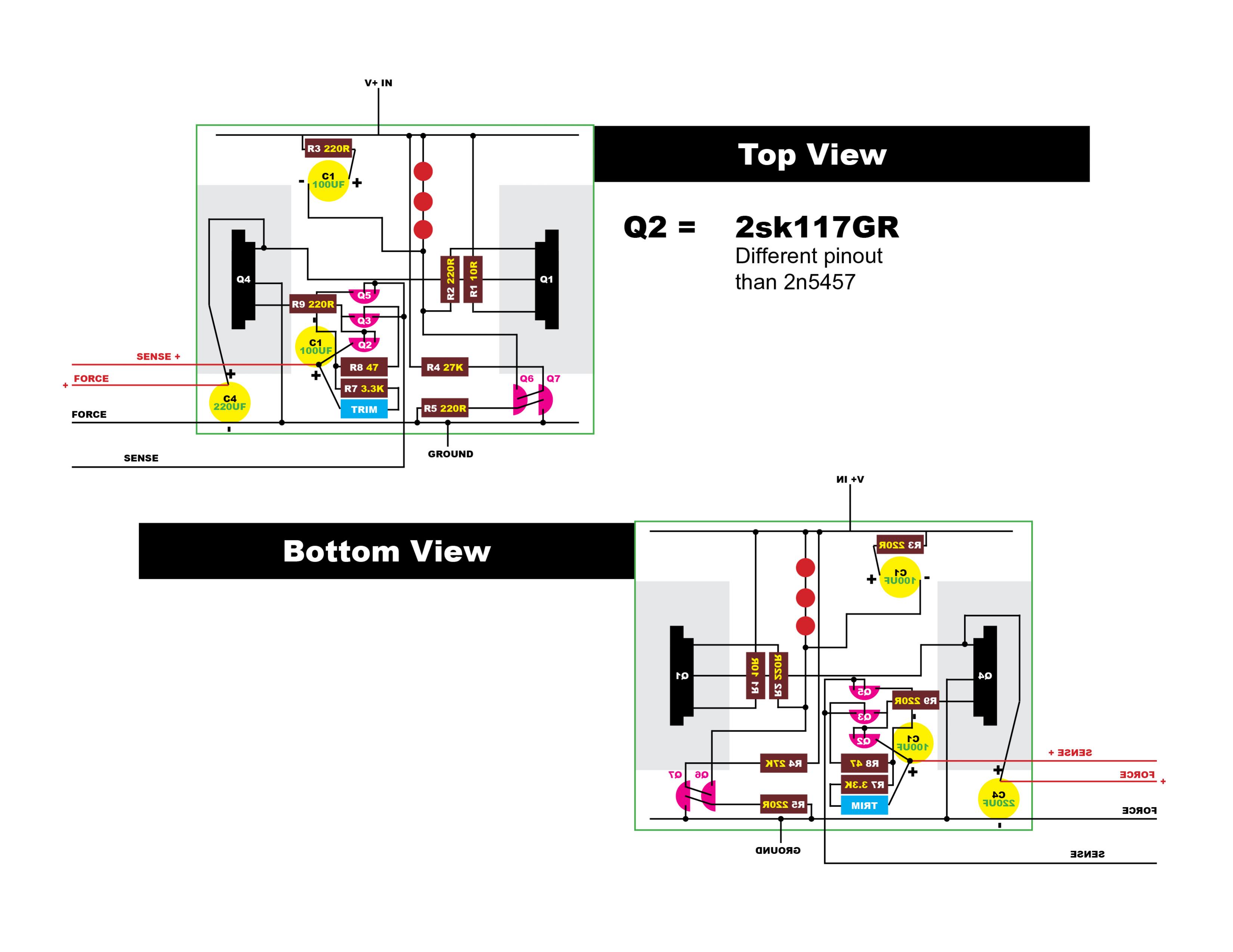

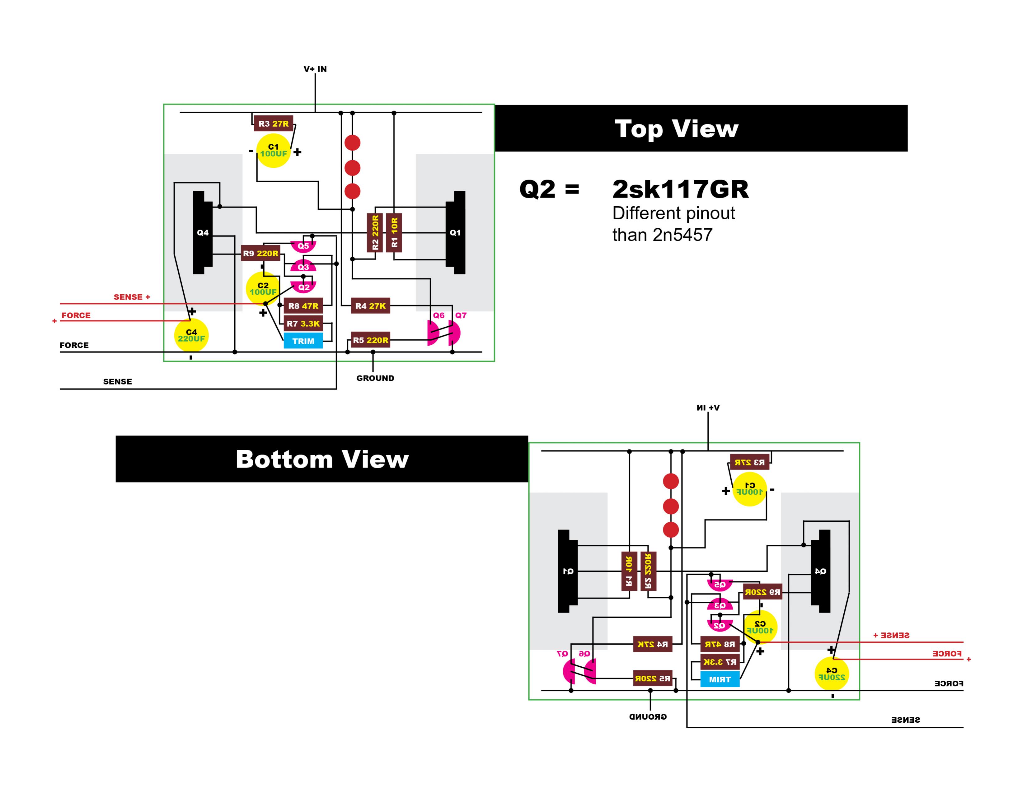

Hi Hikari1.
Would you mind upload a drawing of how you place the components on your protoboard?
It would be very appreciated

Here is what I am thinking for layout. IT IS UNTESTED, there may be mistakes. It is sized for 7x9cm protoboard. The gray area is heatsink. Feel free to comment or give suggestions.

Hi Hikari1.
Looked it thru and I believe it will work. The only mistake is that the cap marked C1 100uf close to Q2 is actually C2.

I think Q3 was upside down as well. Here is a revised layout.
