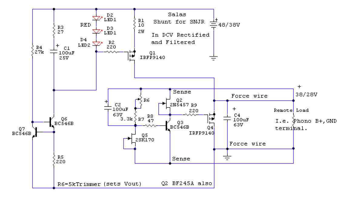

Are you sure.Reverse the battery's polarity. ...........
The battery + is connected to red.
That red passes into the 10r. the 10r feeds the Drain pin.
That, to me, looks right.
Oops, there is a view of a black going between the terminals. Is Black feeding right hand terminal and then the resistor and the next red wire?
The hand written labels on the paper have been reversed
It's the wires into the terminals that have been swapped.
Andrew, I think Salas is right.
That + is not passing into the resistor and feeding the drain in the picture. Looking behind the connector block, we can clearly see the black - cable passing over to the resistor side of the connector block. The + and - markings are written as it is wired, with reversed polarity from how it should be.
It's all good guys, thank you. The pic is a little confusing I suppose. I swapped polarity and all works well.

I just finish assemble the board ,no power on the rail or TP1?i don't know what when went wrong Thanks
lap
lap
First make sure you got incoming DC right for value and polarity to the boards. Next debug the regulators area. Check MOSFET types are right etc.

Dc voltage is 47 voltage,i will reduce it further with a bigger resister at later when i place an order tommorow.the Mosfet is IRF9610PBF Q1x 2-IRF9530PBF Q6x 2,Tea hook me up great packet 😀First make sure you got incoming DC right for value and polarity to the boards. Next debug the regulators area. Check MOSFET types are right etc.
lap
lap
You don't have to reduce from 47 raw DC, its already in spec. Look for correct polarity to the DC in connector and/or parts stuffing mistakes in the regulators. Like having used a BJT for a JFET or the other way around, a PNP instead of an NPN, some wrong resistor...
i unsoldering the big cap and look at Jfet.everything look exactly the same thing on other side.the other side work fine.all the jfet test fine when Tea sent the packet.Thanks again
