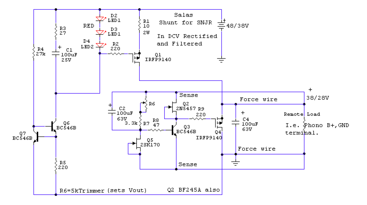

i did some probing this evening,on the Q1X only leg get 42volt the other 2 got nothing.on the working side ,i got 33 voltage across all 3 legs.Can 9610 mosfet be no good?Thankyou

A MOSFET can fail even by static but make sure that the non lit LEDs down its way are all correctly oriented and healthy by battery test without removing them first. With different color wires from a 9V you can fast check them one by one for flashing when the (-) goes to cathode side the right way.

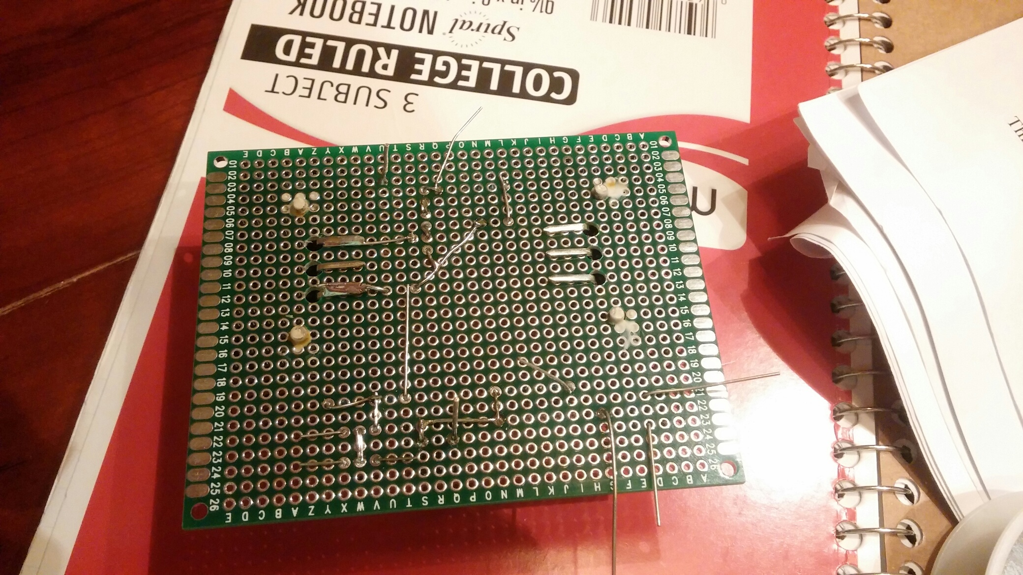

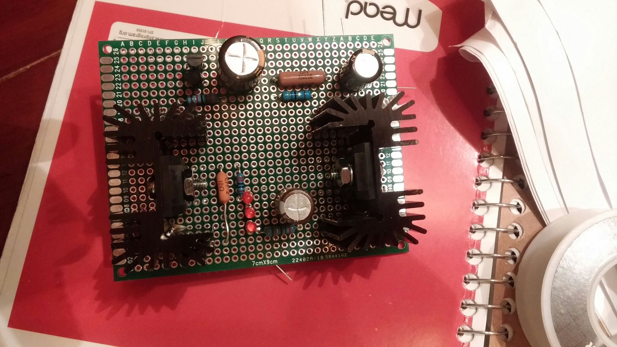

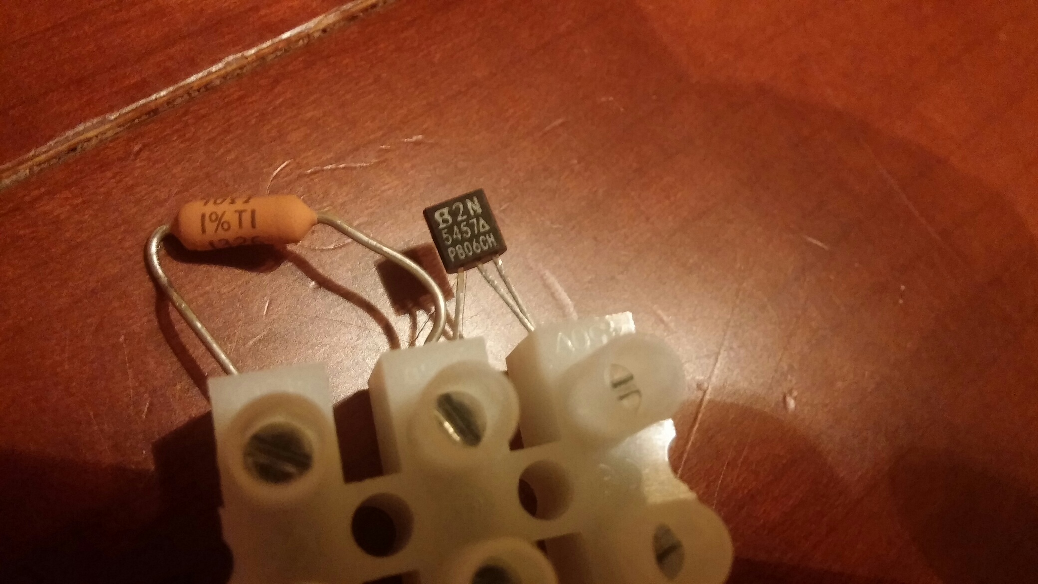

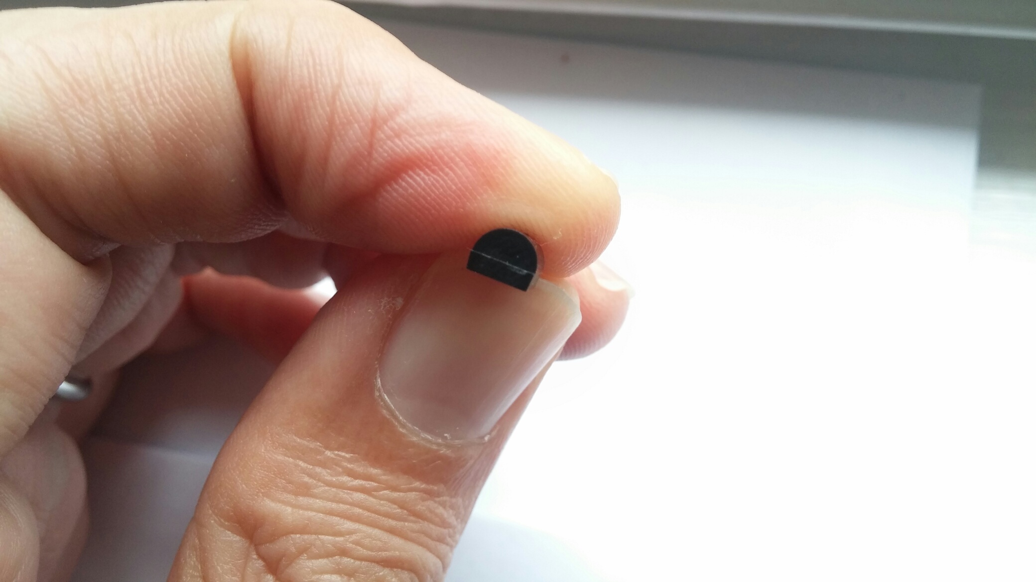

I used my brain and decided to use protoboard. I think I have got it figured out. Hope I have enough heatsink. They are about an inch tall...using to-247 mosfets. Got some 2n5457s off of ebay. They are bad fakes...bad printing, sanded down faces. IDSS measures way way low. Once I get some good 2n5457s I should be up and running.
What does the sanded face look like?
The body (case) is shiny, the face under the lettering is dull, like it's been sanded down.
What range of IDSS they produce at VDS=15V & VGS=0V ?The body (case) is shiny, the face under the lettering is dull, like it's been sanded down.
With a 9v battery they were .3ma idss. I think the minimum is 1ma.
Maybe its fake to the extent of having the gate pin in another place or even its P-JFET or BJT. Anyway, use 2SK117GR for Q2 & Q5 as I said. Perfectly fine.
Your protoboard component placement.
Hi Hikari1.
Would you mind upload a drawing of how you place the components on your protoboard?
It would be very appreciated🙂
Hi Hikari1.
Regards

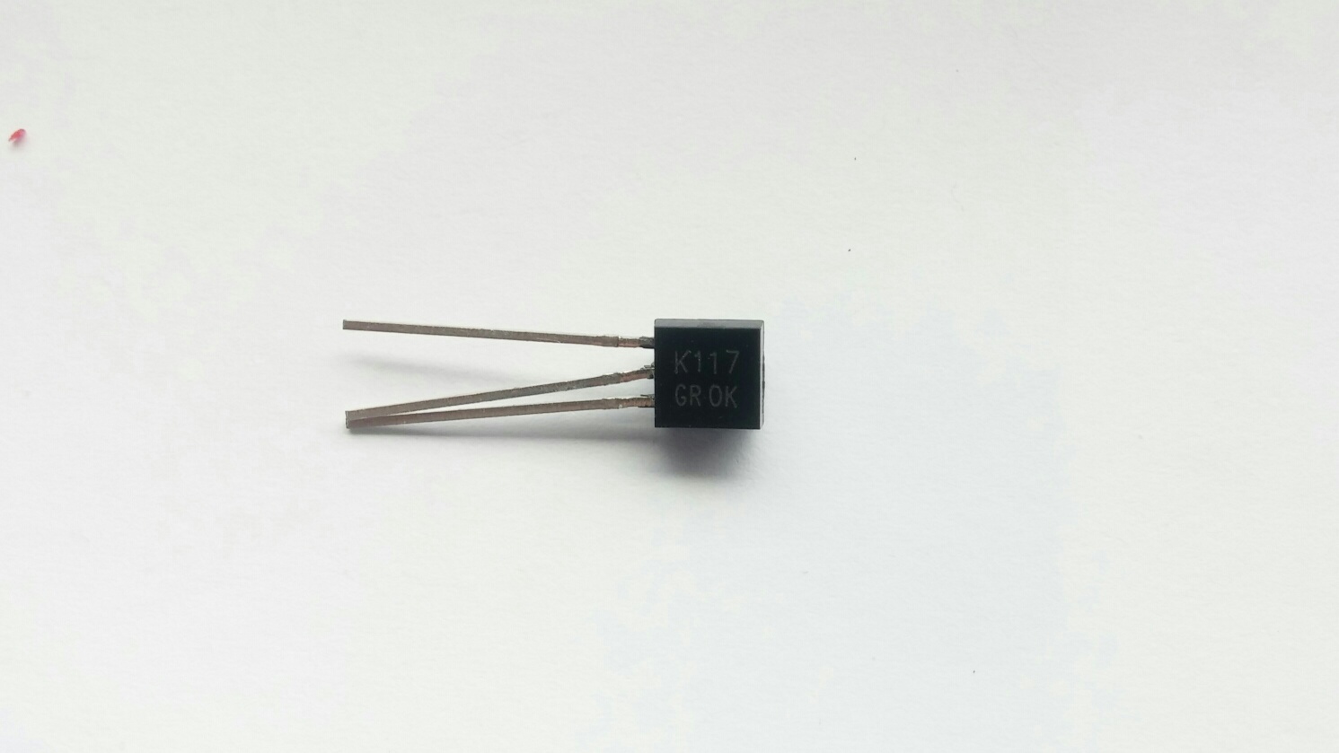

Check your 2SK117GR stash if you recently bought any. I have caught a circulating specimen that presents wrong curves (not flat but diagonal). It invariably has GR OK batch number printed on it. Its IDSS, Yfs, Vgs may appear in range and it will work (maybe will bias lower under small VDS) but surely it will not perform OK dynamically.

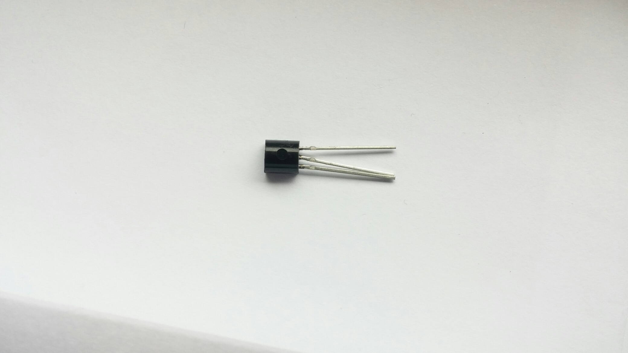

In general, proper 2SK117GR should have "one" digits printed like vertical featureless lines, should show a short prominent ridge along the center front when viewed from top, show a bit of copper color when viewed from the back where the pins enter the plastic. Much like 2SK170BL.
I alerted tea-bag about it and he investigated his stash. He found a number but he received those very recently and he could have sent out only about 80 pcs most likely in BIB 1.1 bags not in FSP bags. If you spot those bad apples let him know via PM. Do check the new FSP mini-kit arrivals nonetheless or whatever 117s you bought yourself from vendors especially recently.
OK, now I am worried about my 2sk117GR. I didn't get them from a group buy. Bought they from an online retailer. They appear like the one's Salas describes as fakes above...damn. I checked IDSS, it was in spec...about 4.3. But I didnt test curves. Should I use them?

Hi Hikari1.
Regards

I will. But don't you want me to get it working first? I don't want to be responsible for a fire in your house. I don't have a transformer yet...But should be soon.

They will probably work sufficiently for now but get better later. Its not clear if they are copies or just an off spec batch from some licensed foundry, one thing is sure, they aren't 100% for curves. Something like 75%.

Would 2sk170bl be a safer choice instead of the suspicious 2sk117gr for q2 and q5? I know my 2sk170 are good. 8.5ma IDDS.

Thanks to Tea B I finally got a new mosfet in there,everything light up Now🙂.now need some adjusting.Now my power supply voltage drop to 37 voltage at DC end when hook up and both fire up?😱 it that normal?A MOSFET can fail even by static but make sure that the non lit LEDs down its way are all correctly oriented and healthy by battery test without removing them first. With different color wires from a 9V you can fast check them one by one for flashing when the (-) goes to cathode side the right way.

Could be hotter and driftier until you get genuine 117GR but you will be sure about the noise spec and curves meantime.
