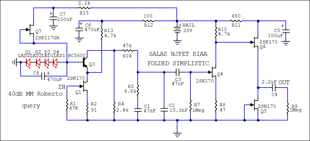

Use the smallest IDSS 170BL you got in place of the K117GR or better use BF245A if you got any. See to have about 10V between R15 and D4 (across Q7) and adjust the R15 value for that. (Or R12, D1, Q5, in your #12842).
P.S. Match your FETS to a fair degree, and use your best matches in the second stage.

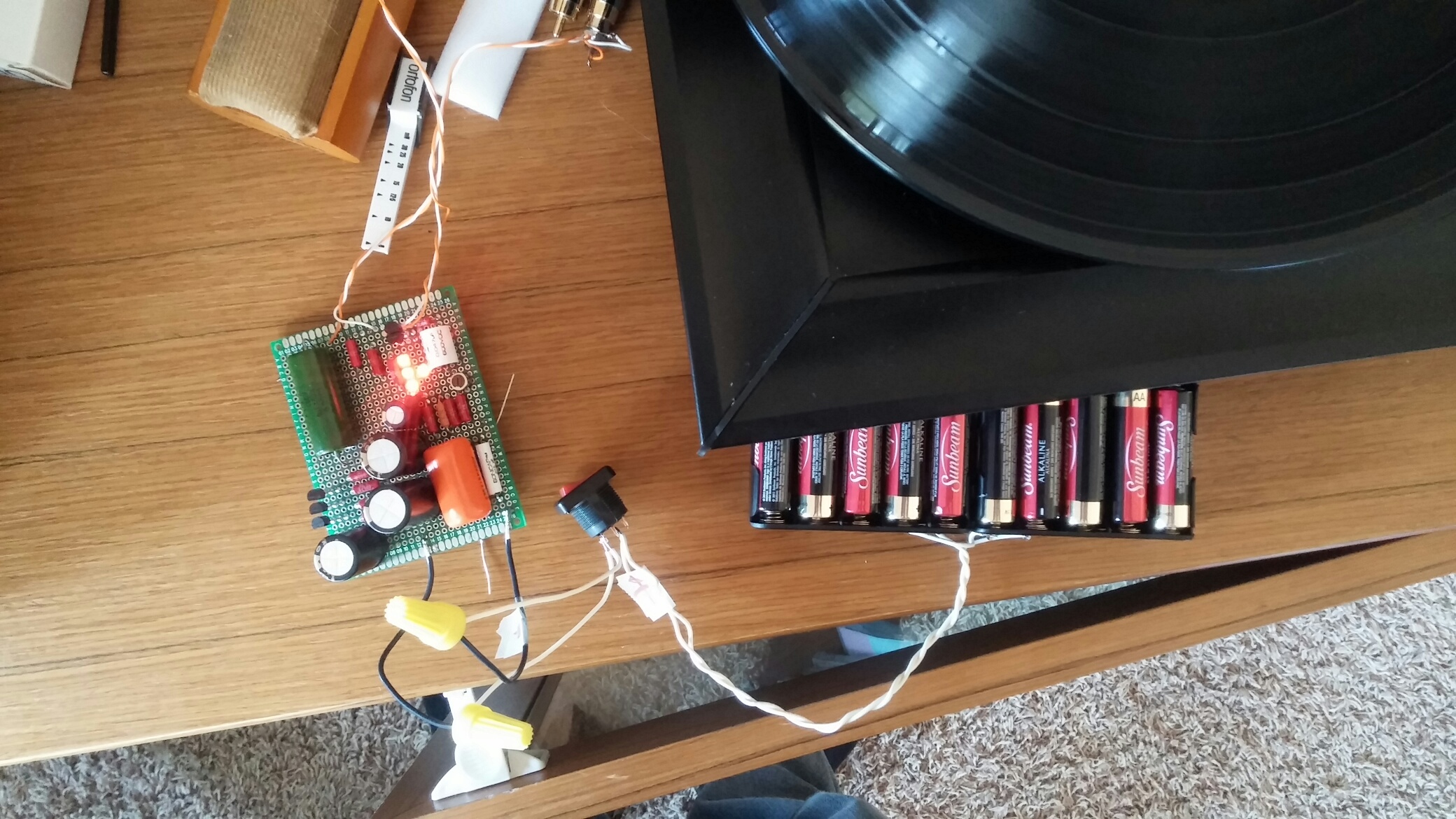

I've got one channel up and running! It works, it makes sound although it's hard to judge with only one channel.
But I've only got about 2.6V across R15 and D4. I am using an 8ma 2sk170 for Q7. Can you suggest a value for R15 to get me in the 10V range across r15 and D4 or is it to leave it as-is? The gain was maybe a little lower than I expected but again, it's hard to tell with only one channel.

Q7 still works as CCS with only 2.6V VDS too because its a low pinch off FET. You can use 1.2K R15 at a point, but its not a pressing issue.
More of a priority is to check voltage across R4. How much is it? Also, what Rail+ those batteries provide?

2.6V across R15 indicates ONLY 1.18mA flowing through the CCS jFET (2.6V/2k2= 0.0011818A)I've got one channel up and running! It works, it makes sound although it's hard to judge with only one channel.
There is something wrong.
What is the voltage across the LED string? d1? d2? d3? d4? (d1+d2+d3+d4)?

if there is 2.6Vds on the jFET I'd expect the Id to be very approximately half Idss.
That can be checked by measuring the Vr15 and calculating the current passing to the CCS.
That can be checked and is worth checking by measuring Vr15.Not so much loss, even at 0.6V VDS a K170 loses 20% IDSS only. About 7% IDSS loss @ 2.6VDS vs 10VDS.
And written down on his printed schematic for future reference. Along with all the other relevant node voltages.
Batteries are about 27.5V unloaded. They are a little used so I expect about 30V loaded with fresh batteries.
I've got 3.6V across R4. I have a trimmer I can adjust if needed.
