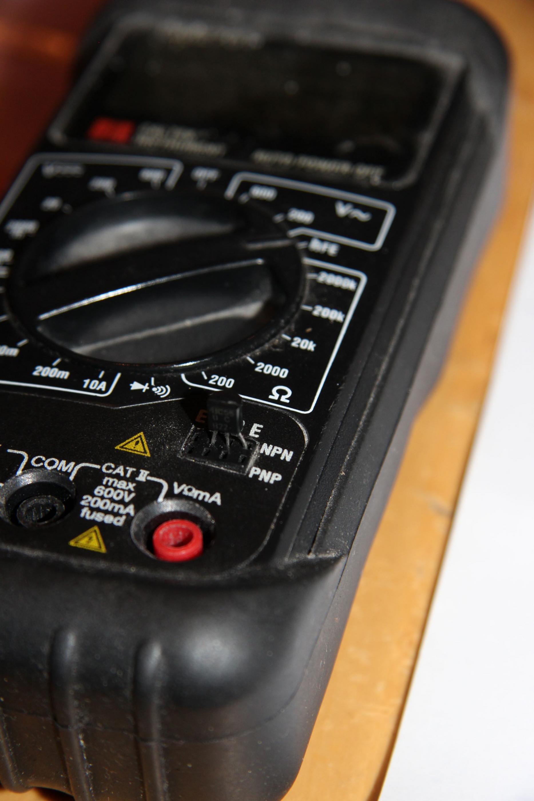

I use 500mm long croc clip leads for rough batching of jFET Idss.
Never had a problem with instability.
Did you try that with K369s or alike models? Me I had encountered instability with those especially if on breadboard and the G to S link is patch wire and not a short pin link. Also with different DMMs and leads if in series mode. It will not come up with a FLUKE 87V but it will with a UNI-T.

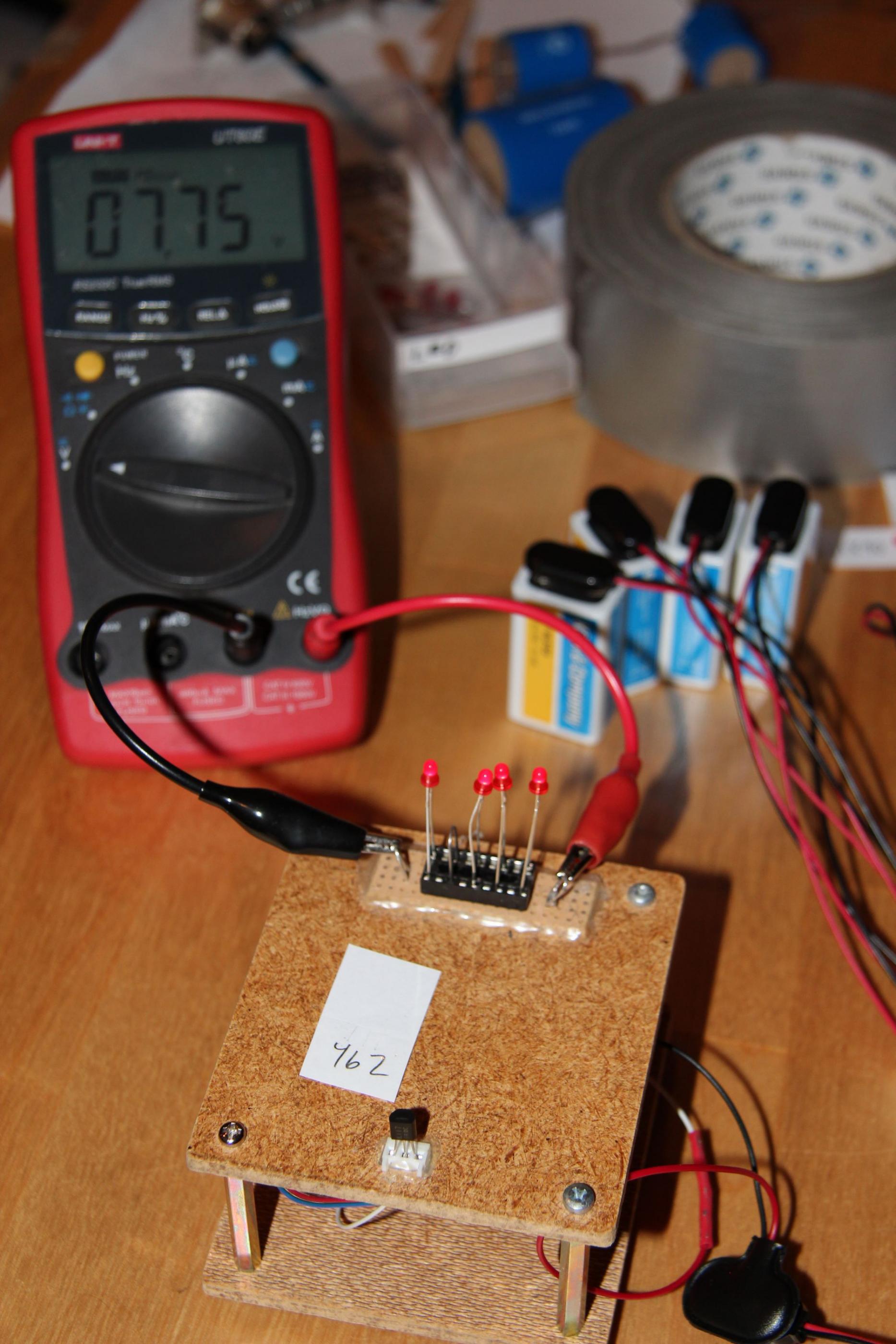

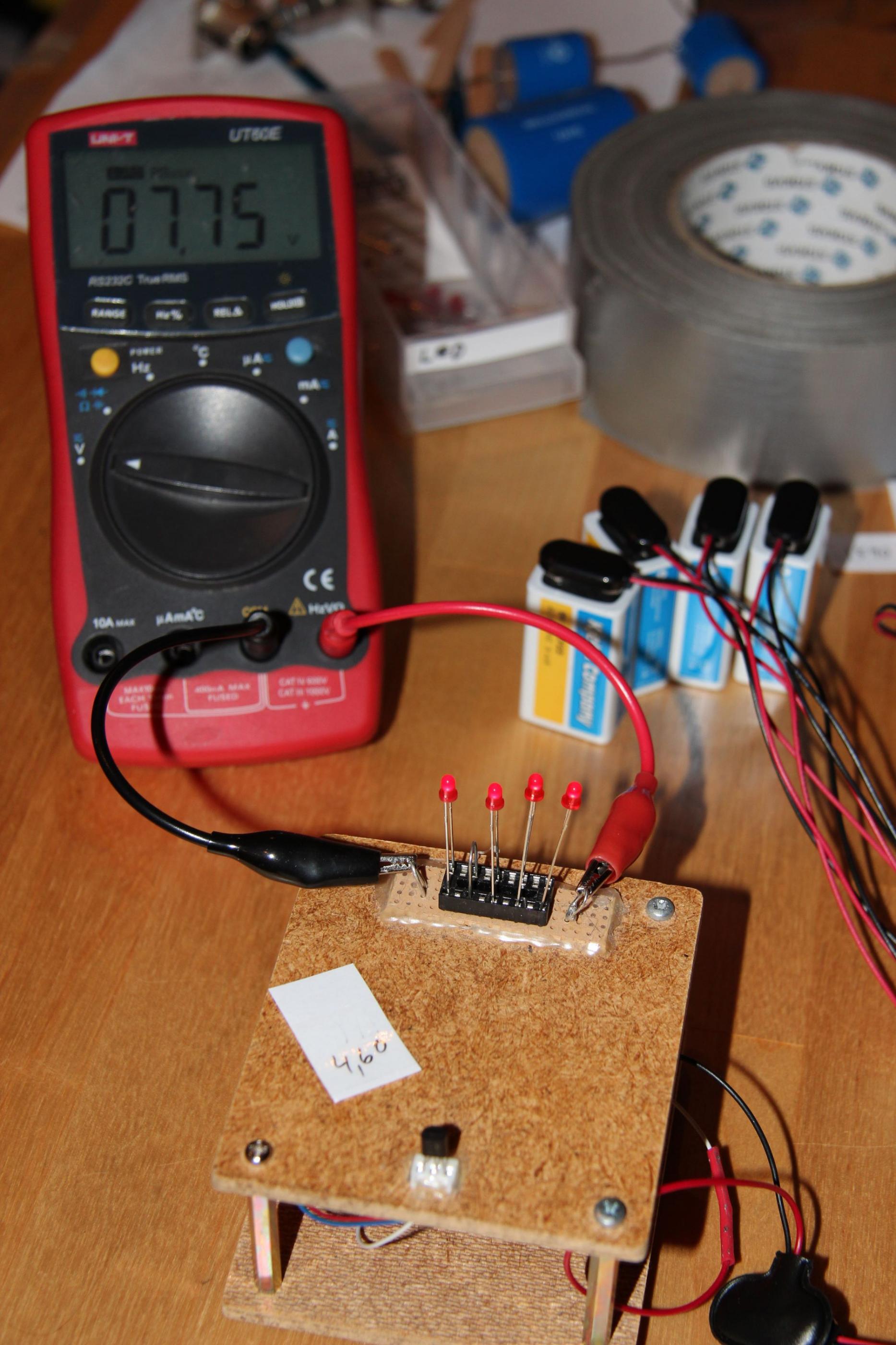

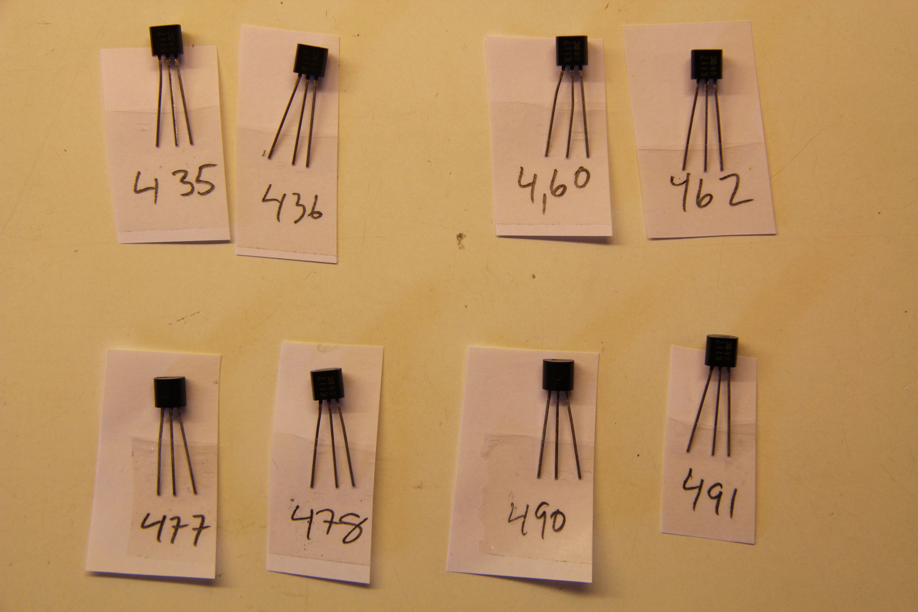

Cool. I did Q7+quartet first. Since current is low I can not just add singlehandingly measured LEDs to eachother but has to go up slightly in values.
First 4,62 mA Idss I tried with LEDs that individually measured 1,965, 1,971, 1,973 and 1,972. That quadruple that should end up on 7,88 at larger current here ended up on 7,72. So I exchanged the 1,965 with a 2,000 and a stable total ended up on 7,75 volts.
Same procedure with next 4,60 mA. There I ended up with 1,974, 1,970, 1,969 and 2,003 LEDs stabilizing at 7,75 V.
Measured over 18 V.
I don't have 2sk369

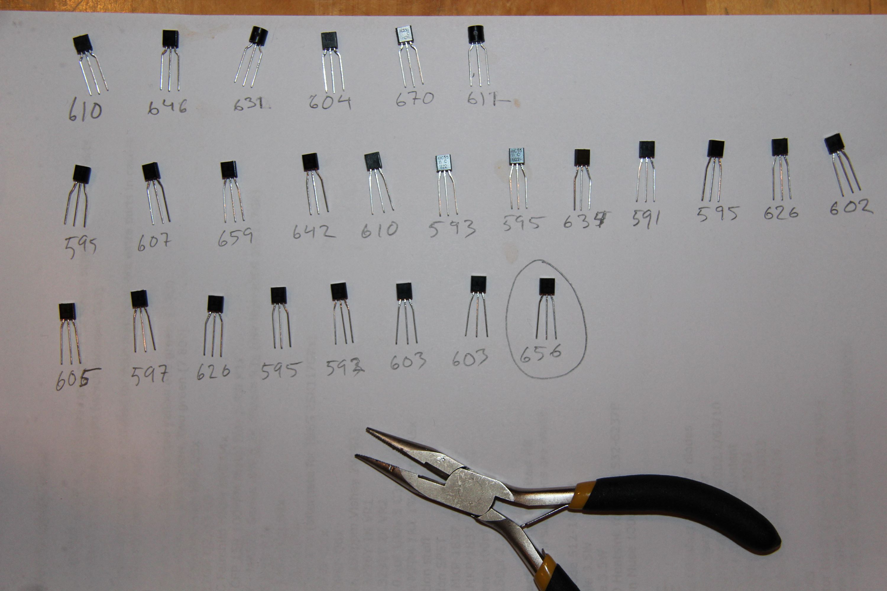

I did do high range of bl grade 2sk170 and many throughout the range of c grade lsk170, some exceeding 20mA Idss with their very high gm.
