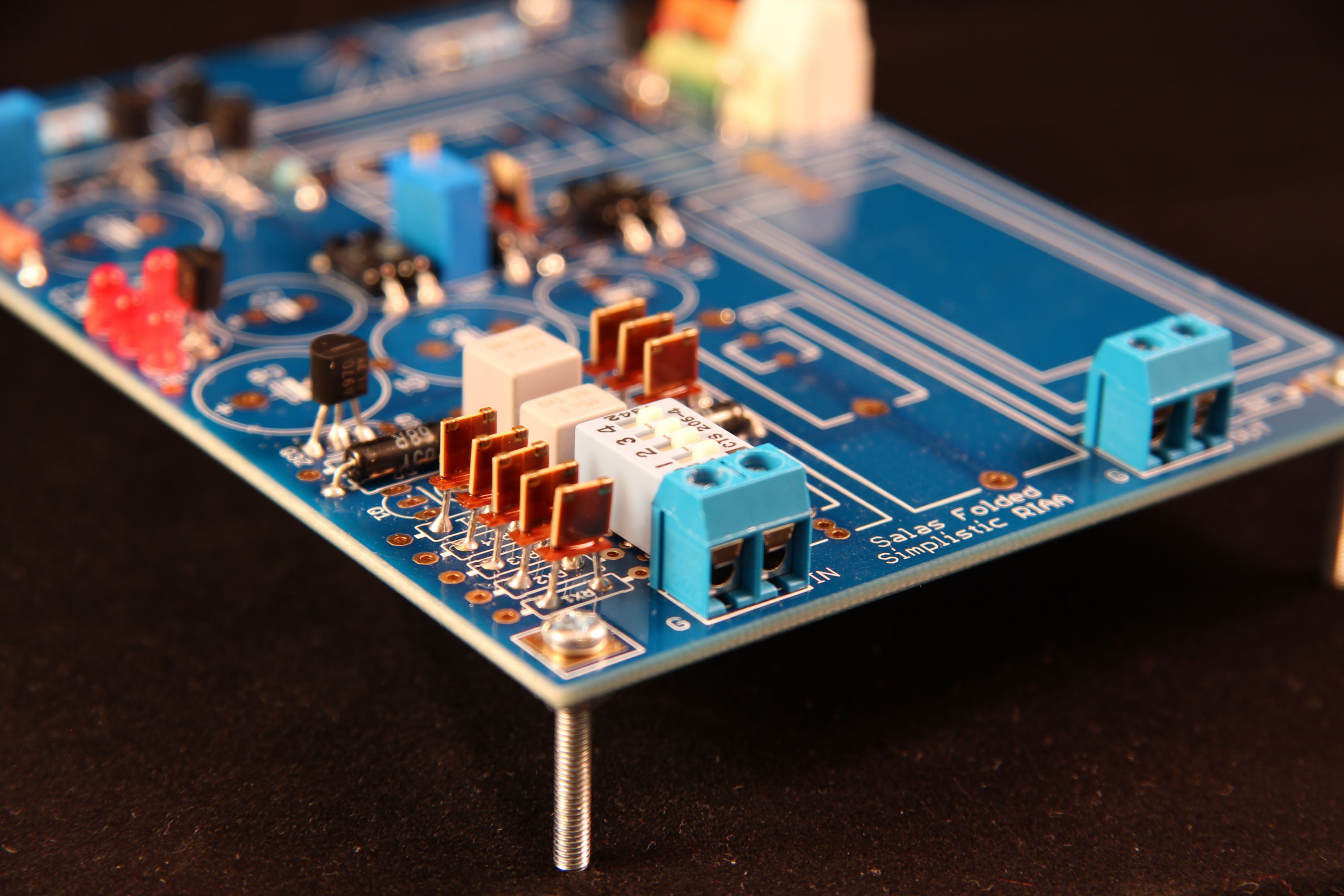

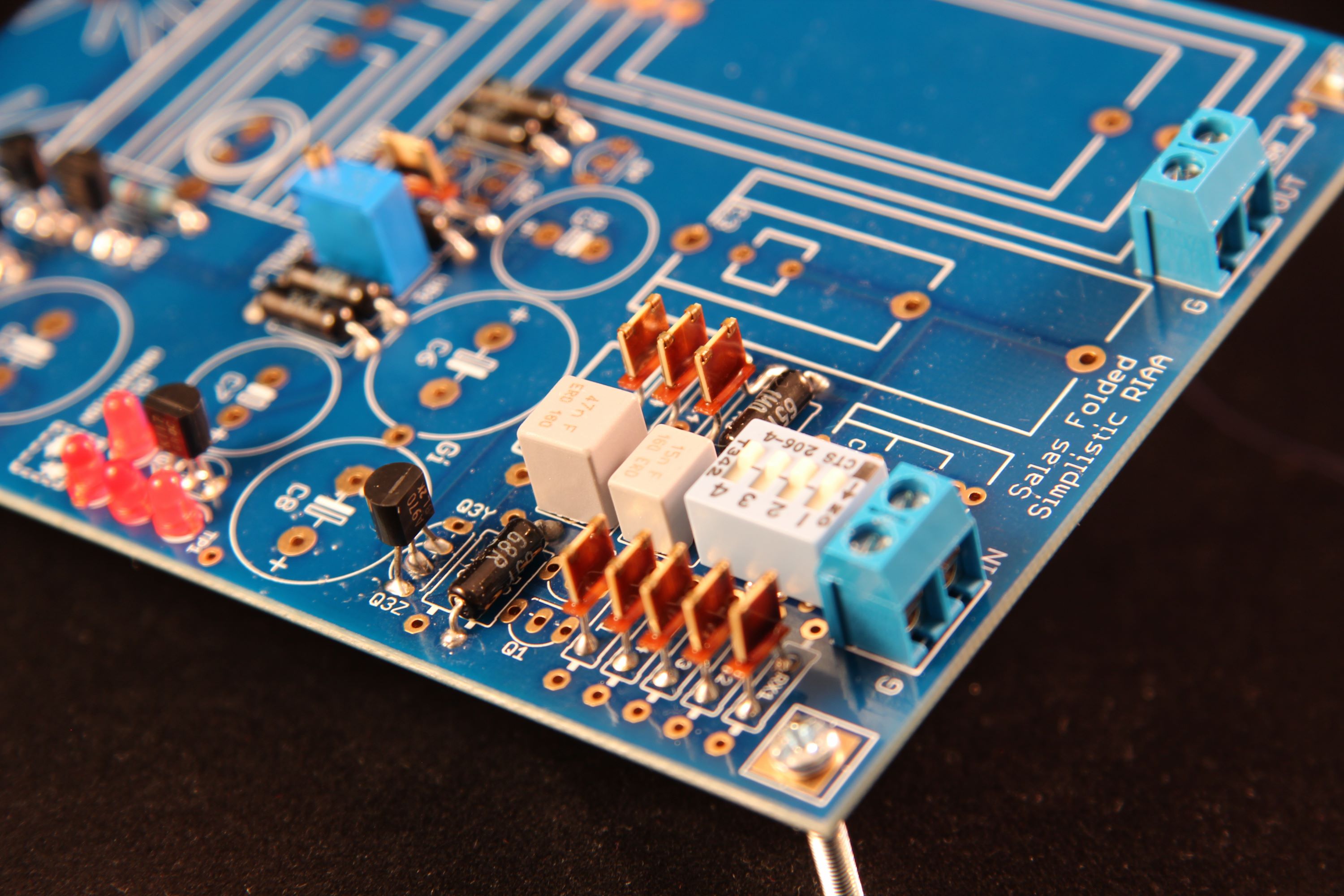

Pretty much done with the small comps now. 369s and 170s are awaiting. Matching up the 369s tonight.
Everything populated so far is matched to the closest my instruments gets me.

I have a question about R2,R3, im my case R2.
In the Notes 2SK369BL it says "Use corresponding resistor values for R2, R3 from this table..."
Under Gain it says: "For high MC cartridge 2-2,5 mV don't populate Q2, R3, use 68R R2..."
R2
R2
Idss mA 10 11 12 13 14 15
Rs ohms 3,0 3,9 5,1 6,8 9,1 11
What are those values?
For LMC and MC type FSP use.
