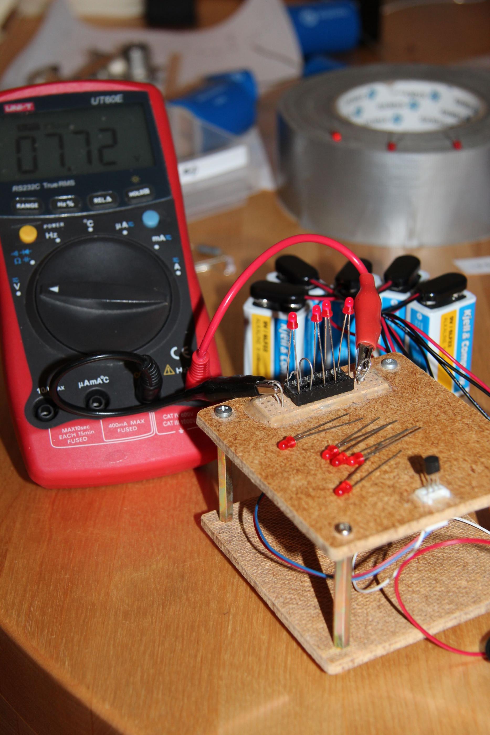

Here is something for you guys to chew on. The 4 LEDs are connected after the k117 (Idss 3,32) as in the circuit. All 4 LEDs measure over 2 Vdrop, some over 2,1 V measured the traditional way with a 9 V battery and 1 k resistor. In the circuit I cant get over 7,72 alltogether. If I use LEDs that measures lower with 9v/1K I get lower results in circuit.
Drain-source measures some 38,5, drain-gate some 39,0.

If I throw in a higher (Idss 3,60 SK117) it climbes upwards to 7,76, Idss 3,8 7,78 V, Idss 4,0 7,80 Vdrop over the quad.
Got one LED out to control. It dropped 2,14 V (one of the highest red 3 mm I had) and it dropped 6,82 over the 1 k resistor (6,82 mA). 6,82+2,14=8,96, battery running low.
Same string of 4 LEDs combined with 18,7 volts feed and 1 k resistor gives 8,4 V over the LEDs and 10,3 over 1 k.
With 2K2 resistor it has 7,8 Vdrop over LEDs and 10,9 over 2k2 (4,95 mA)
So, to even get those LEDs to drop the specified 7,75 V one has to go up in Idss to 3,9-4,0 mA.
Ergo: Few if any 3 mm red leds drop 7,75/4=1,94 volts at such low current (Idss) as 3-3,5.
Can that be the conclusion?
For 7,75 at Idss 3,3 I need to combine with a green.

Its probably due to excessive burden voltage in some DMM mA range sockets. There is a shunt resistance they sample the reading across that it can be largish by design. Prefer the voltage translation across a small resistor IDSS measuring method in such a case.
Some times if the link between G+S is not very short and there are long leads from the battery biasing the JFET under measurement, the very high gain & high capacitance ones like the 369 can oscillate. They show less IDSS when that happens. You may see a sudden small drop on the battery or other PSU DC voltage if monitoring it. That's a sign it went off. I had mentioned that few times before.
