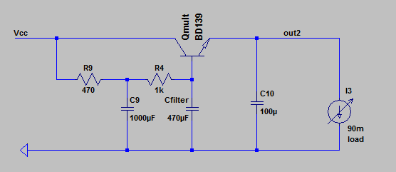

Is this reg with small TO-92 transistors capable enough? Your version needs 20-22mA per channel. Maybe BD140 for Q2 if its a common reg between channels.
I don't have a reason to think that low Zout like the KM would benefit a CCS, but I've talked with several people who say it improves the sound. Based on my understanding of electronics theory I wouldn't focus on low Zout for powering a CCS, if I could do it simpler with the same PSRR. In this sense the main feature of a KM would be lower voltage drop than a 2-transistor cascaded C-multiplier. For this specific application the two options seem fairly close, but I haven't done an actual comparison along these lines.

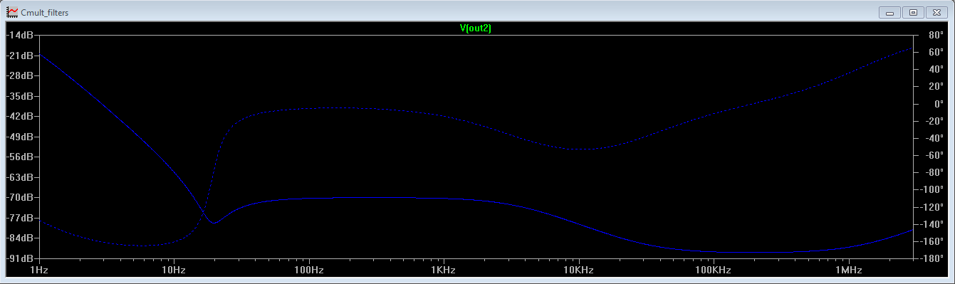

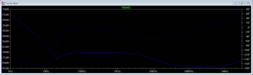

I have looked for parts in my boxes, I put on Spice based on those parts, maybe I will give it a go out of curiosity. 1.4V drop. What you think?
