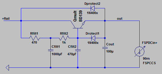

I have looked for parts in my boxes, I put on Spice based on those parts, maybe I will give it a go out of curiosity. 1.4V drop. What you think?
Hi Nick, did you get a chance to try that circuit?. It looks simple enough for me to try p2p build but i would have no idea if it is would be an improvement over CRCRC.
Quan
Tonight or tomorrow. But you could try yourself independently also, since there are subjective things to consider about the rail impedance changing too beyond surely more DC power line isolation. Me I haven't got any filter whatsoever already installed passive or active to compare anyway. So it will be just raw vs one BJT Cmult 2nd order based. Two of those, one for each channel's DCin of course. All capacitors >=50V.

Hi Nick , quick try with KM as pre-reg for FSP . Psychoacoustics effect but i do detect less noise with it in place and more enjoyable. I don't have 1000uf 50V thus use 680uF in C1 filter, C2 -cheap 470uf and output couple cap is 47uf/63V. Can i sub the output cap for 22uf film cap?
Quan
Quan

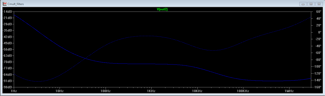

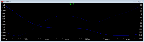

If you mean the one with single BD139 and three capacitors I posted, its not a KM, just a second order normal capacitance multiplier filter. What is the practical voltage drop across it? About 1.5V? Here is its theoretical PSRR with your now capacitor values. 22uF Cout does not spoil it enough. Should clean some rail incoming EMI noises better, why not. Are bass and dynamics still good?
