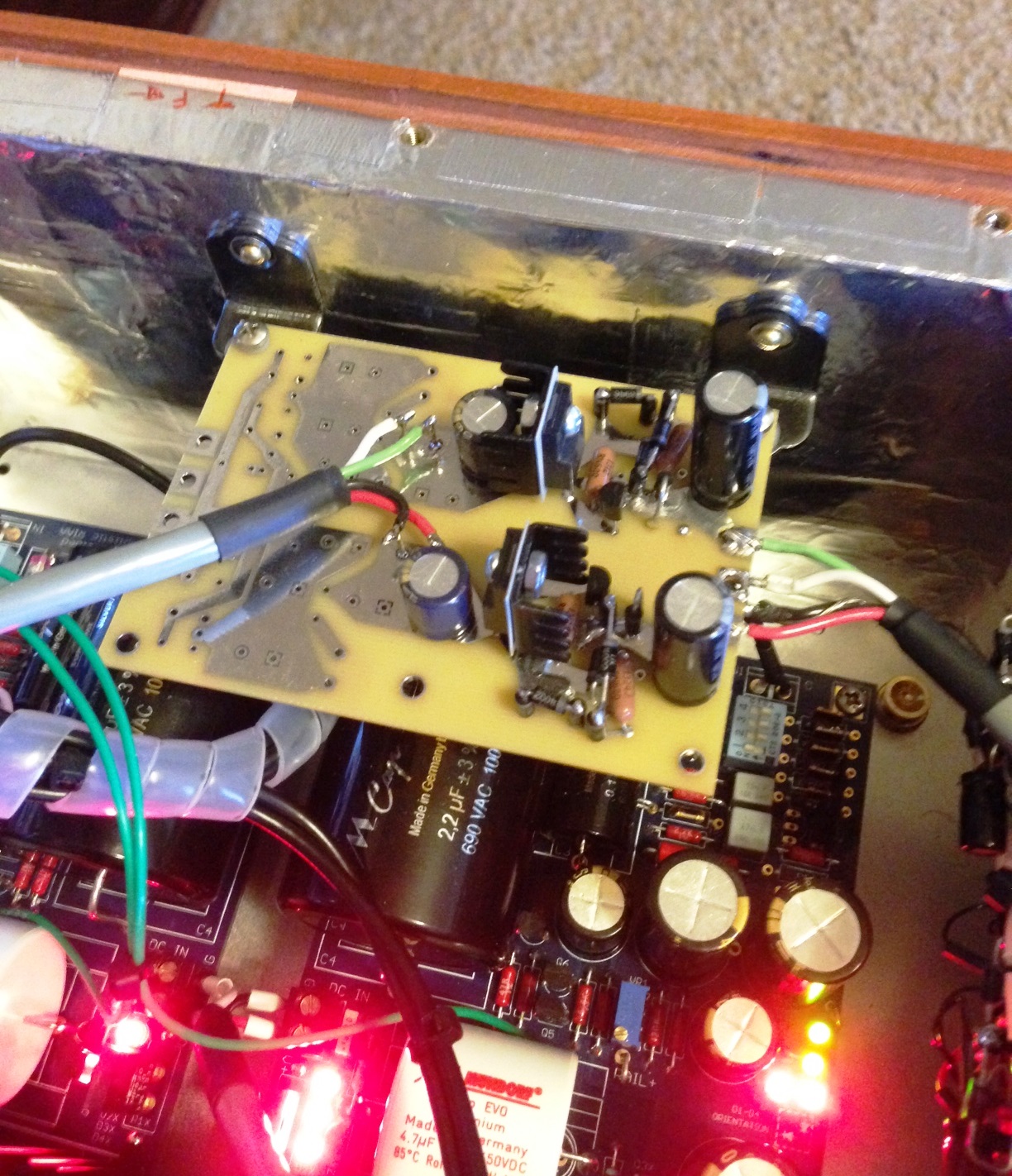

I'm listening LPs right now after I'm done with the necessary re-biasing due to KM integration. For the rest of our forum, I integrated Keantoken K-Muli (about 2V drop) into Phono box last week.
Amazing!!!
No any and I meant any previously present in high volume hum/noise/buzz or soever. Absolutely quite. Details are came upfront. Very reach sound. Phoele Snow is a life again and singing just in-front of me. I'll show your guys my final report with pictures and "emotions" soon.

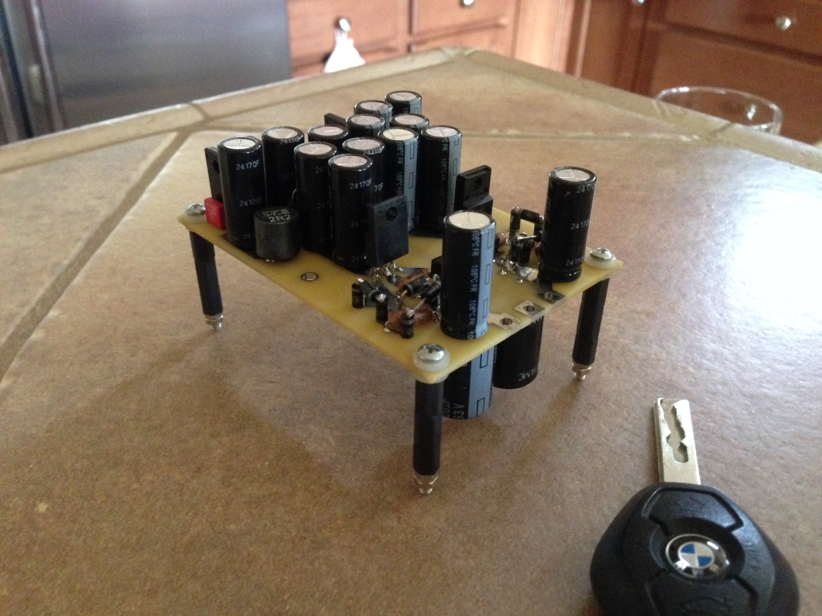

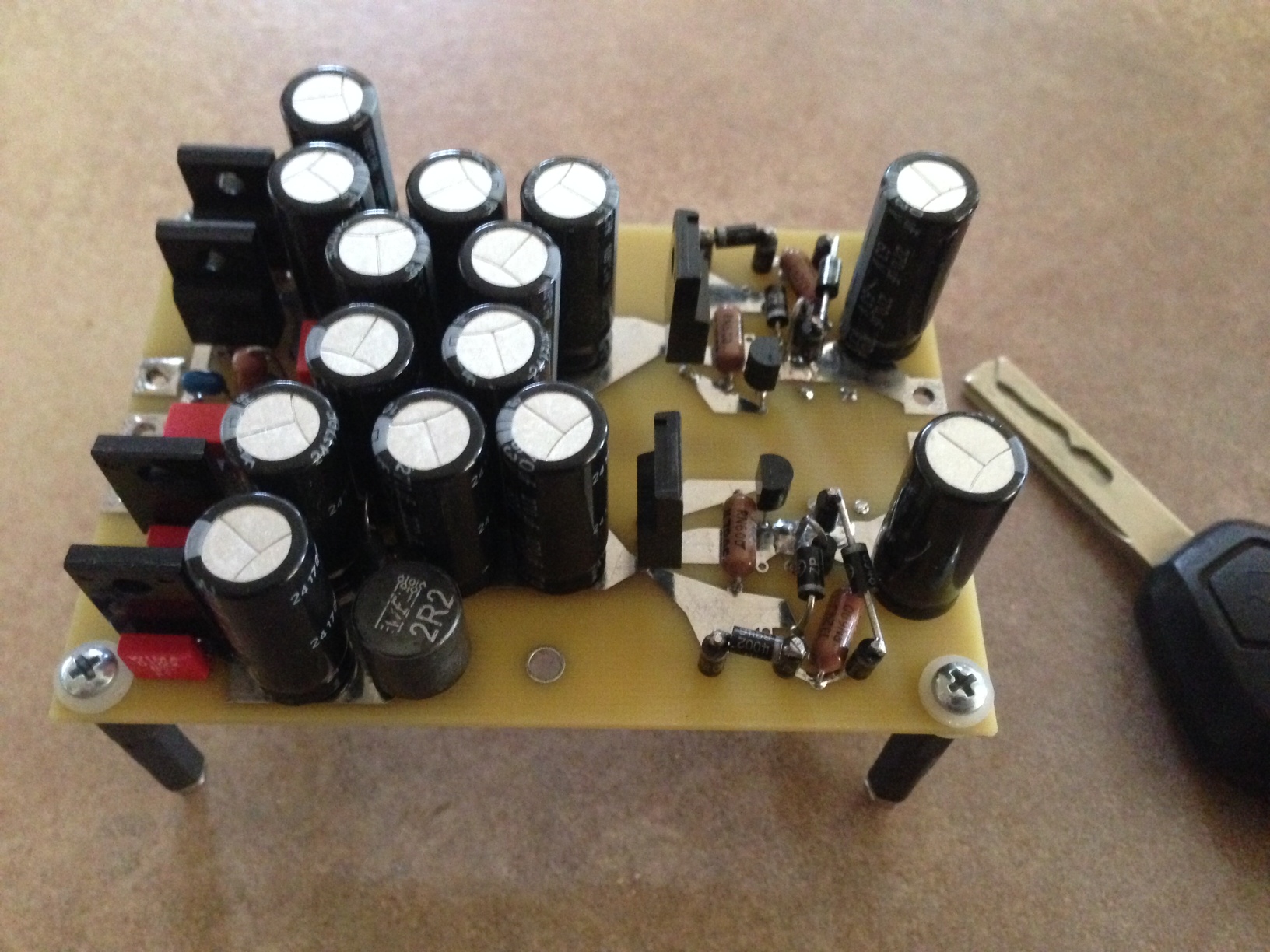

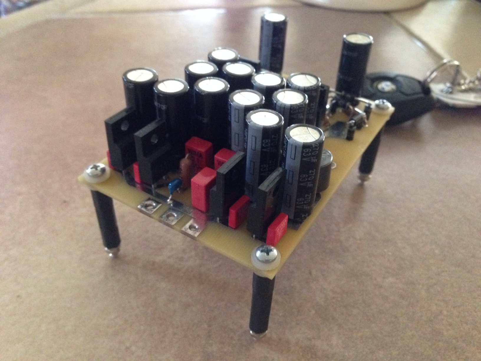

Here is my K-Multiplier pictures.
It is installed onto FSP box.
Quite crowd there, but I did not hear any interference.
As I mentioned, K-Multiplier cleaned all noise and it is very quite, clean and life-like sound now.

I did not built that board.
Keantoken did for R&D purposes to set his K-Multiplier for 50V and above. I got PCB from Bill (HiFiNutNut) and Kean came up with his latest circuit now found on his site under "Other adaptions of the Kmultiplier": The K Multiplier

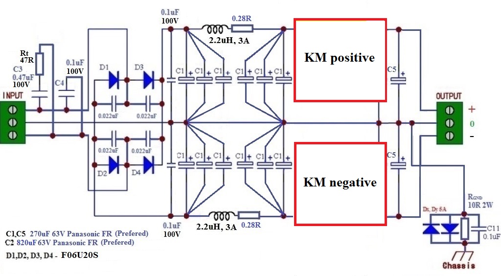

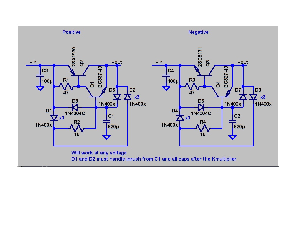

All components values are in attached schematics. I have placed 2 Positive K-Multy right prior Salas shunts in my FSP. Amazing results! K-Multys cleaned all my noises (mainly coming as V-ripples). Sound is crystal-clean with deep stage for all over audio frequency. I hear more details now and its life-like music.
I have one more unit made by same consent for up to 50V for positive and negative PSU. It based on Bill's example found here (post 569): http://www.diyaudio.com/forums/power-supplies/177516-keantokens-cfp-cap-multiplier-57.html
I attached picture and schematic to my post too.

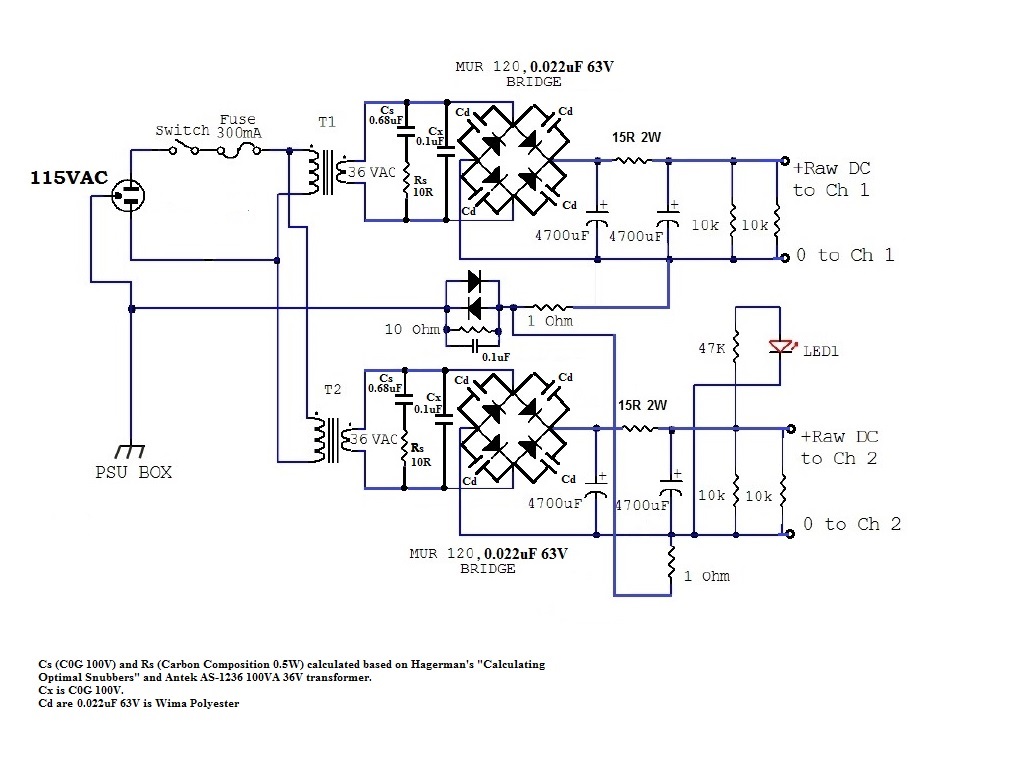

One more thing, we added Salas Raw PSU with Hagerman's calculated snubberring. Please see attached updated schema.

My case is unique and my noise is 100% power creation and/or power delivery related. It might be my diodes, or filter, or umbilical cord, or Lumberg Power connector pickups. I also have terrible "octopus" of power and signal cables behind my audio deck. I experimented with Hammond 300mA 68R choke and noise reduced dramatically. Then, I understood that my noise is PSU-born or umbilical cord delivery related, not FSP. Choke was nice but I lost about 10V due to power drop. In addition, that choke is artillery size projectile and 2 kilo at least.. I have no space in my PSU to integrate it. This is why I dropped that filter into FSP box and all that noise is gone....🙂.

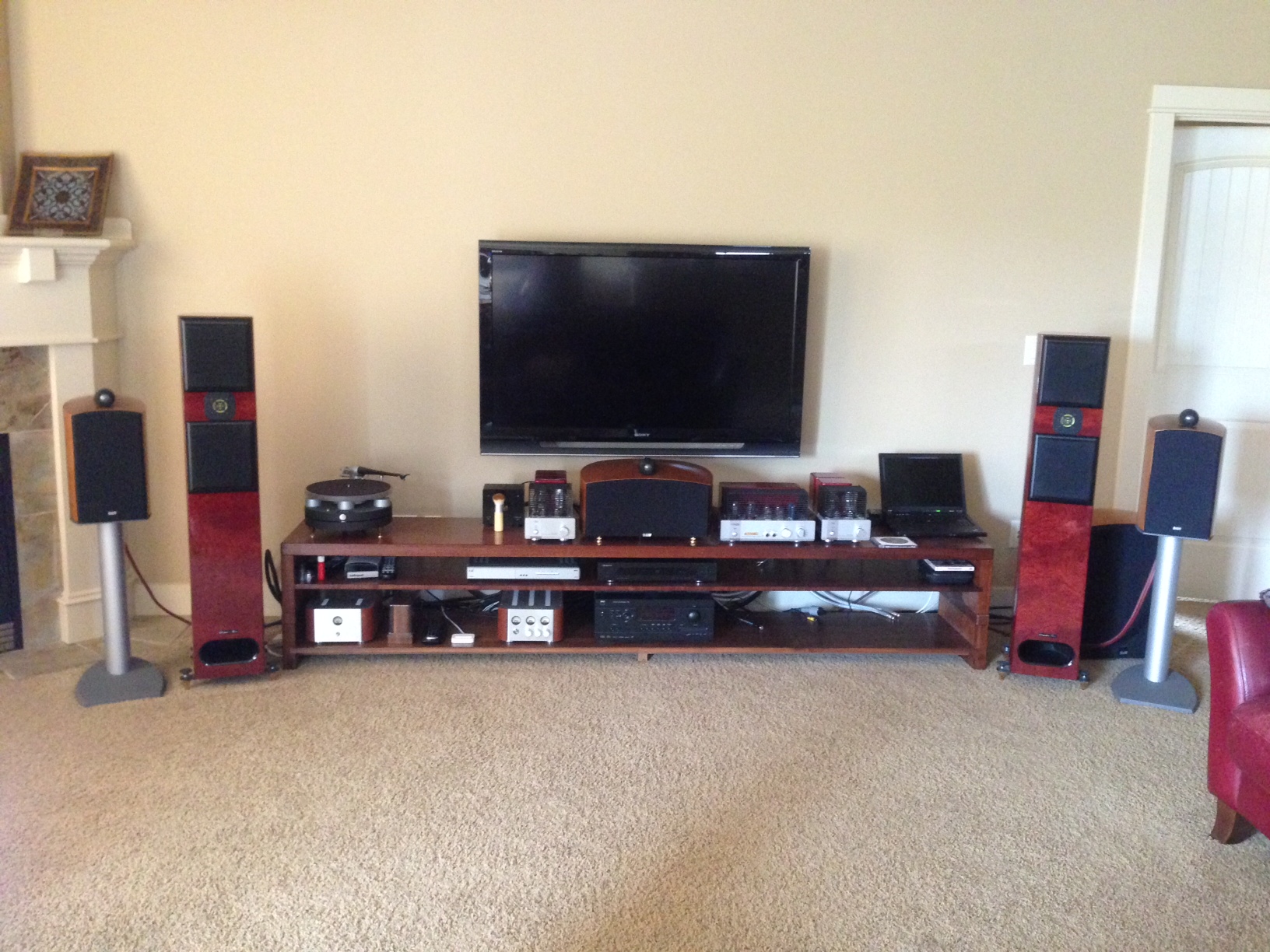

P.S. Hey, where is the gear family success picture with the finalized FSP build in its proud place near the TT, amps, and speakers?🙂

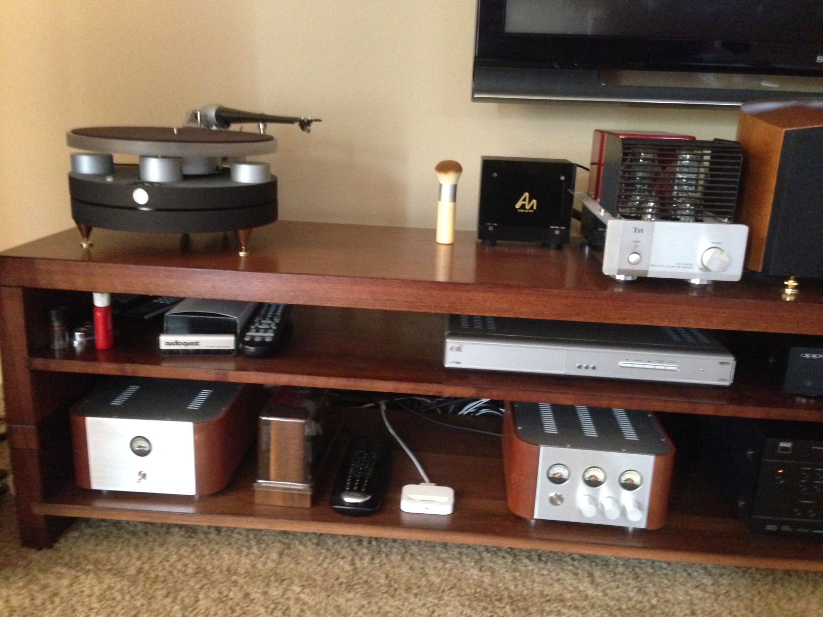

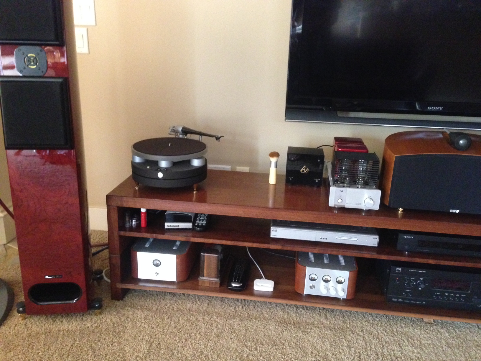

Here you go...🙂.
Nice arrangement Alex. Aesthetically pleasing. Arguably your FSP diy is the most handsome duet there. Enjoy your work. Happy listening for long long carefree time.
*(Much gear and a computer also on same power line etc. hmm probably more sensitive than average stereo installation indeed).
