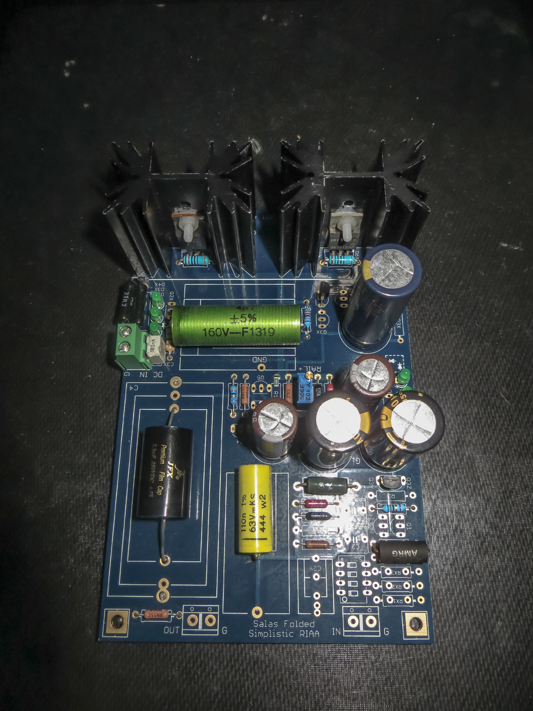

Here is a pic of my build so far. Still waiting for parts to arrive
I was in a dillema between tnpw and rhopoint miniohm for R14, and finally i decided to go the expensive way 🙂
Using different passive parts mix than others, it will be nice to know about your results when ready.
