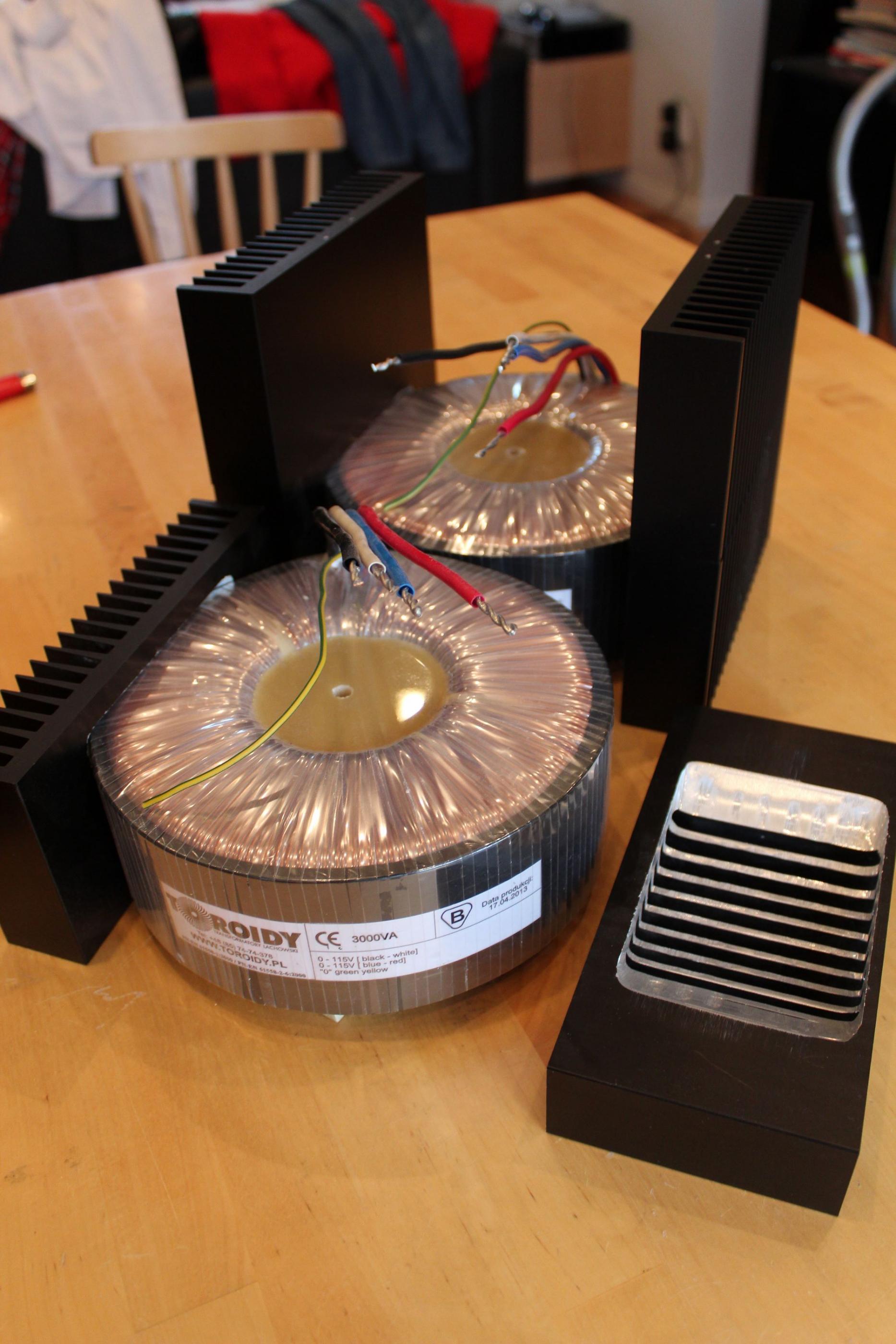

He, he, TSSA will look very nice with such toroid metal jacket.
Nah, I have them already and they are not metal, just semi-special.
