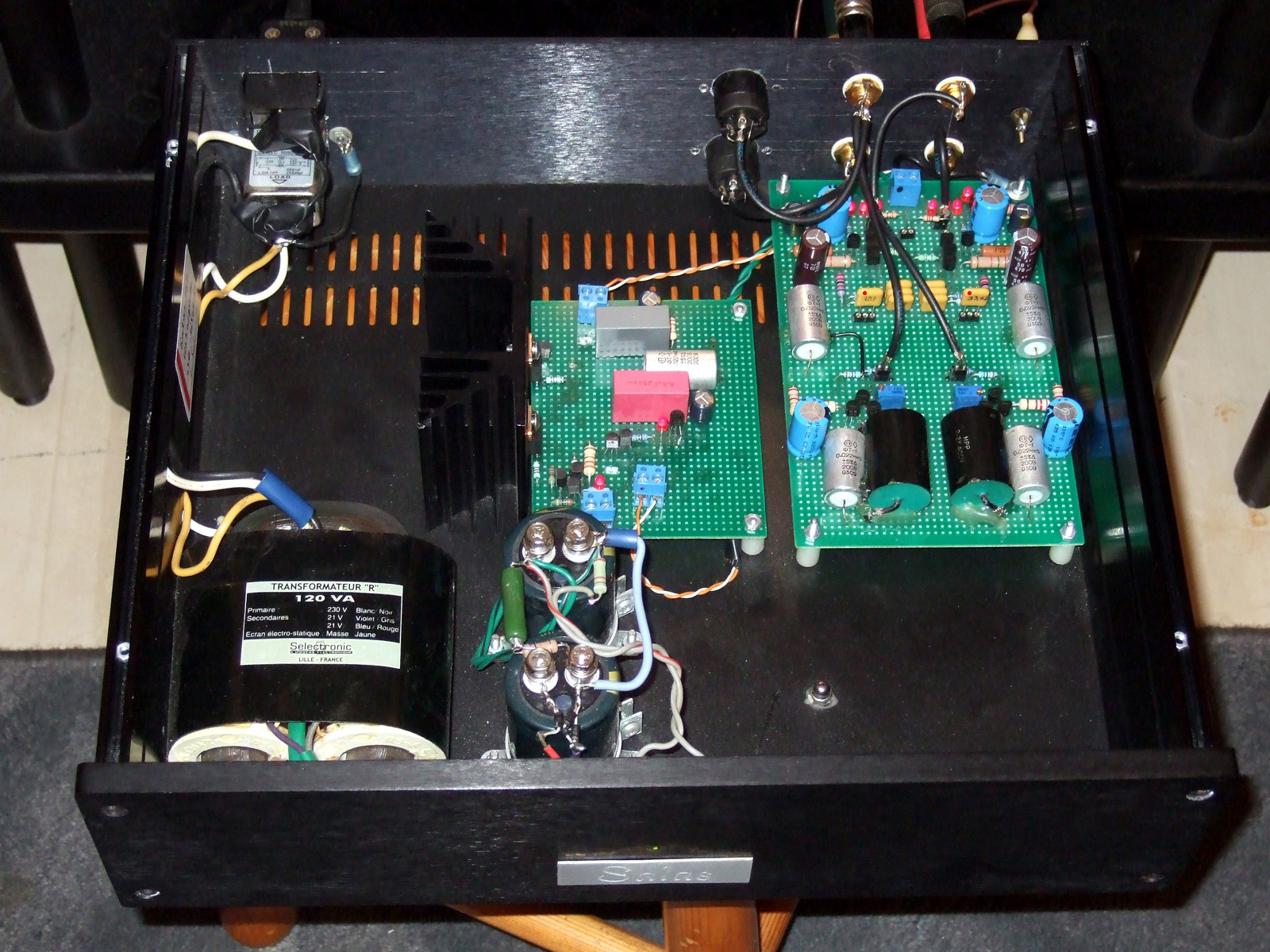

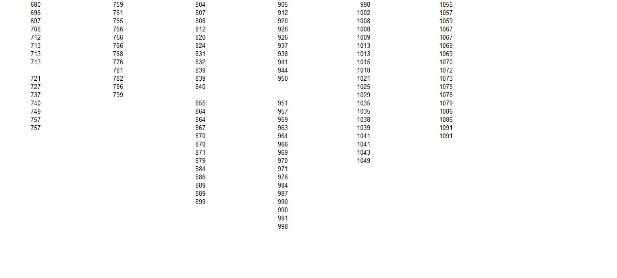

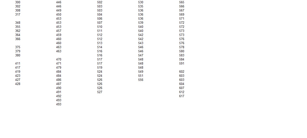

Matching done Phuu.. 225 in total
2SK170BL from from old stock (Mouser 16 ea) and 100ea from Schuro-Elektronik
2SK117GR from Simplistic GB and old stock (BIB GB)
measures quite good, pairs is no probl to make quads is not so easy, (its possible though)
results for 2SK170 to the left all batched in groups by 5%

Example:
In this one when using good idss matches with no other parameters noted, I got 63dB dead on for both channels with 48R and 48.5R Rs via trimmers on the K170 second stages. I.e. no significant compensation for same Rdrain voltage drop. This older p2p proto has 3 K369 and just 12 Ohm enR when cold or ~0.45nVSQrtHz of input noise. You can see a V1.2R regulator at 250mA also. When I averaged it for 131072 FFT it gave -105dBV at 20Hz noise floor. Plays for a VDH Colibri gold coils type on another system.

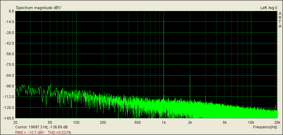

Hi Salas,
1. What is the approximate gain of the first stage (Q1, Q2, Q3)?
2. What is the expected voltage on Q3 collector (TP2, or Q3, R4, R14) when the voltage between TP1 and TP2 is set to 3.6 Volt?
3. Do you have SNR measurements, even approximate, or simulated, for the entire folded simplistic and possibly also for the first stage (Q1, Q2, Q3) in itself?
1. About 45dB in the 63dB highest sensitivity on the PCB version
2. 4-4.2V in respect to ground
3. I have overall FFT for the 63dB highest sensitivity on the PCB version that I had posted once before. Non weighed, non averaged 65536 FFT.
So, this one has all the audio band for you to correlate any portion.
