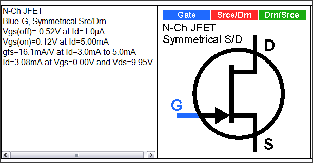

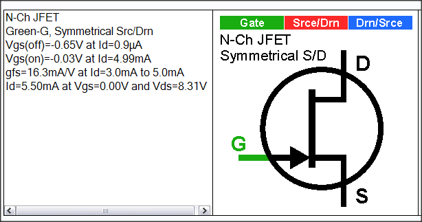

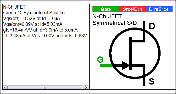

I just picked two K117GR from a bag with no near Idss and I don't see wild differences in gfs even when the Vds, Vgs (off) conditions differ enough. Having same Id bias test range keeps them near.

A 4.05mA IDSS and a 3.48mA IDSS one now. No problem expected especially when degeneration will be applied. The tolerances in our guide are strict because the K369s and K170s are much more gain prone.

Firstly let's use the correct term you reminded for IDSS picking, when matching is a popular misinforming term. Matching a parameter is not matching devices. IDSS selection it is the proper term then.
In this circuit the IDSS selection is central because its an influential factor in determining the bias current. On those drops the bias current creates on assorted resistive elements we rely centering the input stage especially for proper symmetry and headroom. Also importantly it determines the mW on the JFETs to keep their Tc drifting alike. Even in this low noise stage, the degeneration is 20% on its lightest (LMC) to 80% on its heaviest (MM).
In the second stage the degeneration is 42% across all settings. Keeps the gain multiplier in check.
After testing many alike builds and carefully monitoring the prototype PCB build for what IDSS JFETs went in and putting them through curve tracing first, I have seen that even with bit different gfs samples when IDSS selected to the tolerances given in the guide, it will be difficult to go amiss by more than 0.3dB final channel matching on highest sensitivity setting.
Just because few builders will have tracers or will go into full characterization lengths of JFETs with expert confidence, I had determined that the IDSS selection is practical enough. Even when so, I mentioned FFT testing and R8 trimming for the geared up and experienced lot.
