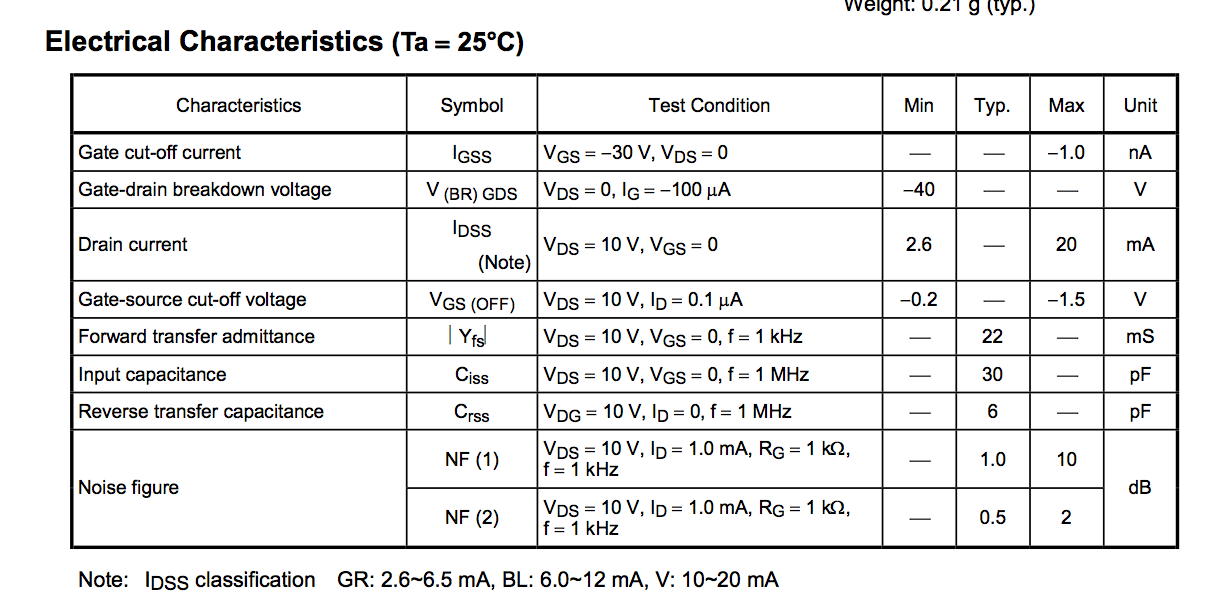

All charts I have seen about various capacitance types in semiconductors datasheets are versus voltage. Haven't seen VS frequency. Maybe experts know something else.

Where did you get the 30pF figure from ?
So this should be average value for input capacitance of k170 cascoded second stage ?

No, this is only indicative IMO. The K170 Vds under the BF245C or J310 was 2.7-3V in breadboard test. That gets you to 35pF Ciss. Crss goes to 10pF at that Vds. If it was without cascoding it could be around 230pF Miller effect with the gain and Rs used. I hope for 4 to 5 times reduction with JFET cascoding in this non perfect world, and it remains to be measured. With a BJT and higher Vds like in first stage it can go closer to elimination and nearer to just Ciss.
