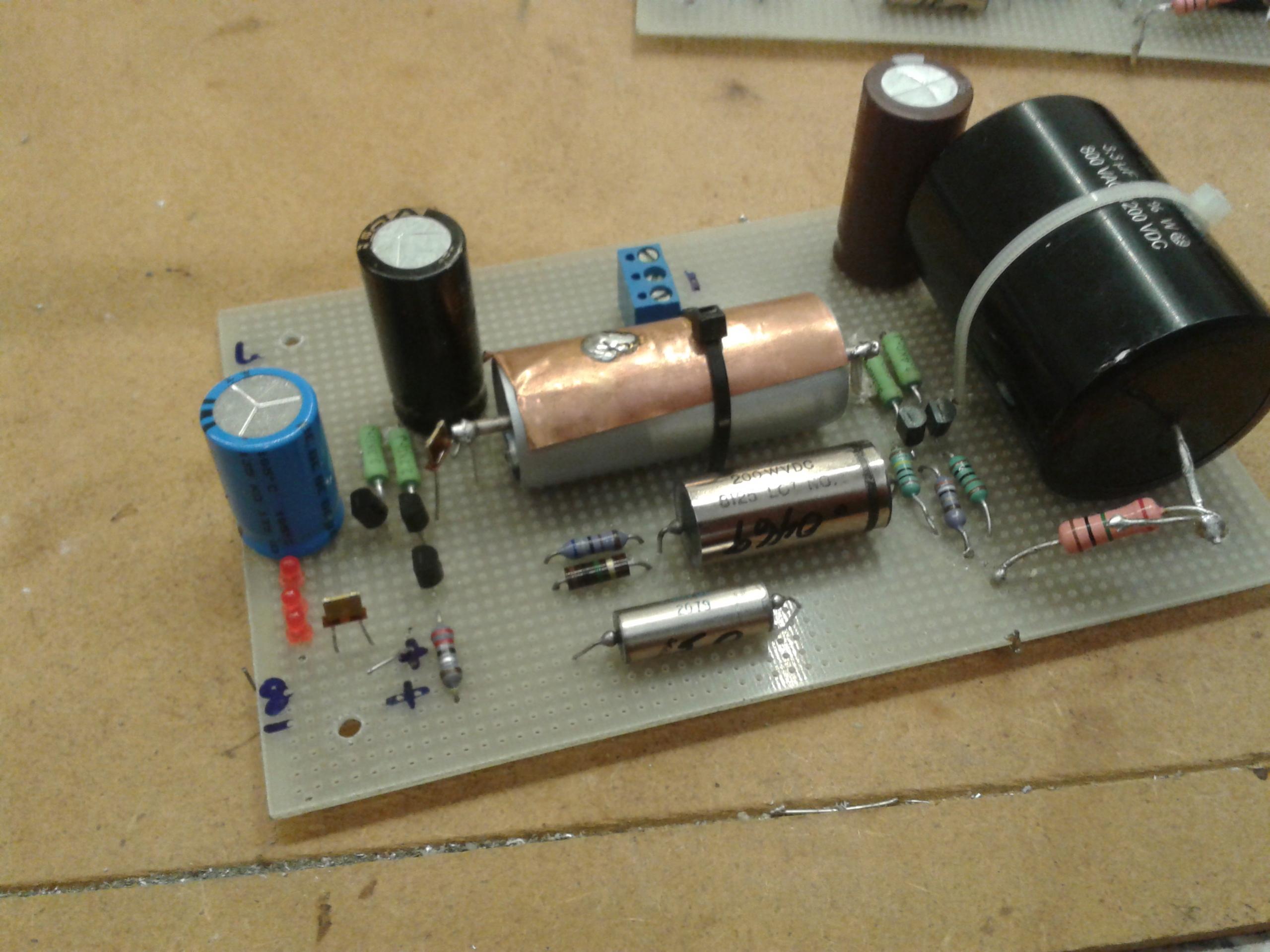

Could be with big caps. We should tap them when connected on the scope alone. Because if we tap them phono connected, maybe other stuff rings on the high gain board too.
In my initial Benz riaa build that used a british hand made pcb, I could hear noises just by tapping the ft3 coupling caps, the decoupling EL caps or the output caps.
Now my p2p builds are much sturdier and I glue the caps to the board so no microphony at all.
I do not think Mundorfs are more microphonic than any other caps.

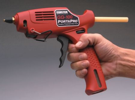

...Or the messy hot snot gun liberated.:D

The real value is 47k. I had 47,1k takman metal film and now 46,93. You think this difference might have an influence? Especially on definition.
Also Rload was 180R shinkoh.
Yes.... lowering the 47k that much influences sound in the way you describe. (Slightly tighter bass with much more snap) (and an overall increase in output)
Remenber this is the "bass resistor".
If you rise the value above 47k you get a bump with an apex at 40Hz and will feel more bass and less snap. (and an overall decrease in the output)
if you have measured all your actual riaa parts, I can run a simulation for you.
