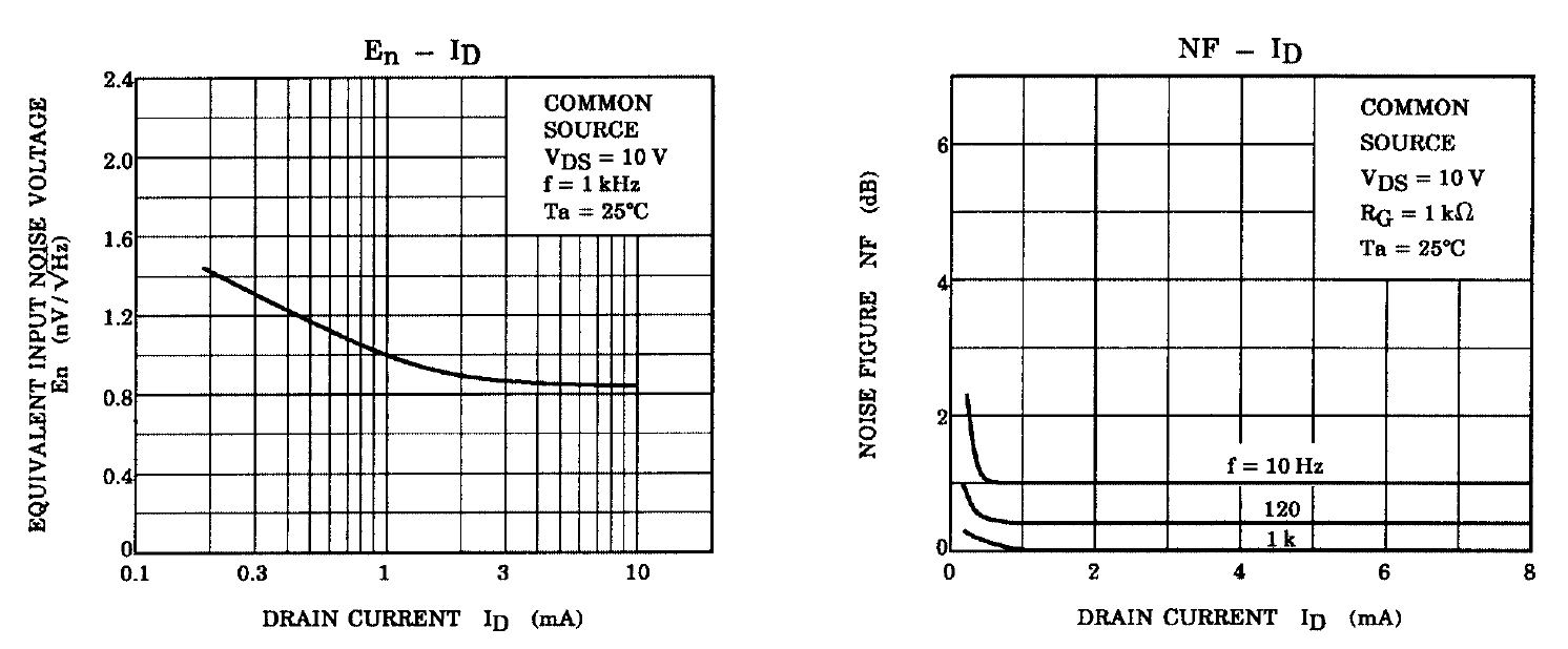

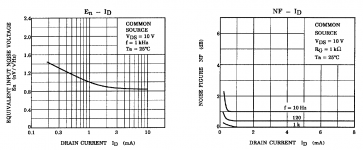

I am now preparing myself to build the V12R shunts for the cascoded simplistic.
As I will need 35V, and using 56kr for R11 (The voltage setting resistor in the V12R) I will need to set the k170 uder it to produce around 0.34mA.
But I have been looking at the 2SK170 datasheet and it seems that working at such a lo current the jfet might produce audible noise.
Reducing R11 to 30k the current goes up to 1.15mA and that improves the noise fugure but I know that reducing R11 also produces more Zo at very low frequencies...
I would really apreciate your comments regarding my assumptions.

Look to the right hand diagram, Rg (trimmer) is on your side. You can use 27K Vref there even. Increasing the ref filtering cap is the main weapon against 1/f noise in general but with the quality components I see in your pic above it can be costly. Luckily rumble filtering response shape suppresses subsonic 1/f also.
