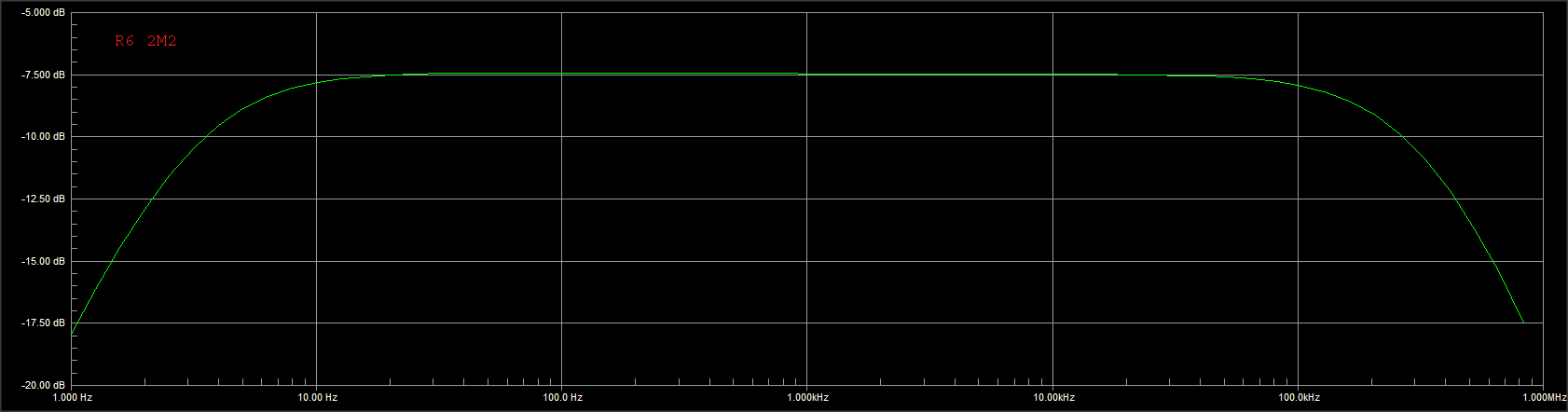

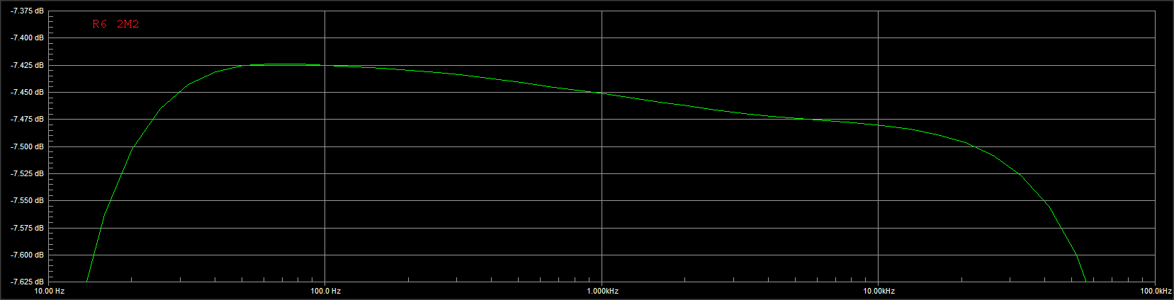

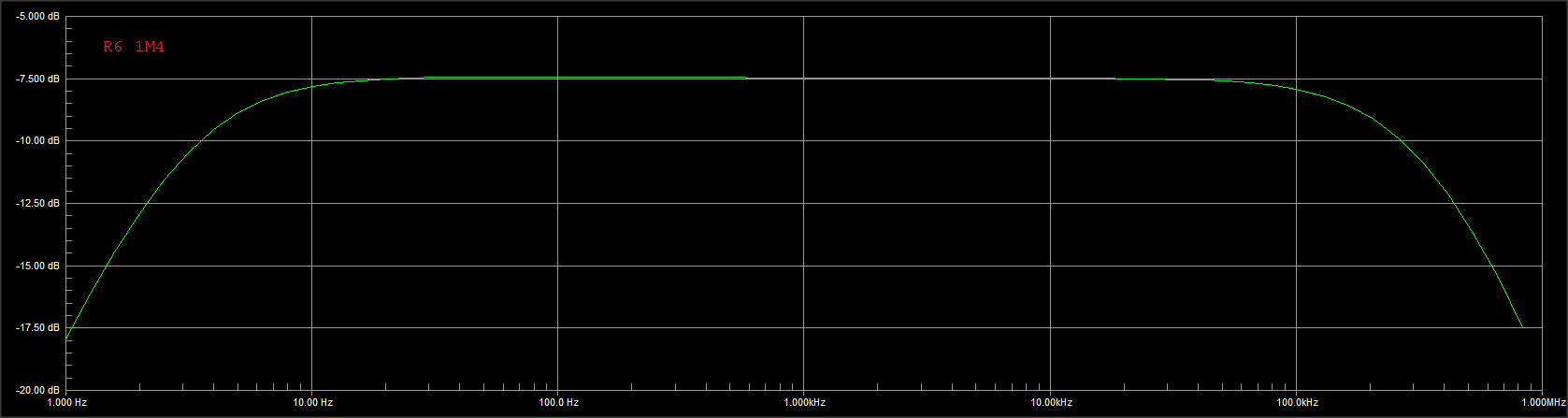

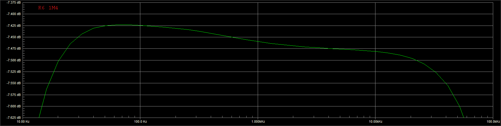

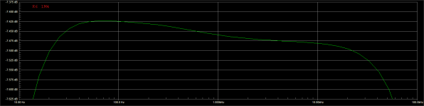

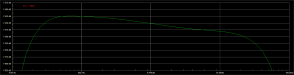

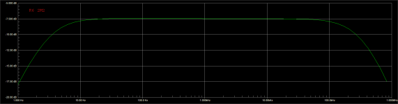

My sim shows an almost perfect fit... I would only use 6k8 // 1M4 instead of 6k8 // 2M2.
The output impedance of the cascode beeing ~ 2k2, it adds to the 47k in the riaa... very good.
Very slim reactions, see graphs.

The scale is so much zoomed in that with real parts tolerances I am not sure that we will ever be able to emulate those curves, the idea was to initially have a very faint droop as we progress in higher frequencies. Still if the modded gain blocks will work to satisfaction, those curves will possibly need to be more heavily voiced to subjective synergy or left alone. Till then, some road. But its a non problematic starting point, not too deviant IMHO. What do you think?

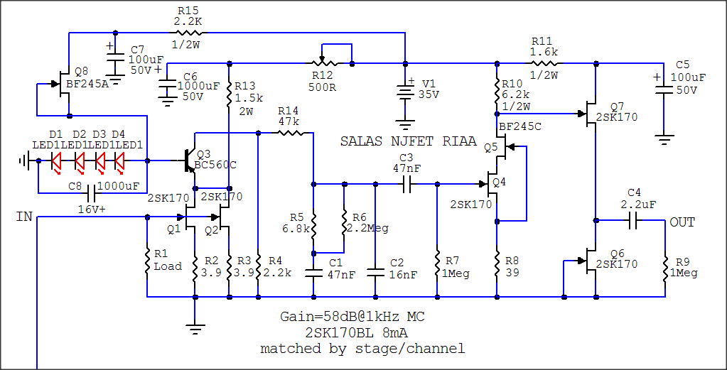

Hi Salas
For Q8, can I use a BF245C instead of a BF245 A ?
It sets the current in the leds that provide bias for Q3 (folded cascode trannie).. do you believe higher current might modify bias too much or is it about noise ?
In alternative, I can use a suitable 6mA K170 right ?
diyAudio Chief Moderator
Joined 2002
You may either put a resistor between G&S BF245C pins with a value that will get it down to circa 5mA (try 470R) and take current output from G pin, or use 2N5457 3-5mA natural. My BF245A little stash averages at 3.5mA for instance. They are both low capacitance higher RDS ON JFETs but suitably quiet also that will meet the 4 Leds impedance better for minimal harmonic noise pick up of CCSed Leds Vref in that cascode transistor's base bias system. Not a big deal but prefer them to K170 for the job if able.
