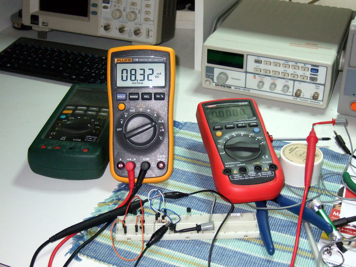

Guys when you are going to measure those for IDSS take caution. In case they will be genuine their high Yfs and capacitance can set them off and trick out the measurement setup. I have a few in my stash from years ago which have the right looks, bought in Japan. Have used them before in circuits. I was fiddling with them again to sort out a quad for the new experiment we are up to. Rat hint was when I saw 10-20% play between DMMs in series mA mode for same sample. I decided to investigate. First I looked if it was about burden voltage due to differences in the internal shunt resistor of the DMMs when in mA mode. One has 2.5R other has 5R and another 10R. So I thought it may be influential with those JFETs initially. But it was not that. I set up a 3.3K dummy at 10V PSU and put them in series. All three DMMs were spot on 3mA and very close between them in the last digits. Then I used a 10 Ohm in series with the JFET, set the DMMs in mV parallel mode to see what happens when using the voltage drop method that gets them out of the way. Worse! up to -20/+40% incompatible readings. But I spotted something. The worse the deviation, the more the PSU was indicating a few hundred mV change on its original 10V setting. That's it, oscillation due to all this cabling and DMM internals. Only one DMM would not bother in series mode, but it would bother the most in parallel mode. Parallel Rdrop method indicating in mV was the jumpier anyway. So take caution, make the breadboarding tight and have a DMM in voltage mode parallel to the PSU or battery. Watch that the power source does not jump its voltage reading in the hundreds of mV when you close circuit measuring IDSS. It did go tricky with battery too by the way. Now it may be my cables and set-up or not, but watch out for it creeping in because the parts are going to bias differently in circuit then and they may shut down the input stage for amplifying even, since the current is allocated after a resistor CCS to a certain share between branches. Those parts are not useful for many other uses and are quirky so don't invest in any number than a few, especially in the face of getting the fakes risk. If genuine they bunch well so not many drop outs anyway. What you see in the pic is a 10mA one when all things calm but misbehaving at that shot setting. I tried on K170BL all the above methods, no problems. So the 369s are quirkier is the difference.

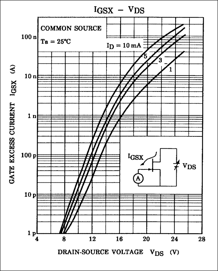

No its not much better per se in cascode. Its just tamer for Vgs. In the cascode the upper Jfet's noise won't directly correlate with the lower Jfet's that sets that performance. 245 15mA and 170 8mA did a clean swing of 12Vpp in a test I run with less B+,Rs, and RL than the projected 2nd stage values. It will likely be a bit more in the phono. So its enough. You can use J310 anytime too, logically. Although I did not run that exactly in the same way yet. I did in cascode CCS full Idss mode. There I saw its happier for Vgs naturally due to its high Idss characteristic of course. There is a Toshiba chart showing the Igsx VS Vds & Id leakage thing for K170. Interpretation depends on what is considered high regarding the input signal level and how high is Rg (few mV & 1Meg in our case). All Id levels follow the trend non the less (our 2nd stage is at about 4mA Id). Should be more at higher than 25C also.
