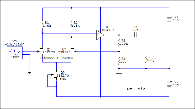

Microphones are very different in out level and impedance, but generally have about 100Ohm source impedance upwards, usually around 200 Ohms. Because level and sound pressure changes the gain needed varies from 50-60db to -say- 20-30db. Real life dynamics exceed the dynamics we know from music productions by far, so the headroom should be very high or the distortion characteristics smooth.
Usually mic preamps have either differential amps as inputs or transformers, also because they are usually balanced.
diyAudio Chief Moderator
Joined 2002

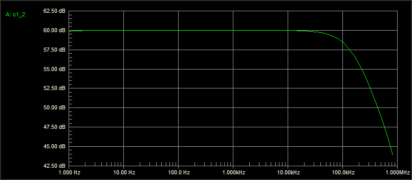

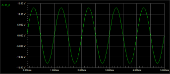

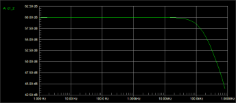

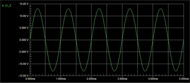

The simplest I could think of is a Jfet dif amp input handing over to a Jfet input opamp. It can swing 26Vpp this one. Its 60dB gain can be padded down by switching resistors parallel to R3 or by shunting a pot. G=(R3/R4)+1. Balanced Mic transformer coupling offers the best CMRR and sound anyway so its preferable if in hand to keep the electronics SE and minimal. Jfet cascoding, other worthwhile Jfet types, easily applicable. Housekeeping like opamp decoupling, sizing C1 to likely impedance it will meet, PSU etc. goes without saying.
Thank you , Salas.
But topologies like this have been done many times, sometimes with cascoding, and other variations.
What I meant - and maybe it was a bit naive - was, if it may be possible to use your circuit as a micpre. I like the simplicity and the possible "sound".

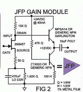

Of course with a unbalanced input cables must be quite short and only unbalanced or non-active microphones can be used. But there are ribbon microphones, which usually have a step-up transformer built in, and some other very quiet dynamic microphones, which could possibly benefit. And for balancing I can use a transformer anyway.
I use another simple mic-pre in an experimental state right now, and was wondering if your circuit may not be better.
It uses two of these stages in series and a transformer in front.

I see what you are after, but if you will choose this non feedback gain controlled approach you should settle for about 40dB middle of the way gain because the bias points would need some determined swing headroom, and it will not be that easy to change parameters on the fly. Maybe a 1:10 mic trafo and a 30dB output voltage divider switchable pad can make it more versatile. Will check out and give you a flat gain one based on the simplistic. Any simplistic is +20dB on nominal without the passive RIAA loss so it takes some recalculation.
