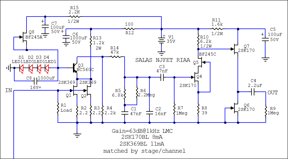

Congrats Salas, looks promising: low voltage +35V powered, without cap between input FETs & ground. I only need to know where to get the 2SK369BL, the BF245A & the BF245C.
Its an experiment I don't recommend it before I test it. Certainly fits best to low MC carts. There can be Jxxx subs for the European BF although noisier, but BF are everywhere. K369 give benefits in the 1/F region and for wide-band 2 are like using 4 K170s. But it can be tried with same IDSS K170s too. Q5 can be used or not to taste. Without Q5, C2 should be 15nF due to more Miller.

Tanks Salas
I will go for 4 170 to try this out as soon as I got "litle" balanced phono finished
I take that Reflector is adequate
You can't play with front end's total current, the folded cascode will shut off if you will change the relation. Let me see about quad K170s. What cart you use remind me, and what kind of K170 IDSS you got plenty?

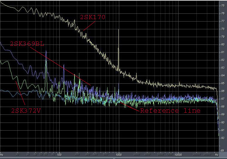

Found some 2SK369 on ebay. Do you think they are fakes?
Not as sought after as K170 bcs rarely specified they may stand a chance of being good. I would score the fewest to check out. If they are good they show a benefit in 1/F region. You can see on a chart that Scott Wurcer presented in 2010 when Patrick (EUVL) sent him some rare JFETs to shoot out. But they will not show the Vgs high enough for more than 0.5mV MC when considering low degeneration to keep the noise spec. Especially in folded cascode the swing can be the difference between VDS and VRload to ground only. Best is they are used for true low MC (DL103 or less) for good headroom.

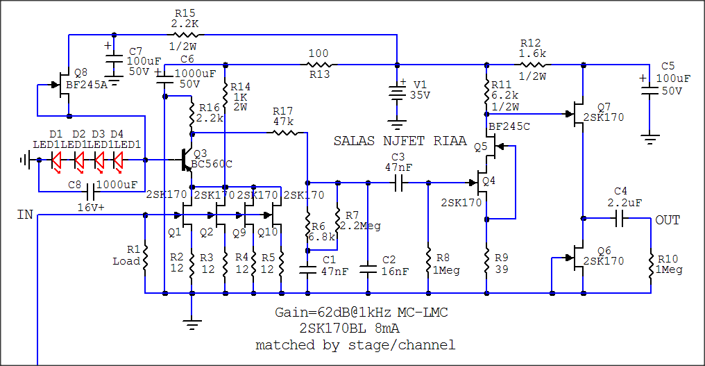

Ok, here it is for classic 4XK170BL. You may relax the matching for the quads since they are degenerated enough to share current at ~0.75*IDSS and the total transconductance (~130mS) will be steady for 7.5-9mA samples at shared ID. But make sure that the sum total of the quads IDSS between channels is nearly the same. So the folded cascodes will be sparing the same drive current to R16 and same gain. No loop feedback here to match the gain if not thorough with JFETs picking in both stages. It should present ~15 Ohm input equivalent noise resistance, not bad. And some better input headroom, adequate for normal MC also. Pick a ~5mA BF245A for Q8 and circa 15mA BF245C for Q5.

I got same 2SK369 on their way hopefully they be the real thing and build as on post 7881
This new version has one less gain stage from the one I am using as I have the Low MC pre-pre I have enclosed the PDF it is based on here for reference.
So that is 4 Phono stages on my bench
Those new experiments have the gain due to folded cascode and higher total Yfs, skip pre-pre and one coupling for LMC, promise better input stage rail insulation because they refer their load resistor to ground, but they will not do HiMC, MM, they will not be modular, and it remains we like the twists. In case not, they can be readily reformed, no worries.
As load resistor is refered to GND, this means current flows inversely in Q3.
Output impedance of first stage is 2k2r right ?
